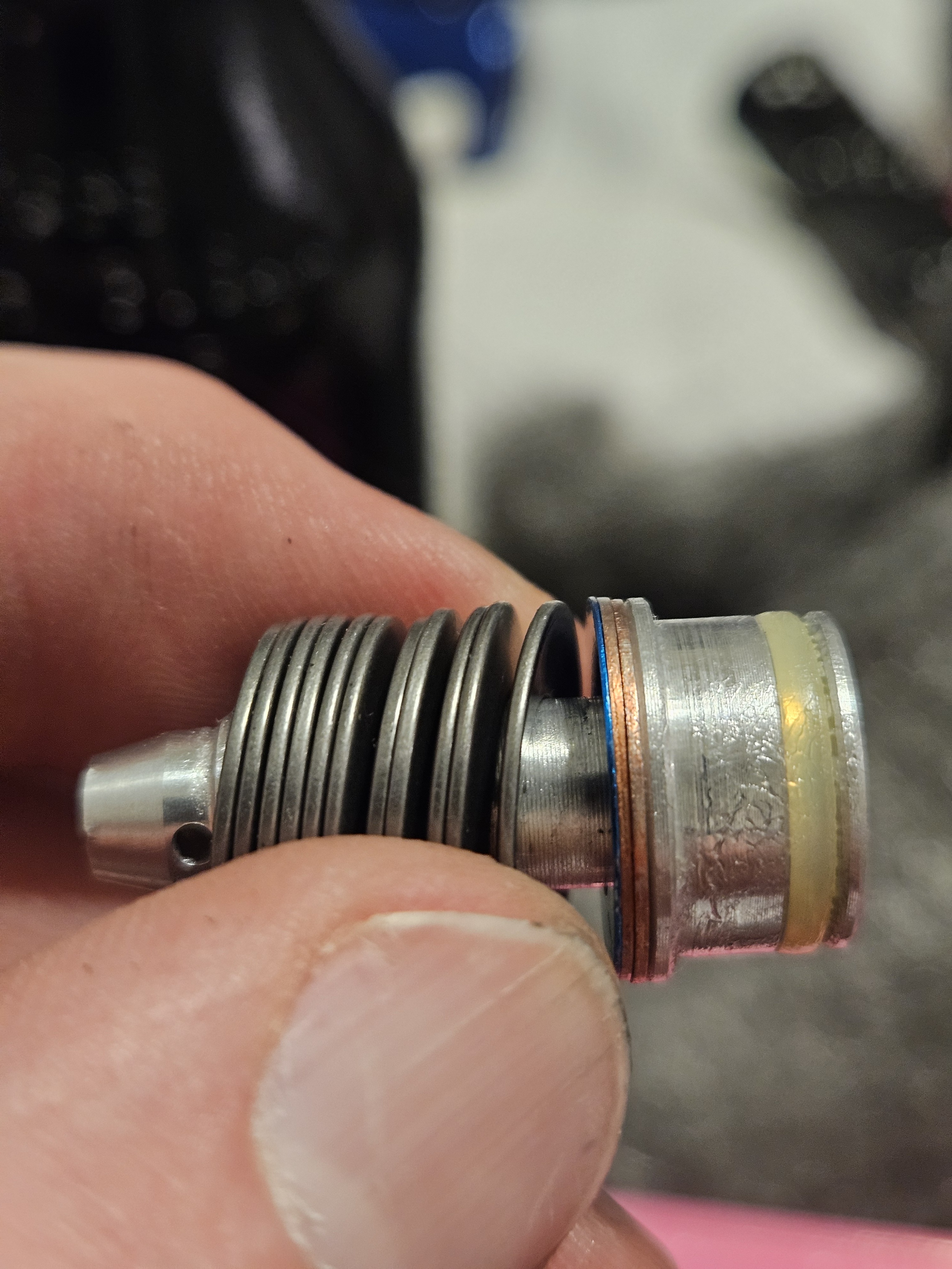

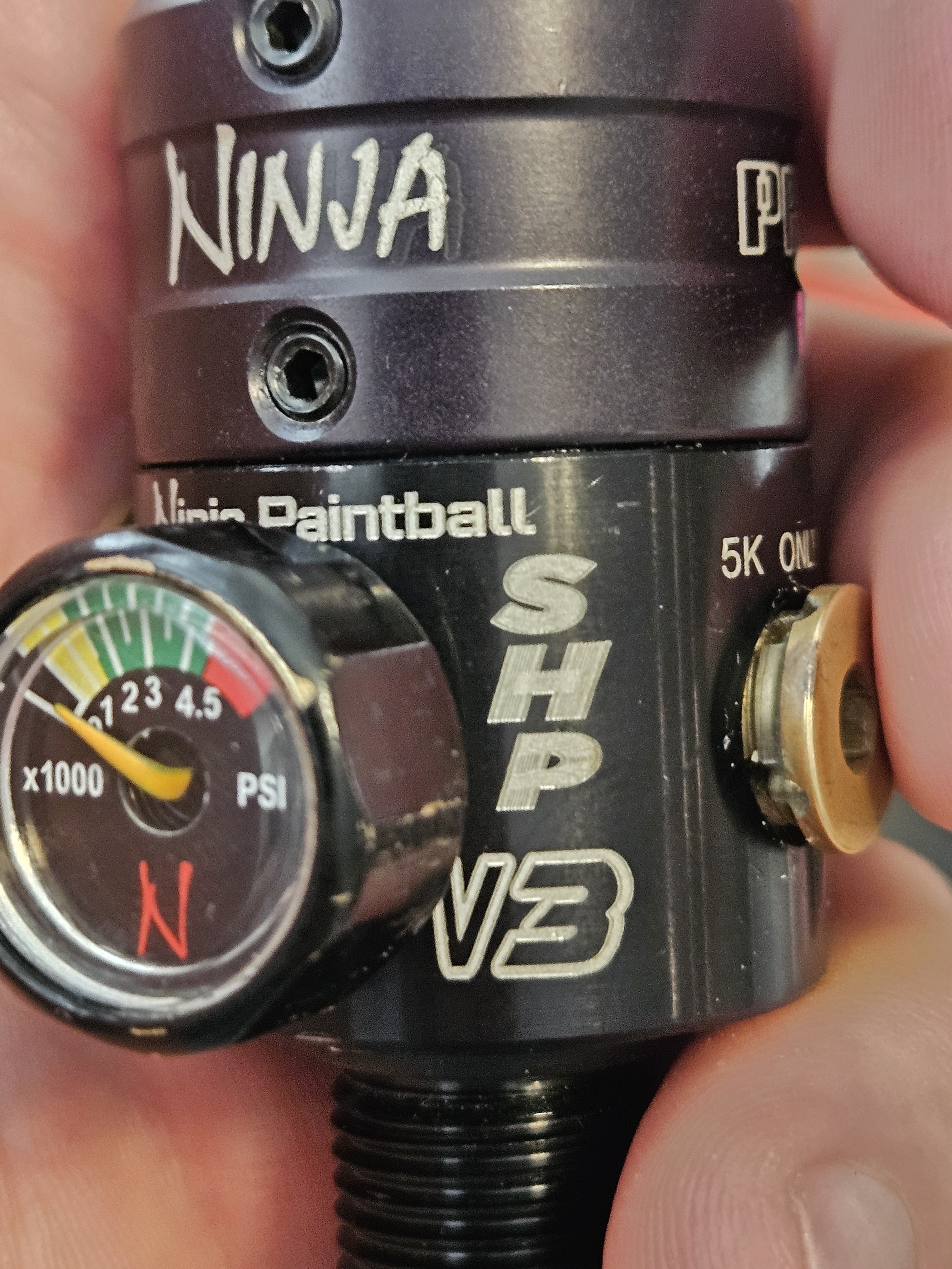

    Trying to find a main spring for my regulator. Bought a little bottle with this regulator from someone on here or the Facebook group and found this stack of washers inside instead of a spring... and it's only putting out 185 psi and I need more.

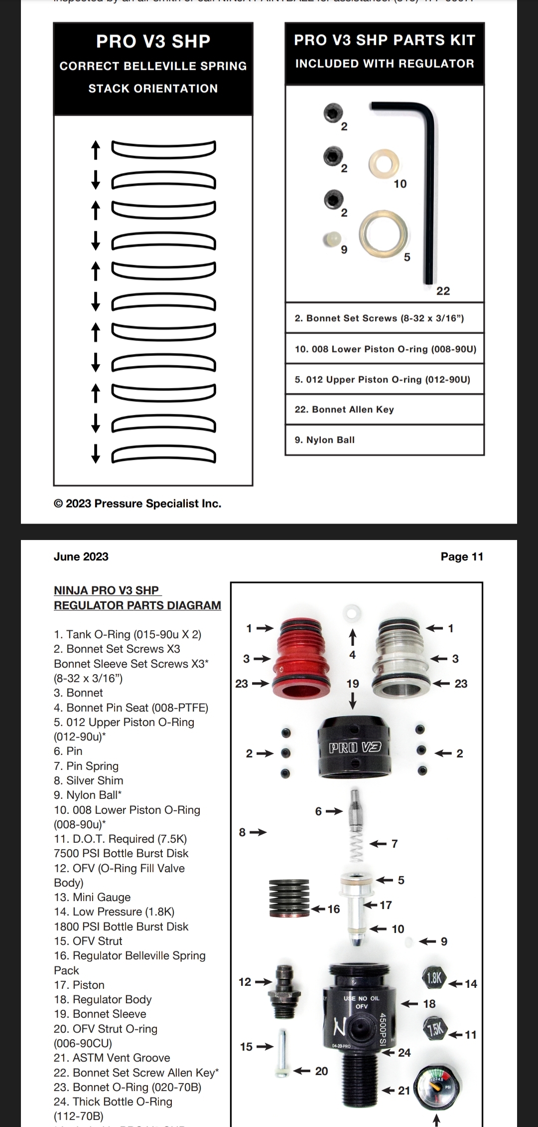

    The v3 SHP uses a Belleville stack, not a spring. The stack could be in an incorrect order.
      • 2801
      Or missing too many shims

        • 6276
        Those are definitely stacked wrong for high pressure. The washers at the bottom give minor adjustments while the Belleville Springs make larger adjustments.
        Looks like you have all the belleville springs just put them on in the right direction and it will put your reg output back to standard SHP reg output.

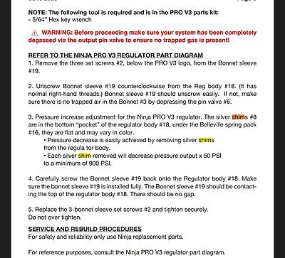

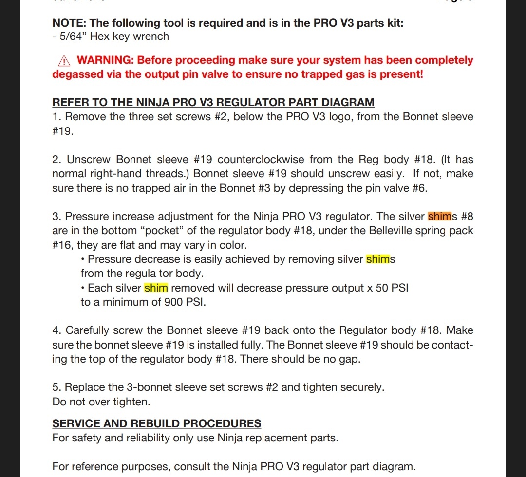

        Ninja SHP Pro V3 regulator output is factory preset to 1050 PSI (ish +\-) each shim washer drops output by roughly 50 PSI all of them removed is like 900psi ish.
