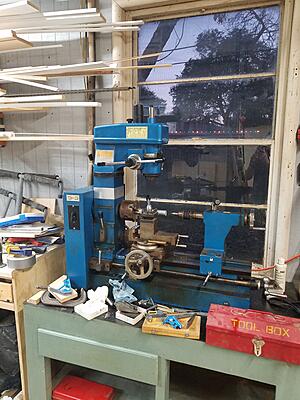

        Well, I measured twice... and a 9x20 is about all I have space for. Then this popped up on Craigslist with some tools, way under budget.
        It's gonna have a lot of limitations, especially as a mill, but for the occasional prototype, I'm pretty excited to have some capabilities at the house.

          Congrats 🎉
          let us know how it works (I always been interested in those 2 in 1).

            I can tell you already, the mil has rigidity issues (in my ten minute experiment, I can't tell if it was the cross slide or the head), but it's miles better than my Dremel Drill Press!
            XEMON commented
            That's disappointing ... It's such a long way, it might be tough to get any rigidity back ...
            Keep the Dremel handy!
            Sometimes it's faster and easier to grad the Dremel and do it by hand than setting up the machine ...
              -Generally I tend to pretty strongly recommend against the "three in one" machines, as they don't any one of the three well.
              But, I do also understand budget and availability issues, and I'm not so old I can't remember a time when I'd have killed and helped hide the body for ANY mill or lathe. Any lathe, after all, is generally better than no lathe.
              -The above said, if you have a choice, skip the 'combination' machines. They're very much a compromise, and have a lot of issues. I tend to recommend that, if you have any option at all, to get dedicated machines- a 9x20 and a mini-mill, as separate machines, are far more capable.

                Yeah, can confirm... the mill vise makes for a pretty poor compound, as it takes up a couple inches of swing (that I, fortunately, will almost never need), and the envelope for the mil is tiny. But - I'm already figuring out how it offers a couple unique benefits, like how if I put a drill chuck in the lathe chuck, I have a very accurate way to position a longitudinal hole that would be very tricky to fixture with a traditional mill-drill.
                And it fit in the last 4 feet of wall space in my garage (that toolbox needed to go anyways), and I've spent a fair bit on drills, taps, and cutters without breaking the $1000 mark. I've actually spent more on a paintball gun than on this lathe.
                A Bantam mill is probably in the future, and at that point I'll talk myself into selling off the table saw or buying a storage shed to make room for a better lathe, too. But I learned to drive in a Taurus, not a 4Runner, and it made it a bit less painful when I made mistakes.

                  I’m looking for my first lathe right now and curious on your experience with this one. How has it worked out so far?
                  • flyweightnate
                    • 1853
                    • Dallas, TX
                    It's OK - miles better than no lathe, and the price was right. I will be getting a separate mill eventually, as this one is very, very limited.
                    An 8x20 would be a better machine, but buying used, it's all about availability.
                    At the end of the day, it cuts well enough, and cost less than a months groceries, so I'm pretty happy with it. I just use it to try stuff out before sending the files to a third party for CNC work.
