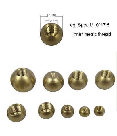

      I was thinking of something like this but, larger and probably not brass...on a stick with a tennis ball cover.I

        That’s cool! I like the stock idea the brass ball on the back might actually balance out well.

              Yeah something like that would be perfect! I may have to hit up Napa or Autozone tomorrow and see what they have for a cheapo basic, round shifter knob... ill update the post when i find something.
