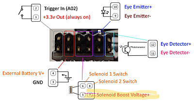

      Euphie, the board will run the Shocker if you disconnect pins 5&7 from the solenoids and connect those directly to your battery positive. This will source the current from the battery and sink the current through the board.

      It was the coil, just as I had suspected. I found a much beefier component that luckily fits in the available space and have been shipping with those ever since. The mk3 should have no trouble running Shoeboxes now, as this video will attest, I'm sure you've already seen it though, and thanks so much for making it!
