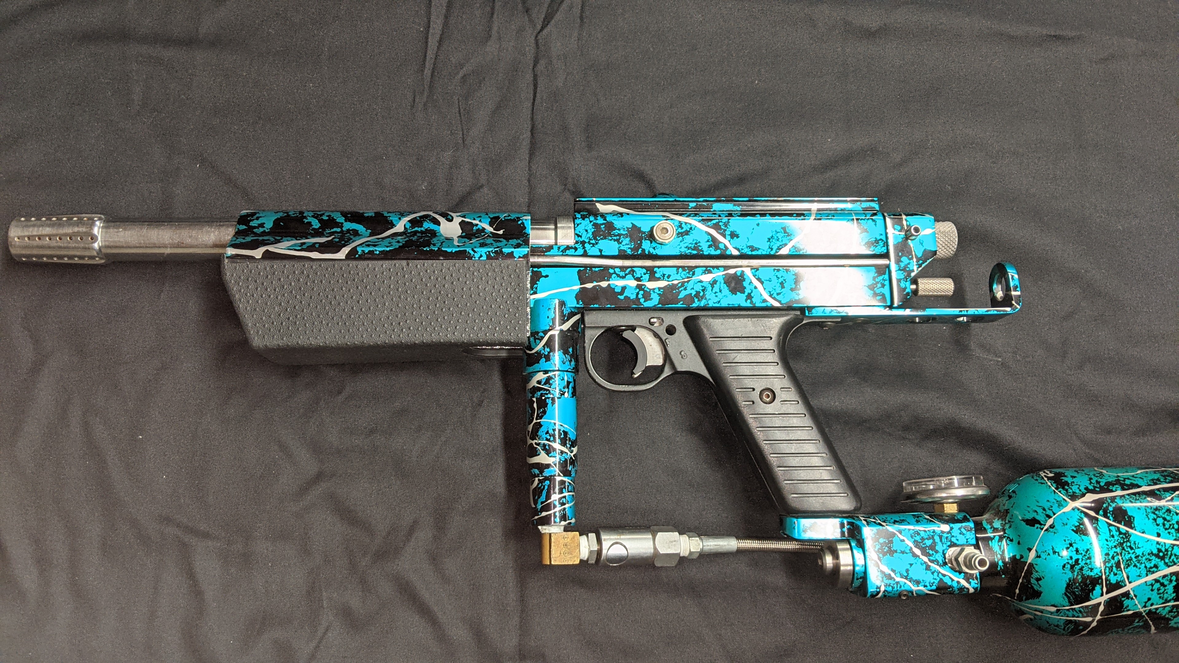

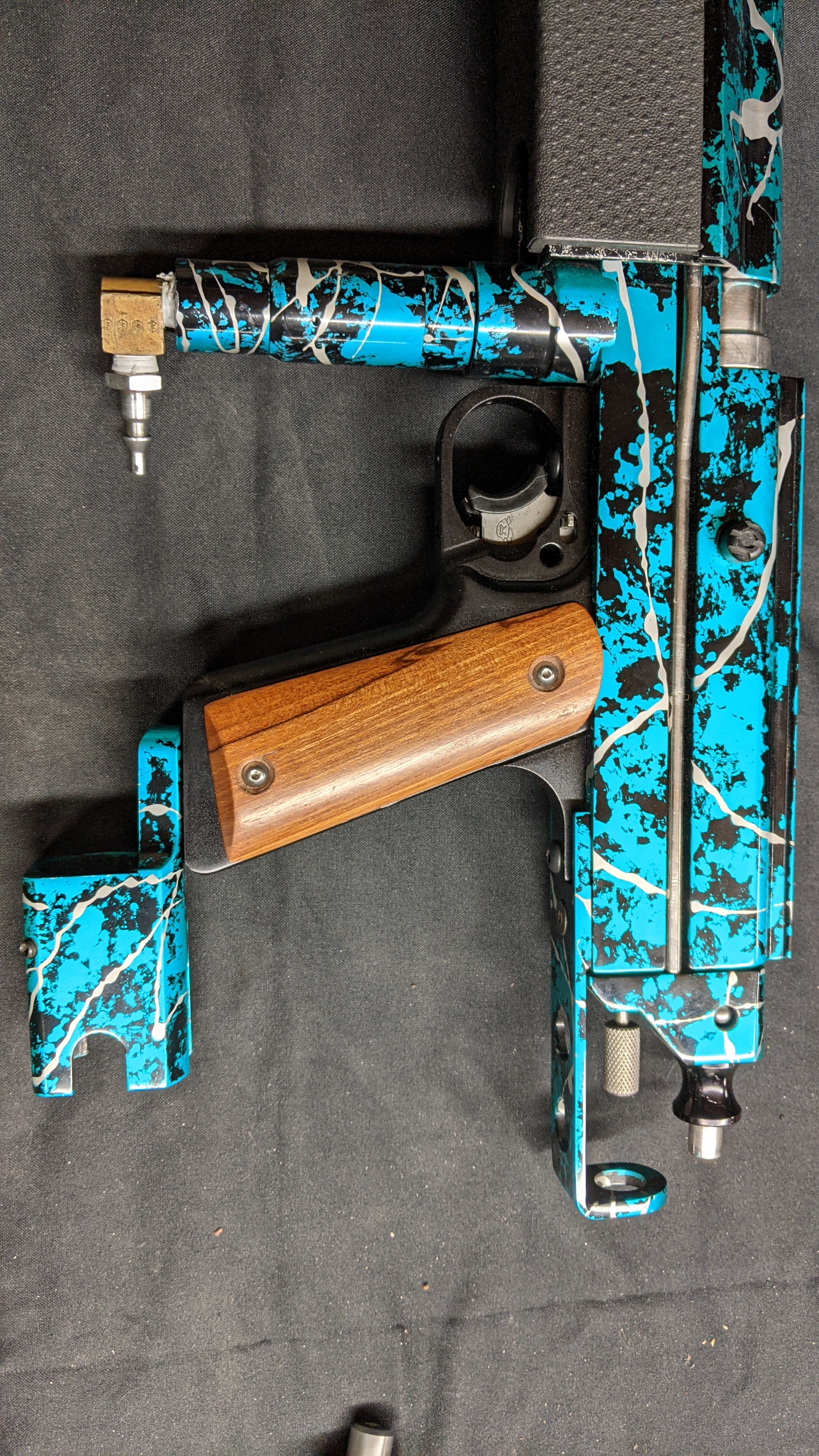

    Pic of the pre99
    Click image for larger version  Name:	PXL_20210407_003203273.jpg Views:	132 Size:	3.48 MB ID:	218289

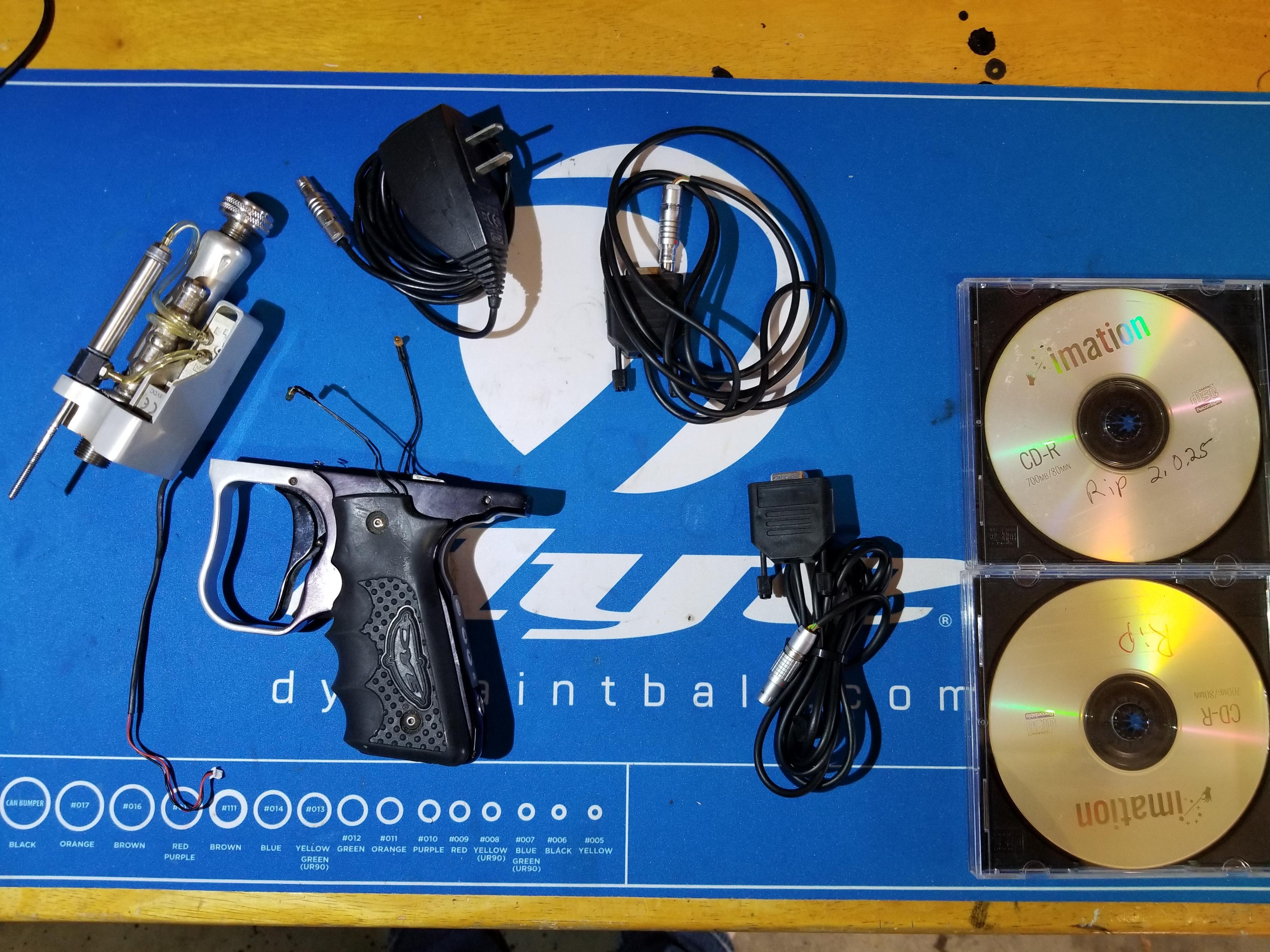

    Pics of race frame from person i bought it from.

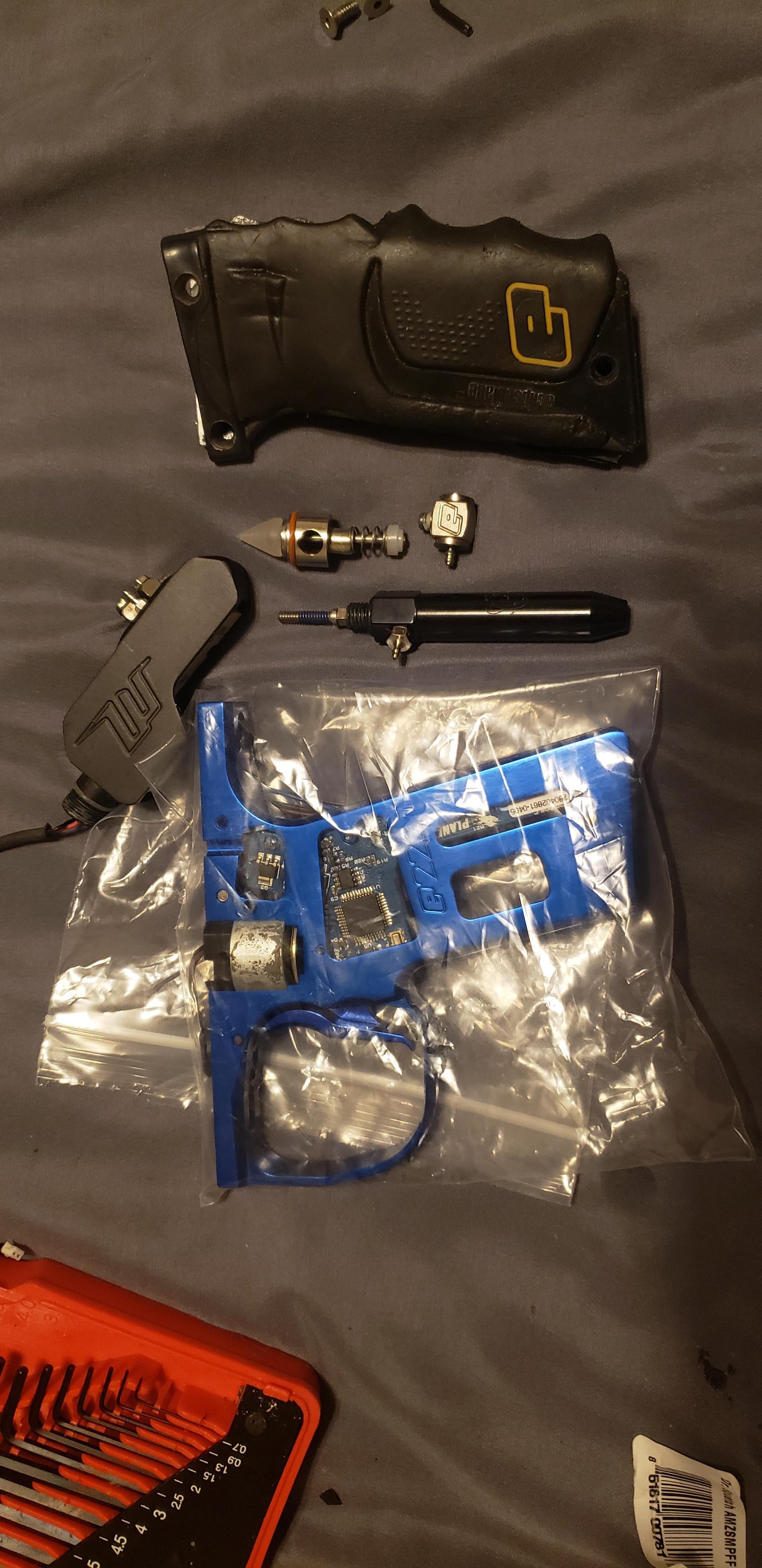

    Eblade E2

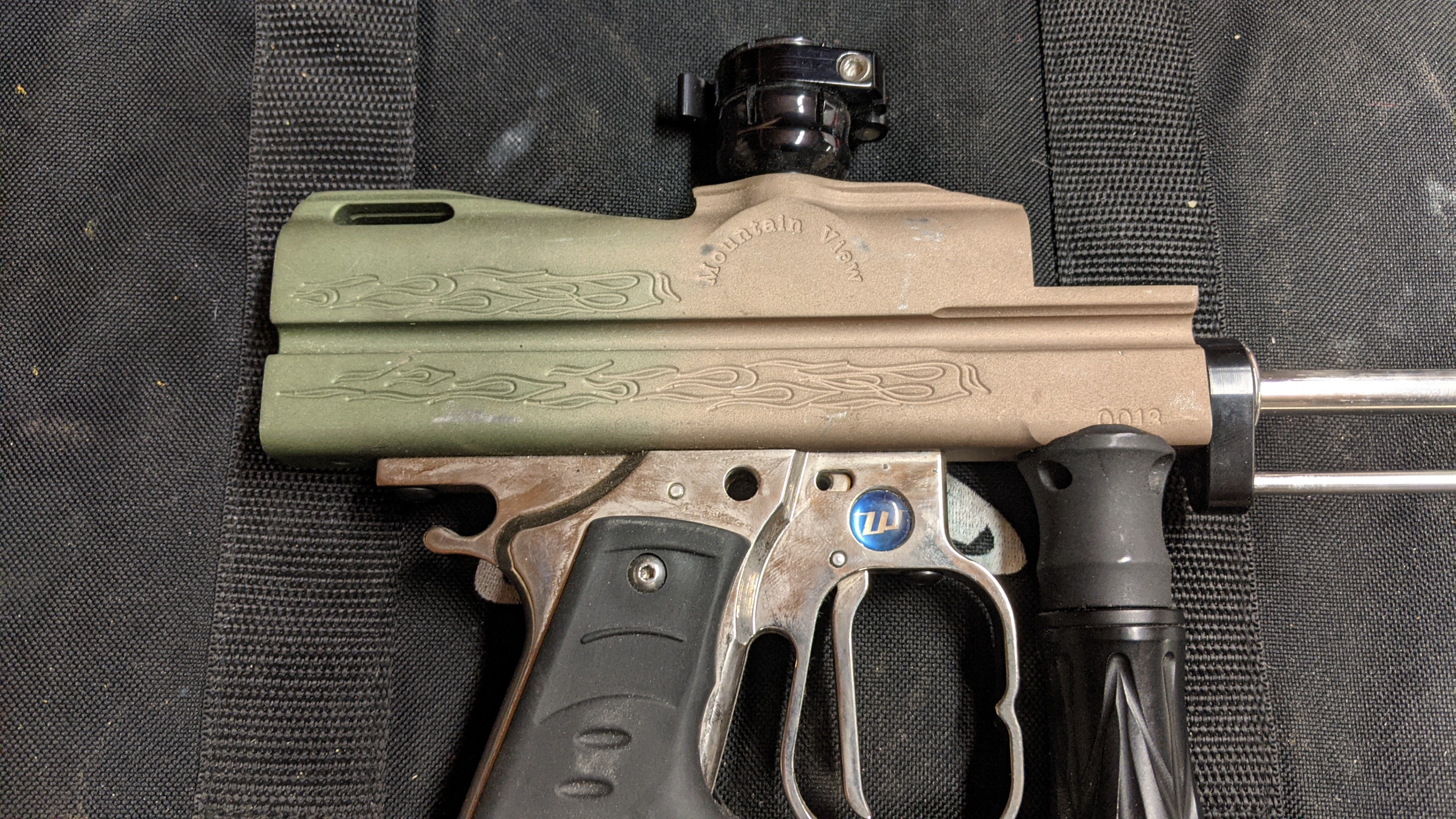

    Mountain View Body

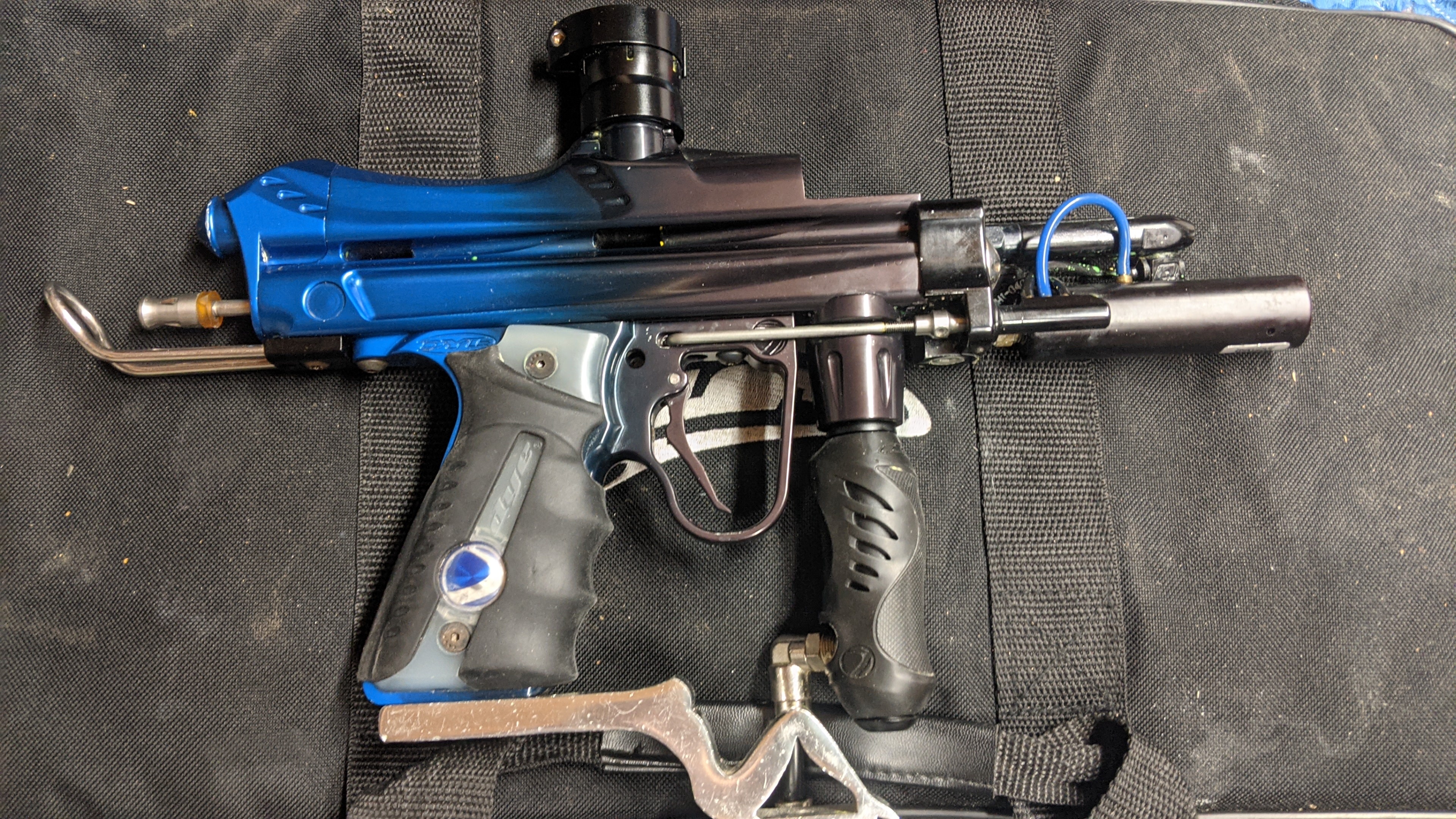

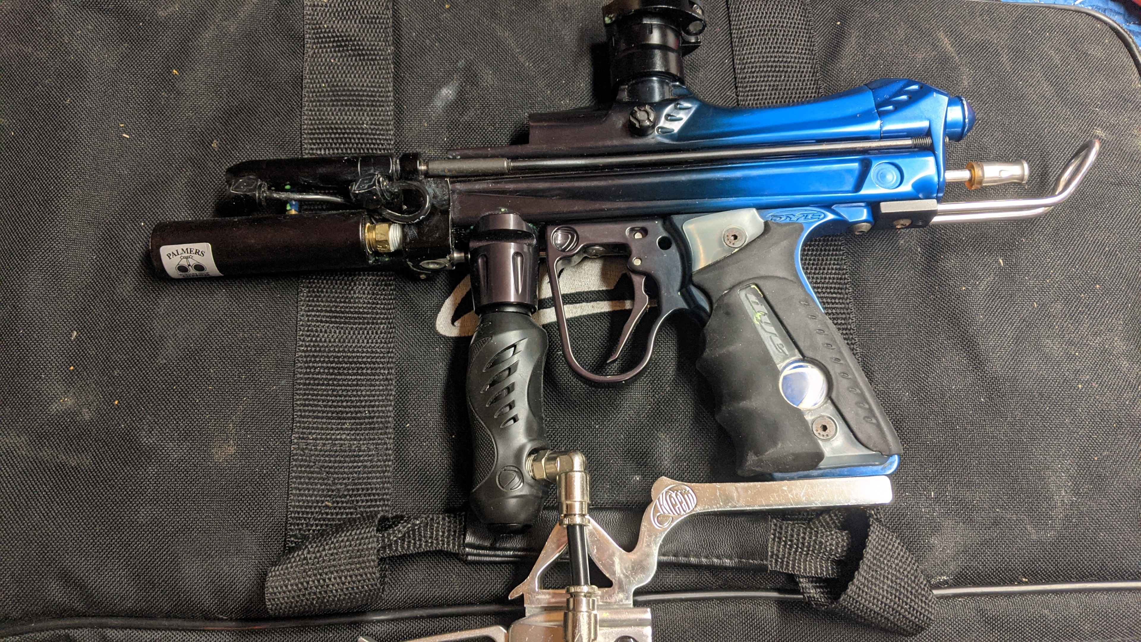

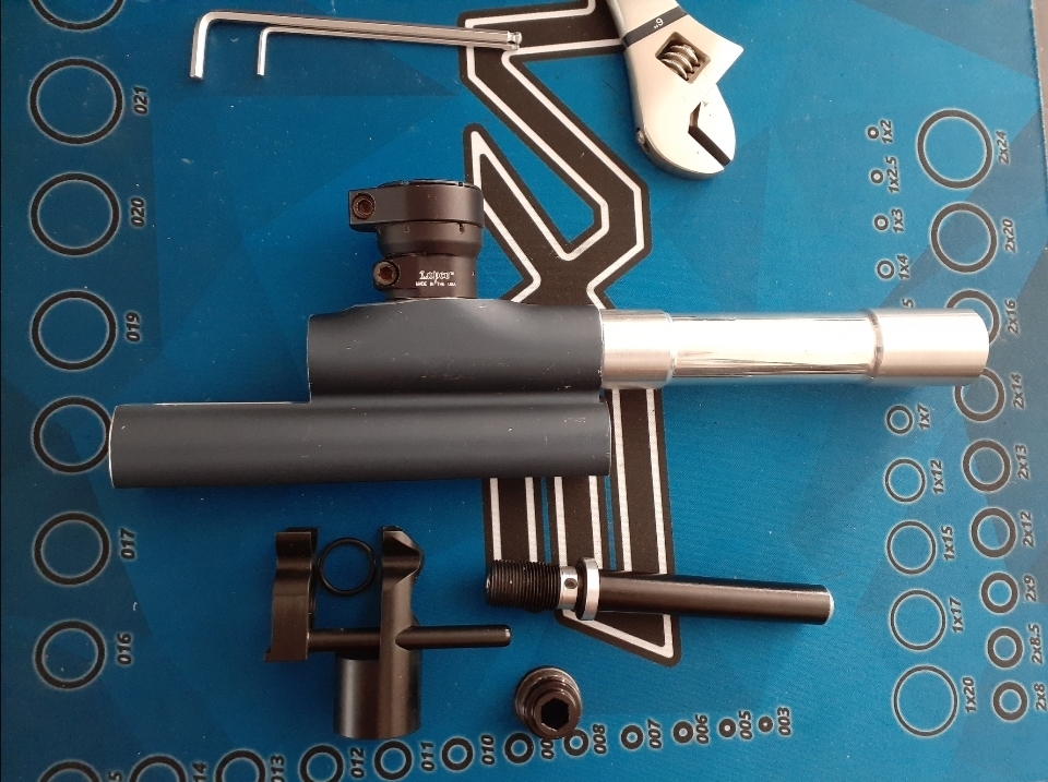

    Dye Deflex (Dirty Girl) Eclipse ram with 2 qev, palmers rock lpr, ID 3 way, Dye HPR,

    I highly doubt anyone here would ever forgive you or respect you ever again if you made that pre 99 electronic. Just the thought is making me ill. That gun is absolutely gorgeous as is. Thank GOD you aren't drilling it for eyes at least.

      There is an adaptor you can use on trilogy to mount the eblade 3way without machining and there is an adaptor too to use a standard LPR. You could go all out and use the ID 11/16 valve and it would make and awsome shooter.
      As for your pre99 you could change the pneu for an ID pneu set and you would have a good sleeper shooter.
      Velcor would not be pleased if you put the eblade on this cocker, you might never hit your target again
      Be carefull

      This is the way. All black Inception pneumatics on the front, under that awesome matching shroud, will get it to be a great restomod. I'd bet just a rebuild on the whole thing as is would be awesome. Also if that bottle is aluminum, you can just get it re-hydro tested, and rock on. Keep that thing as it is, it is amazing!
      EDIT: Add in a retro freak bored barrel, and it will be perfect.

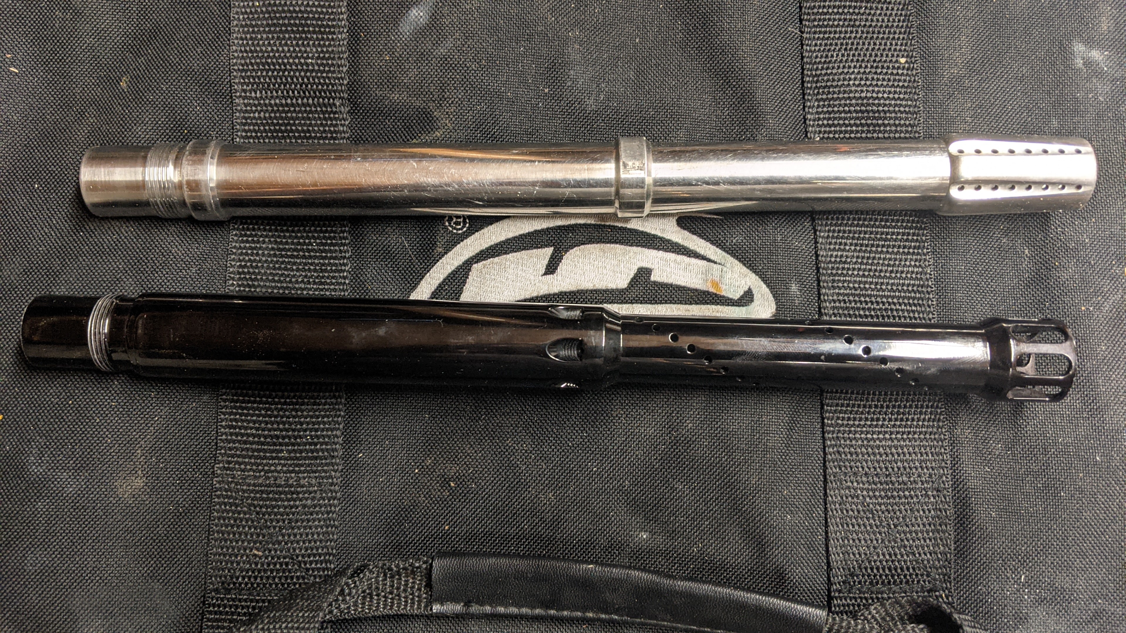

        As far as sleeper that was the original plan, the race frame was just a good deal that i thought might be fun to try thus my hesitance to put eyes on it or modify it at all. My plan for barrels was to get the currently pictured barrel freaked or i have an all black one that has a lot of meat on it that i might go with.

          So the plan as I see it at this point in time. To everyone worried about the pre99 it will remain a fully mechanical marker. I will be updating the ram (ID(own)), 3 way (belsales Hollow point (own)), LPR (Dye DFF-20 LPR), the internals will be a rocket valve if it fits, a stock hammer, and I may be buying a spring set. I am trying to get a hold of someone to freak xl bore a barrel or two for me. Getting ready to reach out to BMC fab. I have this trigger and frame that i had sitting around and then grabbed a set of wood grips that i had for another project the brass 90 has been replaced as well as the ball detent is now chrome. I wanted to ask if anyone knows if i can fit another regs parts into the stock wgp regulator so that i can keep the anno but update the internals. if not I may rebuild that air america reg and put it to 200 psi and go without a 800-200 step down i would imagine this may cause some air supply issues but it may not. If anyone has thoughts on LPR, valve, regulator, or anything that will make this marker shoot please let me know.
          I am currently going back and forth about what to do with the eblade I want to put it onto the trilogy using the adapters that Alexndl's mentioned, but i kind of want to try it on the dye reflex as well. If i use it on the reflex i would not be drilling it for eyes i would just use it without eyes.
          The raceframe i am trying to decide if the mountain view body is something i have to keep or if i want to go with a whole new raw mini body from pbgateway. If i go with the pbgateway version i would need to buy a new set of ID or shocktech pnuematics and front block as i already have ivg, valve, hammer spring and other internals that i can use I am sure in my multiple parts i have a bolt but may need one there.

              That mountian view body is cool! Is that set up to be an internal cocking deal, or is is supposed to be a back block?
              Either way, I think If this were my collection, and I wanted to use the e blade, Id e blade the trilly, and run it blind. And Id race the mountain view, leaving it blind.
