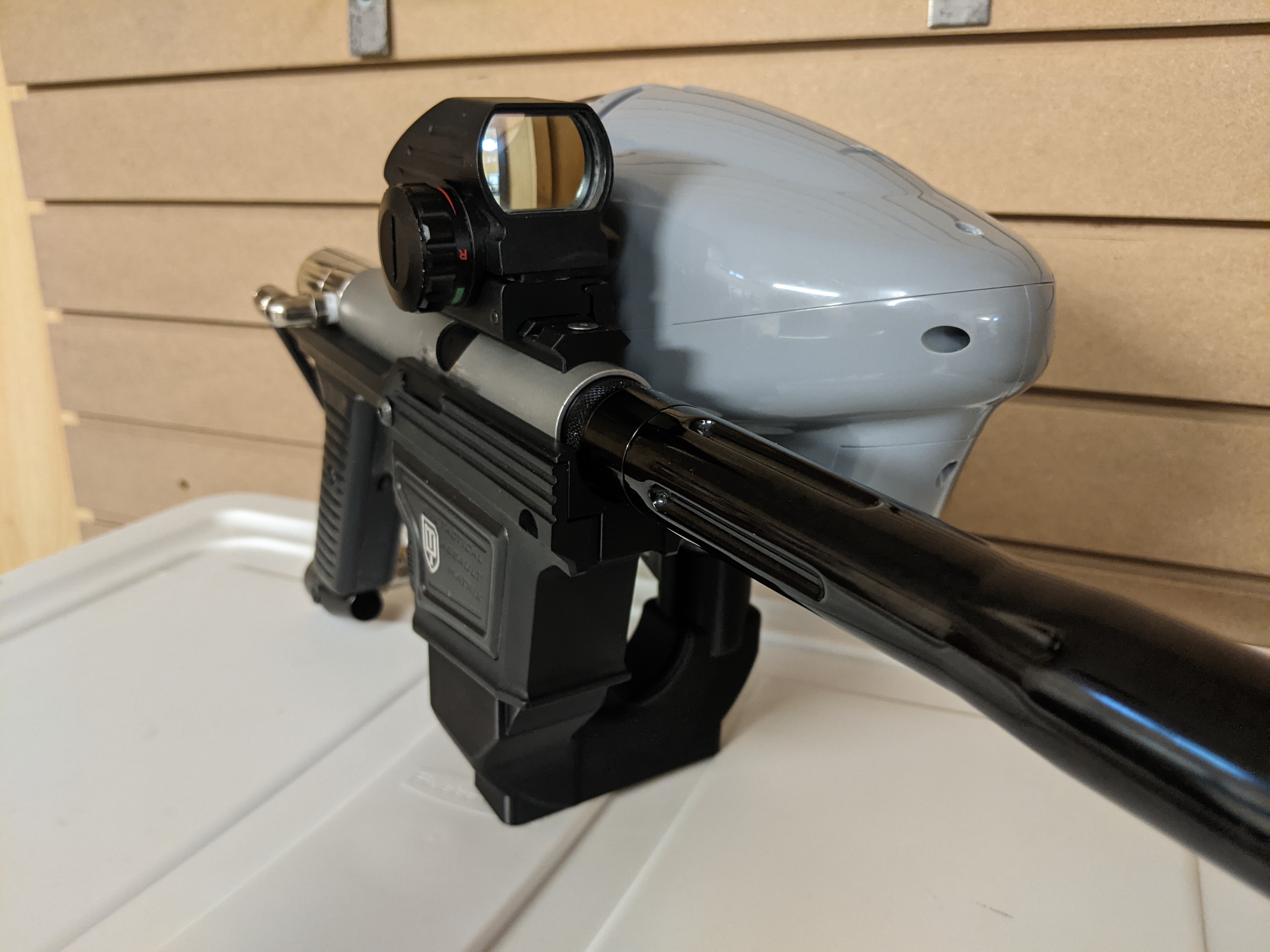

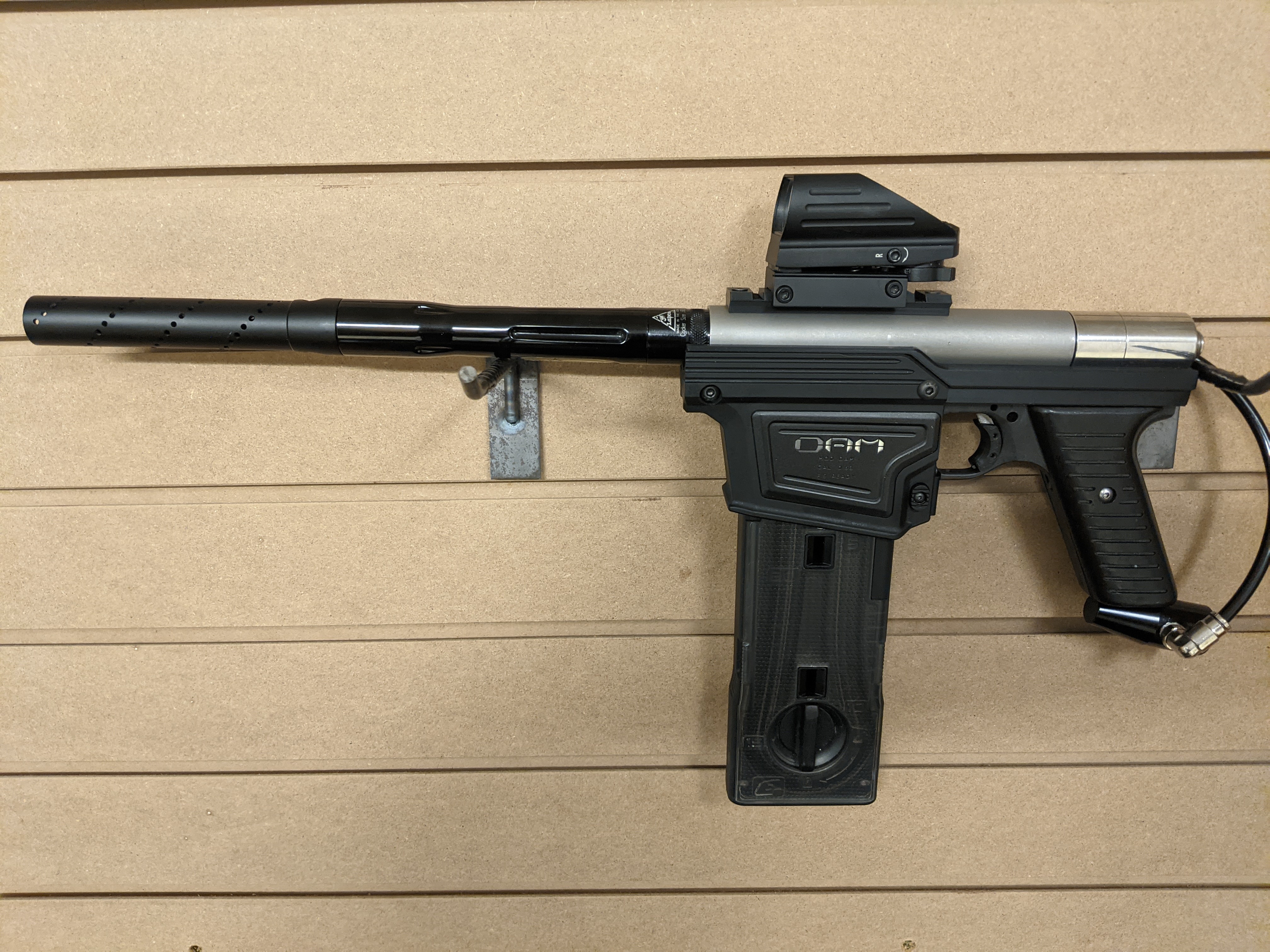

    My version of Ghost Flanker's magfed Automag.
    It was a bit of work milling and welding and designing but I got it done.
    3D printed rail, sight rail and trigger shoe.
    Custom trigger
    I also designed a warpfeed for this thing for open class play. PXL_20220513_125258654.jpg PXL_20220513_125641920.jpg

    That's too nice. Do you have a level 10 in there? I can't see the PE followers working too well with a level 7.
    • anson
      anson commented
      Yeah there's a lvlx bolt. I was thinking the same thing
      Though trying it out with the cf20 it seems to dry fire. I had to give a little meat to the rail so the magwell sits a bit lower
      I guess the bolt is skipping over the follower
