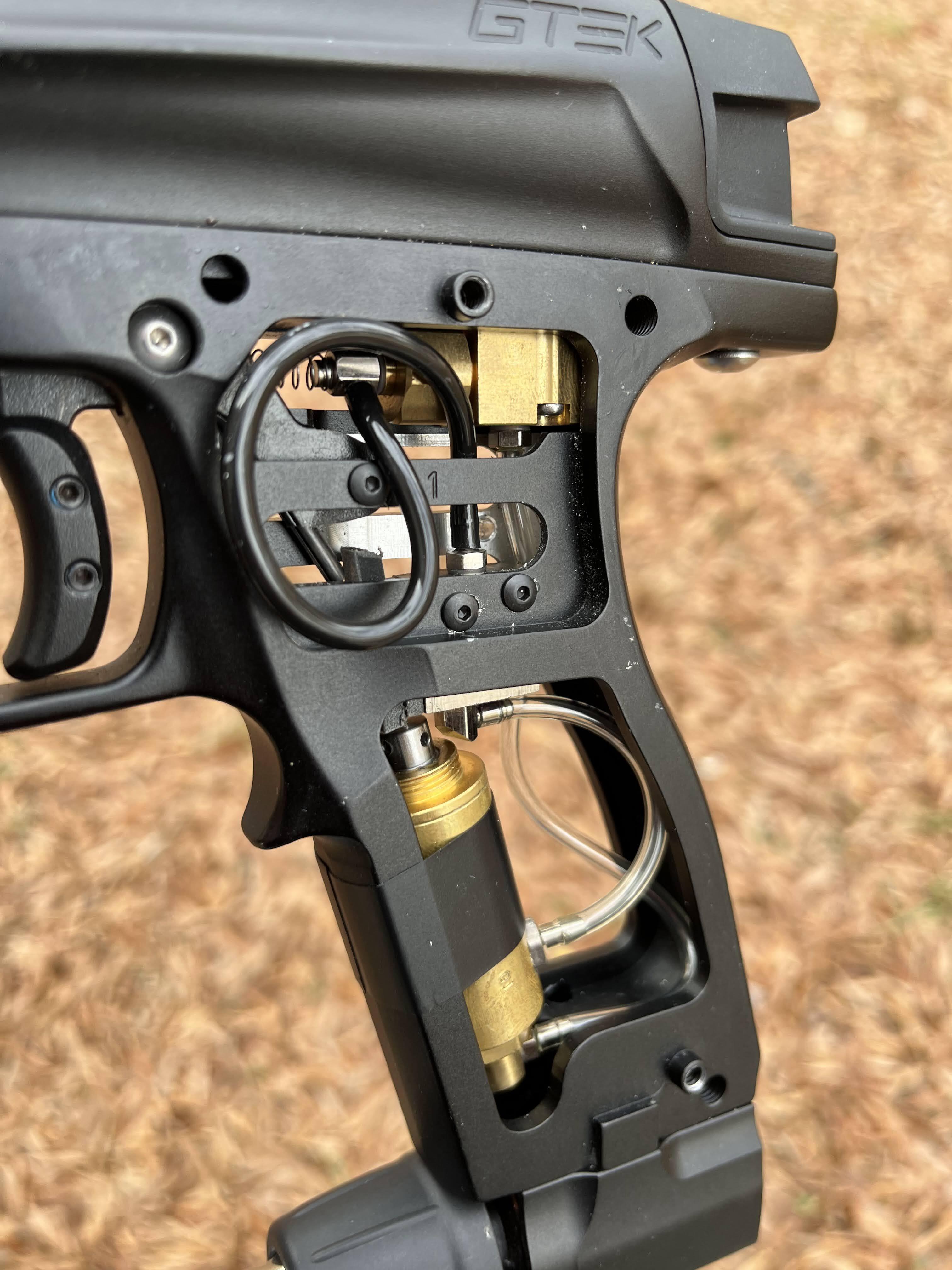

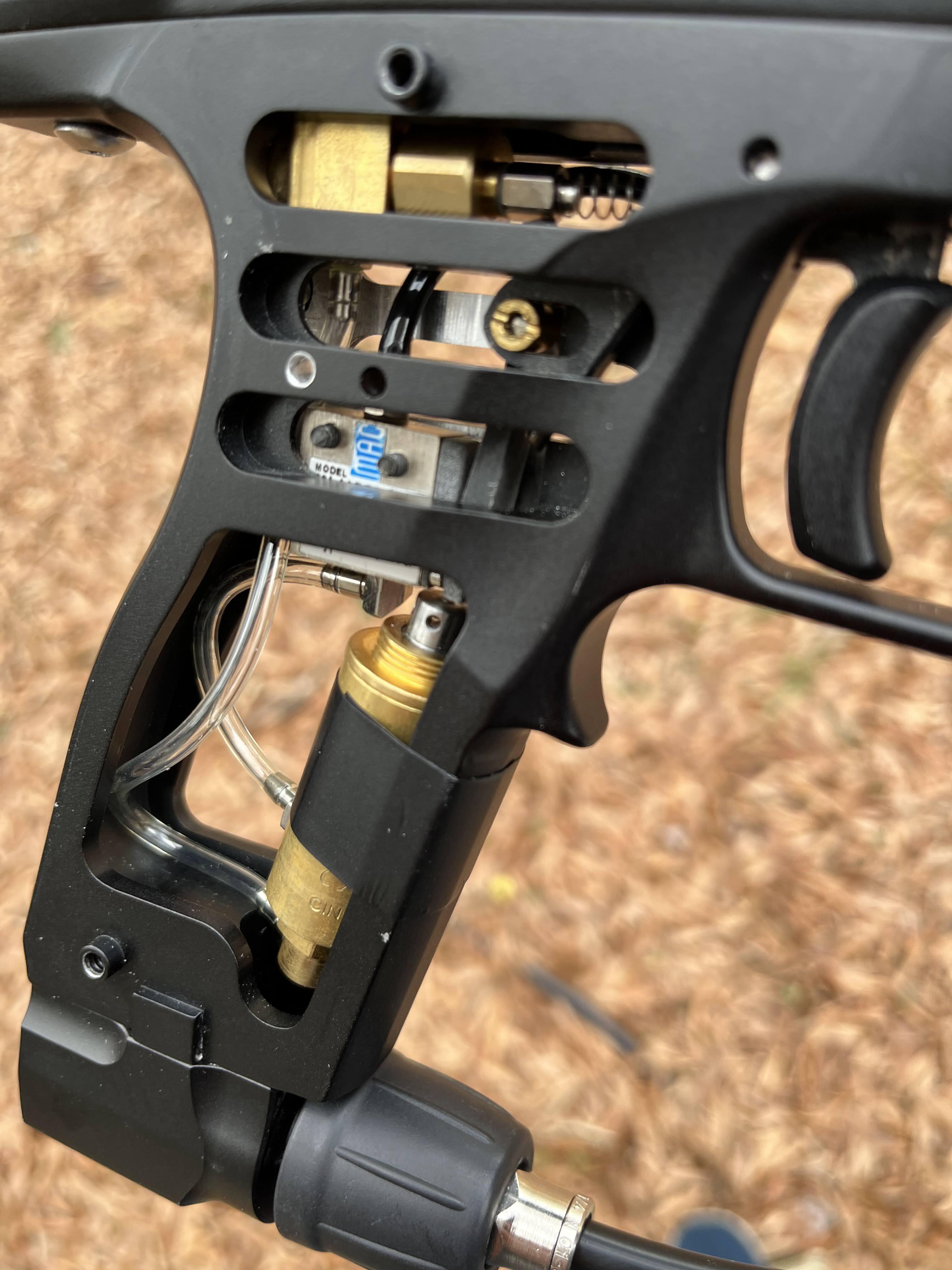

                        I don't want to steal anyone's thunder, but there's another issue I should tell you all about, and that's the slider mechanism in the Gmek frame.
                        Not sure how I missed this thread when it started, because I actually did a similar project over the summer to lighten the trigger of my Gmek, although I went a different route. Rather than mod a better 3-way valve, I tapped into the Gmek 3-way and rerouted some of the input air through an LPR and to a pneumatic solenoid valve. So, I basically made a pneumag frame, but for the Gmek.
                        I'll attach some pictures below, and here's a video of the trigger. The actually trigger pull could be probably at least 50% shorter, but I had to leave some slop in there for the safety.
                        https://photos.app.goo.gl/Wiiorb6a9F1UyKyMA
                        I was mostly happy with the results, but one thing puzzled me for a while. The trigger on the pneumek (as I call it) still wasn't as light as the trigger on my pneumags, even though I was using the same components. At first I thought it was simply a matter of leverage, since the pneumek has a single trigger and most of my pneumags have double triggers. Then at Christmas time I bought a single-trigger M170R with a hAir valve installed, which is great. It's a longer pull, but definitely lighter. And that confirmed to me that something was up with the pneumag trigger.
                        I fiddled around with it some more, and eventually I realized that the problem was the slider frame. The slide inside the frame is well made and the brass bushings make it very smooth, but it has a LOT more mass than a regular trigger, and that requires a stronger spring to reset it. That's why the pneumek trigger isn't as soft as the hAir or any of my pneumag triggers. I did try changing the return spring, but the weaker springs I tried were either too slow or unreliable.
                        Don't get me wrong. It is better. But I have a feeling that you all are going to run into the same issue. Even if you figure out how to replace the Gmek 3-Way with an FL valve or a hAir, the trigger still won't be as light as it could be because of that strong return spring. To fix that problem, you will also need to do something else. You might need to design a replacement slide that's made from something lighter (3D printed Delrin, perhaps?) or take out the slide altogether and replace it with a pivoting trigger.
