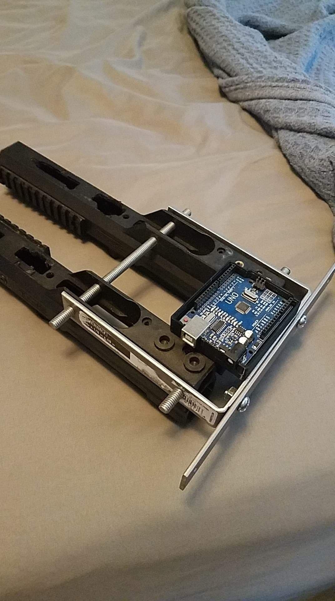

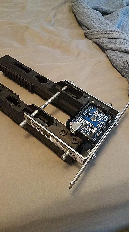

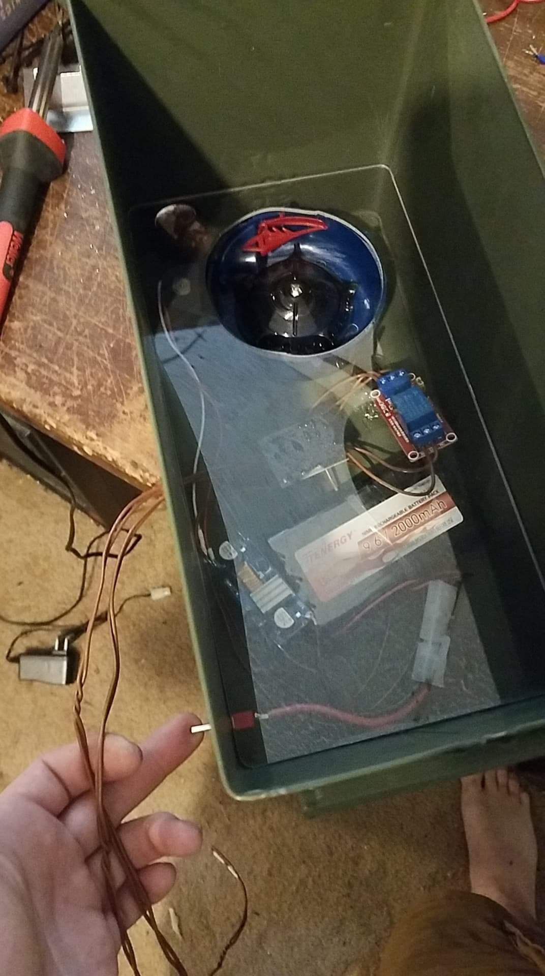

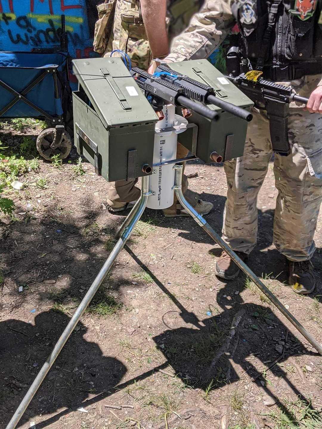

    This is the Double ION Cannon (SW fans, rejoice), made from two ION cores, SP-1 bodies, HALOs, 50cal ammo cans, as well as some pvc pipe, and some welded steel.
    It is arduino powered and alternates firing the markers. It currently has no external control over the BPS available, until I get some more buttons installed in the control panel. Eventually, it will also have RFID access, which will act as a secondary safety measure when not being actively used.
    The halos running on the upgraded motors at only 4v appear to be able to feed around 10-15bps, which is the max I plan on letting each marker fire. The final form of the programming and control layout will enable the turret to fire from 4 to 15 bps (total).
    A specific piece of the design is that the entire top, mounted on the toilet flange, picks up and can be handed up onto the top of the jeep tank I am building, and drops right into another piece of 4 inch pipe, mounted to a rotating ring.
