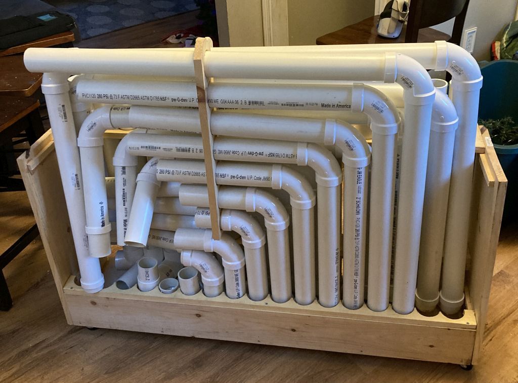

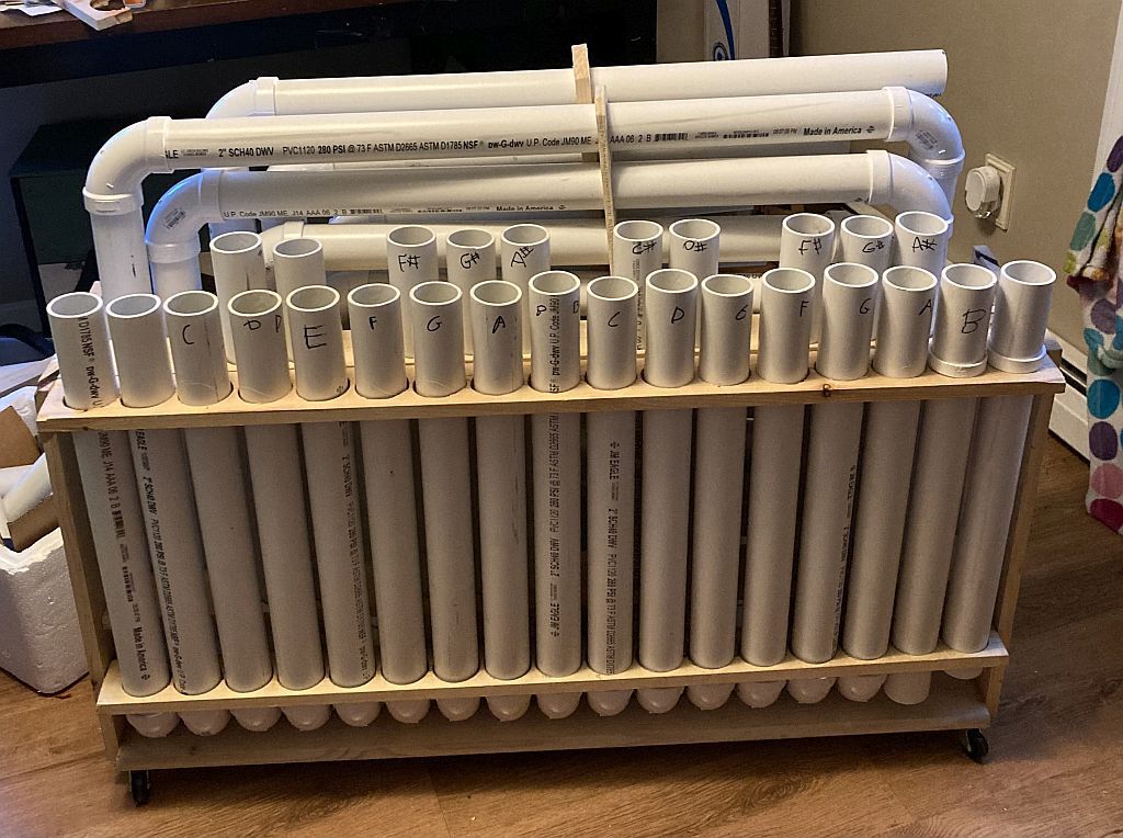

    Not paintball, but I have so many projects stuck half way done, I'm just happy to see something finished.
    A slapaphone is a musical instrument consisting of a set of pipes of different length. When you "slap" one end of the pipe, you get a note.
    The wavelength of the note is equal to the length of the pipe. So, C1 is 8". C2 is 4", C3 is 2", and all the other notes are between.
    One of my kids asked me to build them one. Something simple, but I hated all the designs I saw on the internet. They were all giant, clunky and ugly looking. I wanted it small enough to be portable, but have a full range of notes, so it could play most anything. And it needed to have "symmetry". Not just random pipes.
    And now its finally done. Just waiting for paint. In total: 150 feet of 2" PCV pipe, and 80 90-degree elbows.

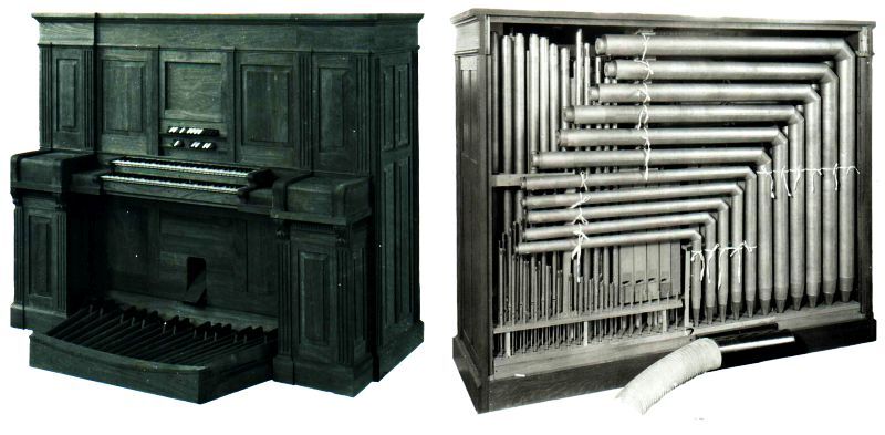

                  In fact, apart from my paintball collection, I also have a music instrument collection. A little bit of everything, but one thing that I have been looking for to add to my collection was a "Mortuary Organ". They were only built for a few years, and a very niche item in a niche market. But I was facinated by how organized the internals were, so I wanted to design my slapaphone to look like it:

                    Old boiler control panels were plumbed in stainless tubing and valves the same way. It looks like you've got a good grip on the art!
                    I can't even find a good picture. I worked on some that were absolute art.
                    Not just ganged together neatly, but fully stuffed in a cabinet like that organ.

                    This was the first test before I added sharps, and I also added a low A and B
