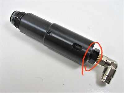

    I’ve got an Ion reg that is leaking from the adjuster nut because I tightened the macro line too much. I was thinking of buying a used one, but then I thought there might be a way to fix this.
    Has anyone attempted to fix this issue? I figured I could cut off the lug flush with the lower half of the adjuster body, drill out the hole and then tap it with 1/4” NPT threads. Then I’d use a stainless 1/4” male NPT to 1/8” NPT female reducer. To test I’d seal it with Teflon, but then I’d use red loctite to seal it more permanently in place. I’d have a standard fitting and a hex lug to adjust the pressure, just like stock.
    Thoughts? Figured if I screw up the adjuster, I’ll still have a broken adjuster 🤪

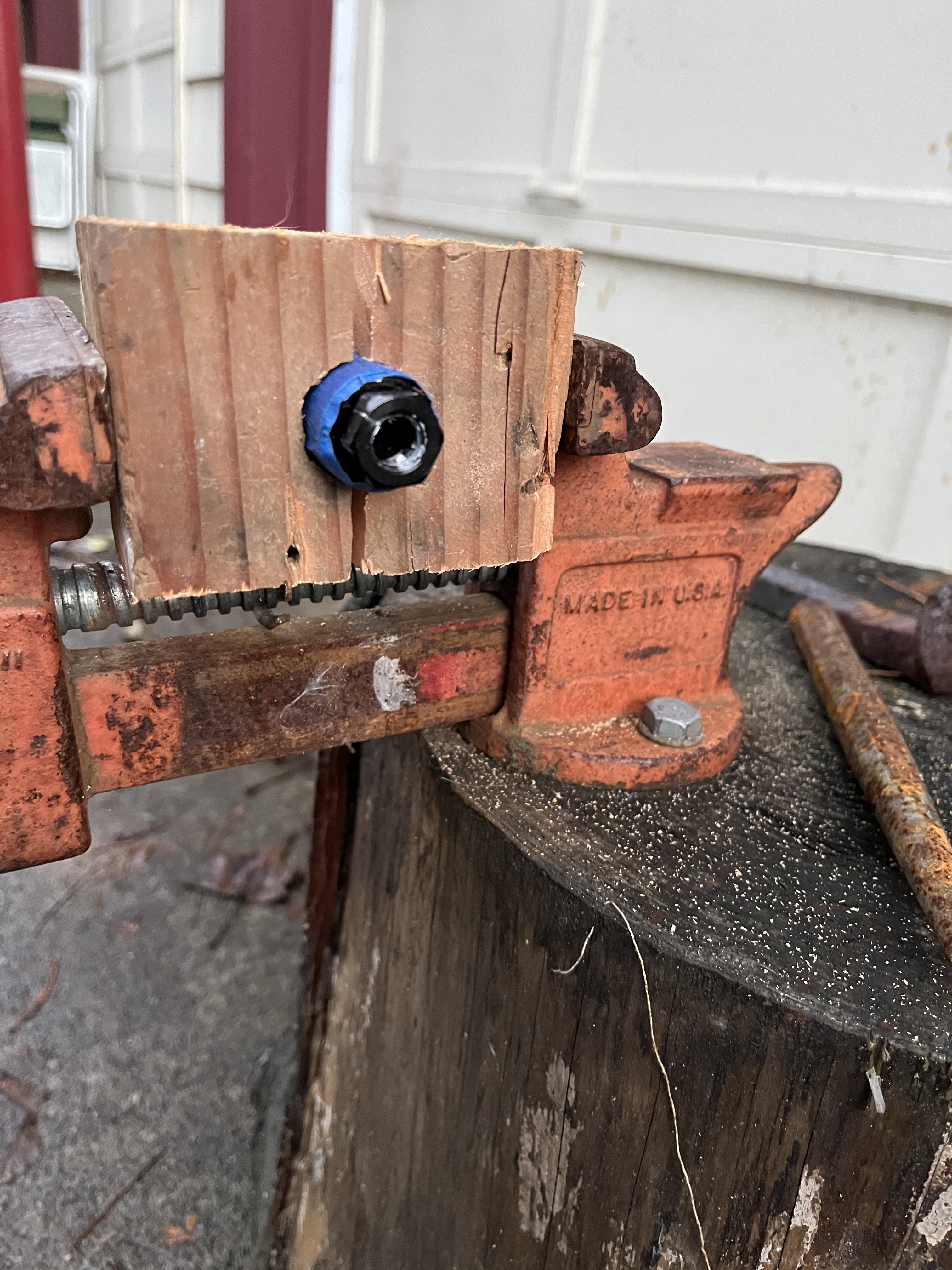

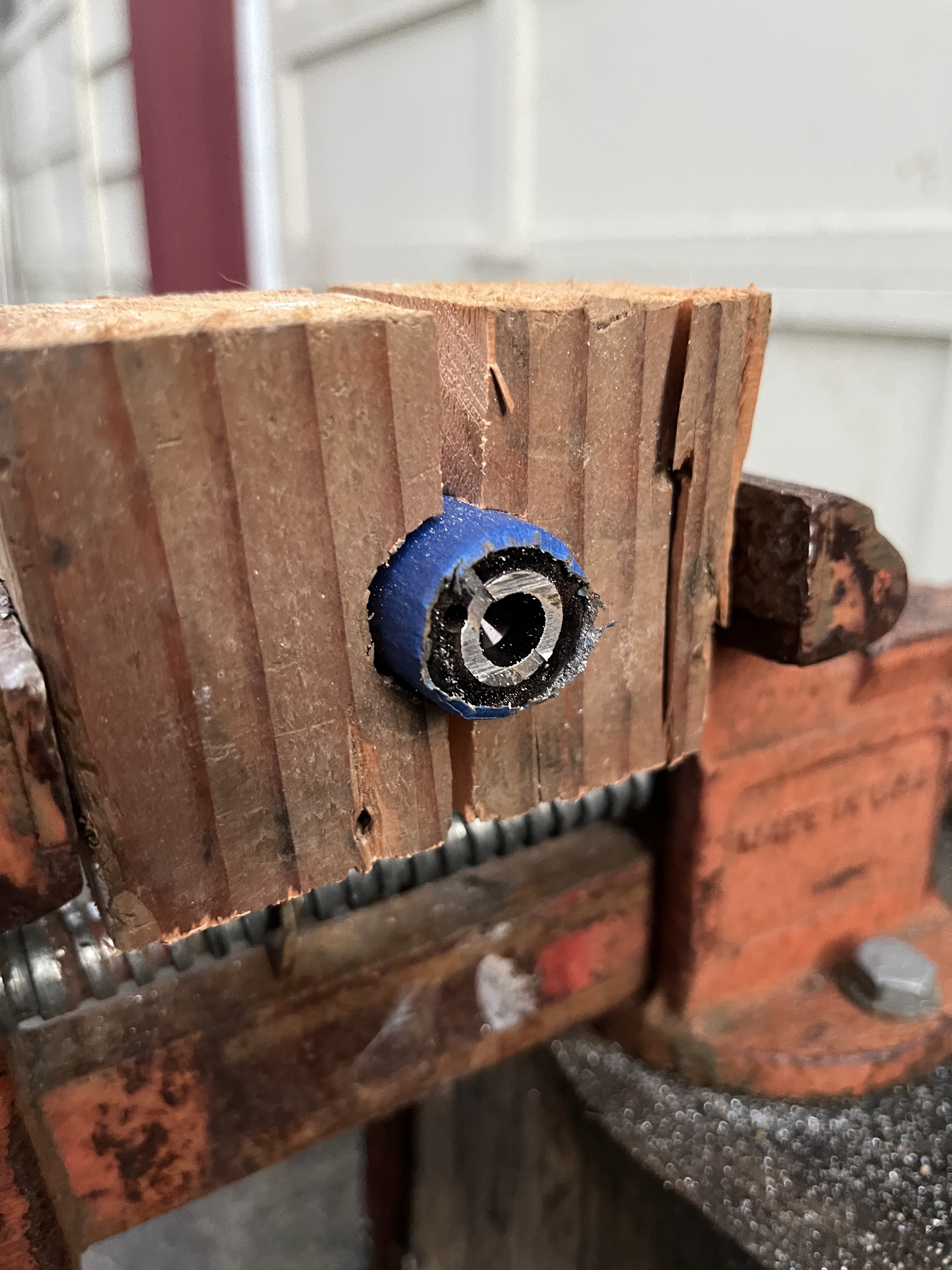

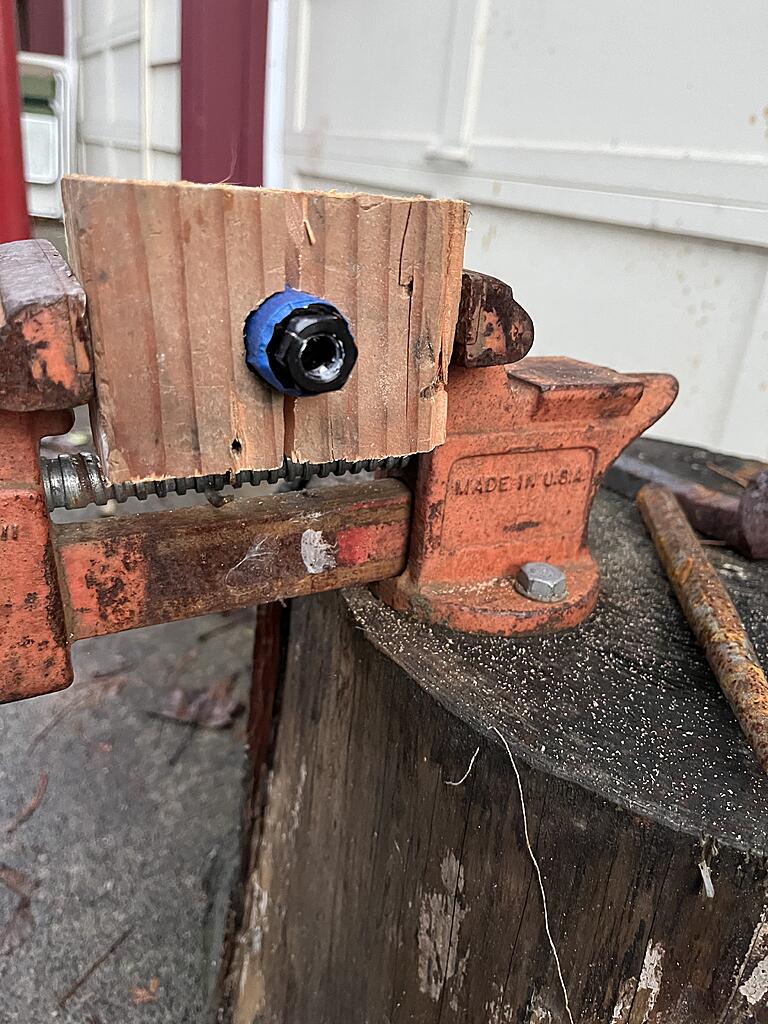

                      I made soft jaws out of a piece of 2x4 and drilled a 13/16” hole, then zipped it in half with a skil saw. Painter’s tape just for good measure. A hacksaw was used to cut off the cracked collar.

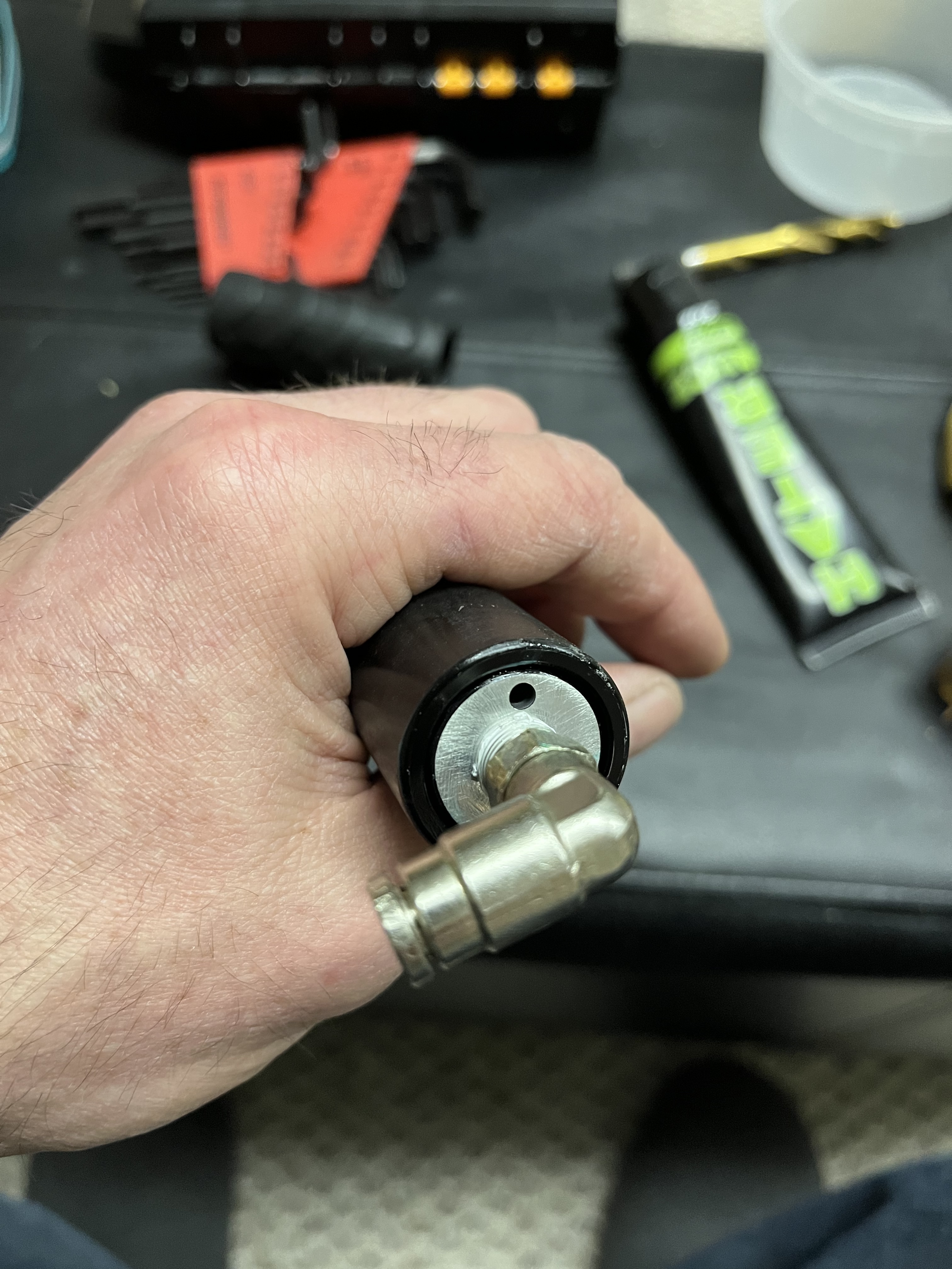

                      After sanding it down flat, I used a 11/32 drill and a 1/8” 27 NPT tap. My tap needed a lot of extra room at the bottom of the hole, so I had to go pretty deep. I ended up boring past the hole for the small retaining screw that keeps the reg from backing out while under pressure, but in the end just wrapping both that little screw and the swivel fitting in Teflon made for a great seal. The adjuster end was polished with a cloth wheel and jeweler’s rouge. Aired up, sealed just fine.
