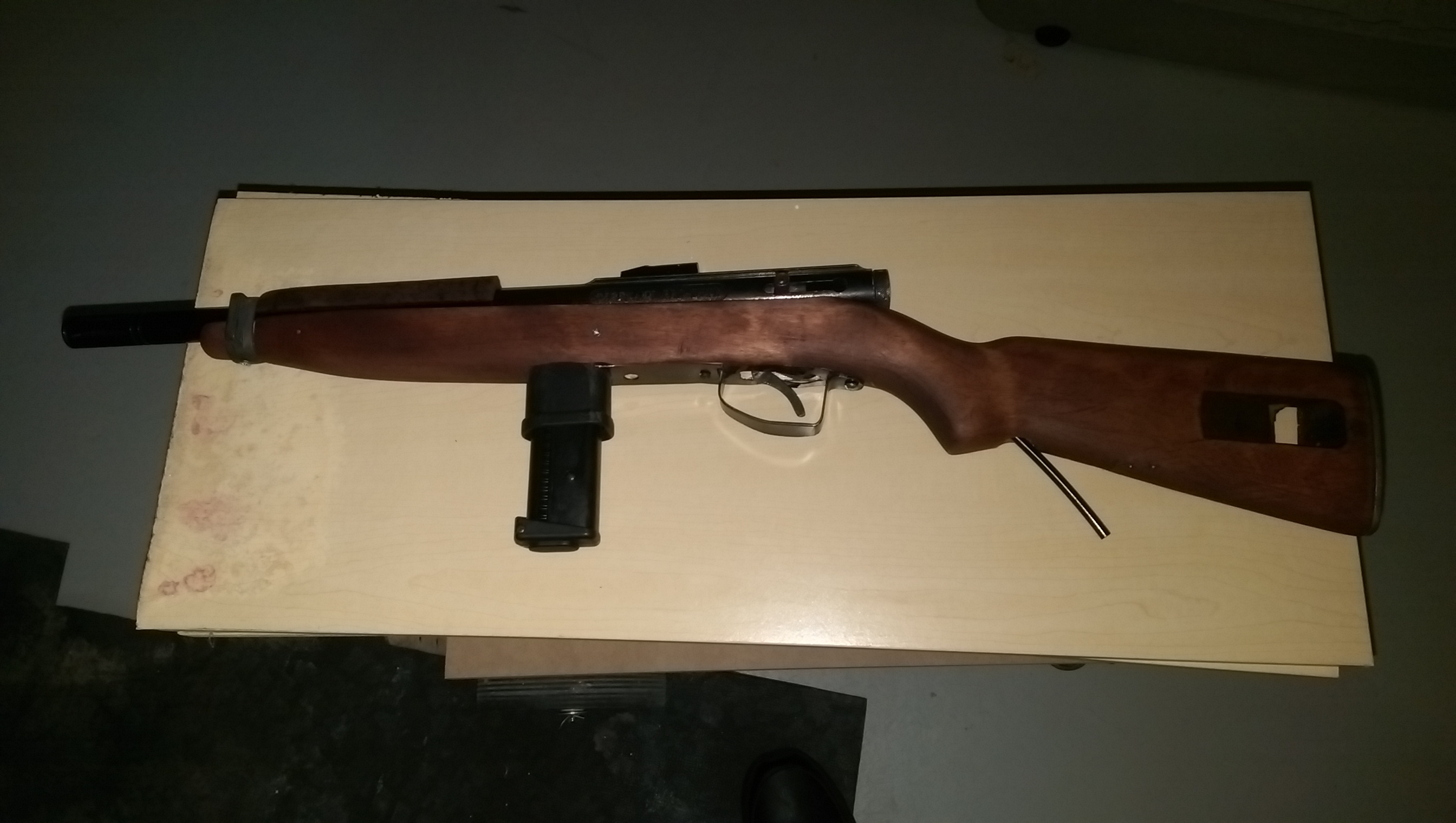

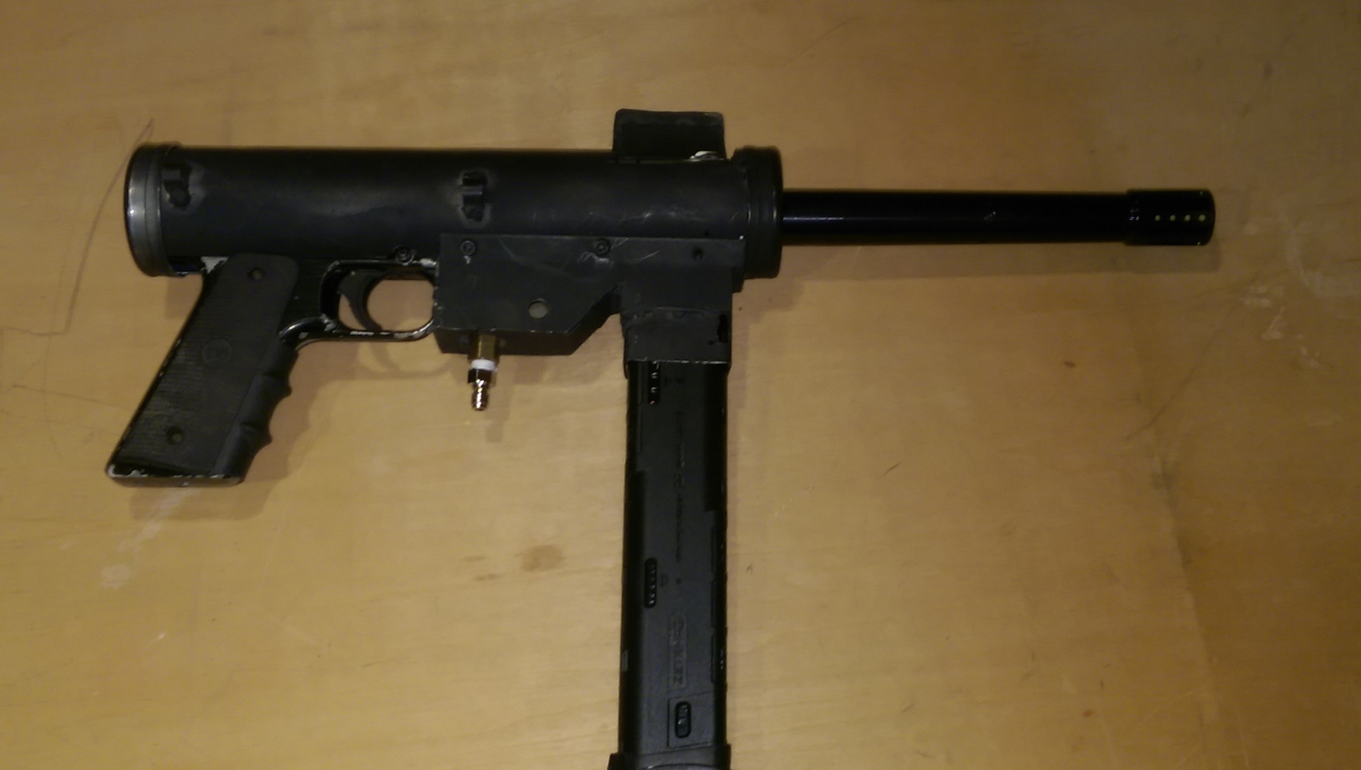

    Do you have a preference for starting point. I have mag fed damn near everything in a cheap semi: Tippmann 98, 68 carbine, pro carbine, pro light, pro am, 68 Special, BT 4, JT Raider, and even a Brass Eagle Stingray. You can buy magwells from MCSUS.com and mod them to fit the gun format. So you need to decide round or FS. Then pick a magazine type that is suited for the paint choice. DAM mags are great, but feed from the rear stack, making the magwell placement tricky. MCS/Rap has several magwell variants that can handle the DMag and Helix mags. More durable then printed magwell. Tipx magwells are great for round ball only. I can posts some picks if you are interested. I also have some bodies prepped for mag fed modifications.

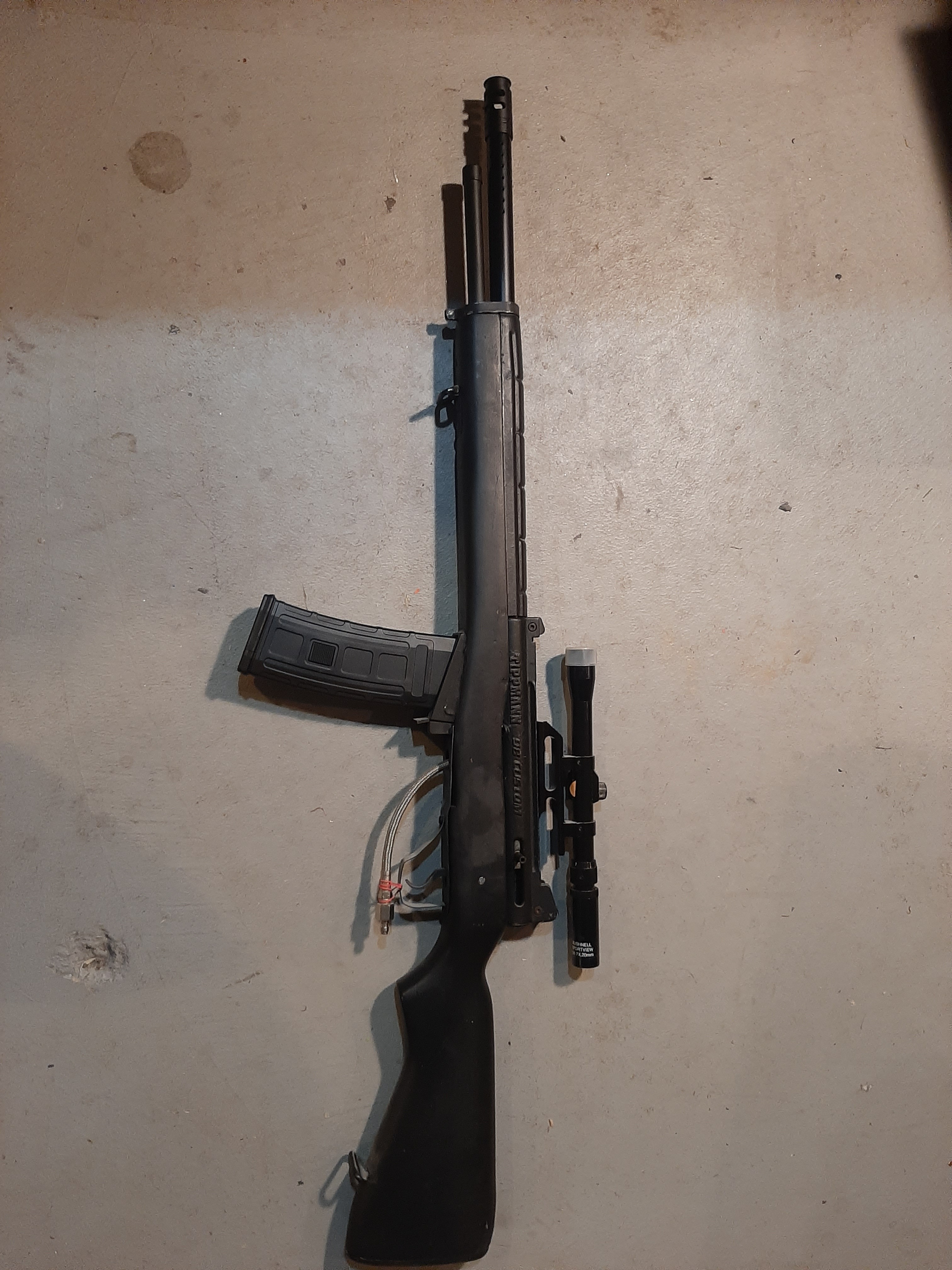

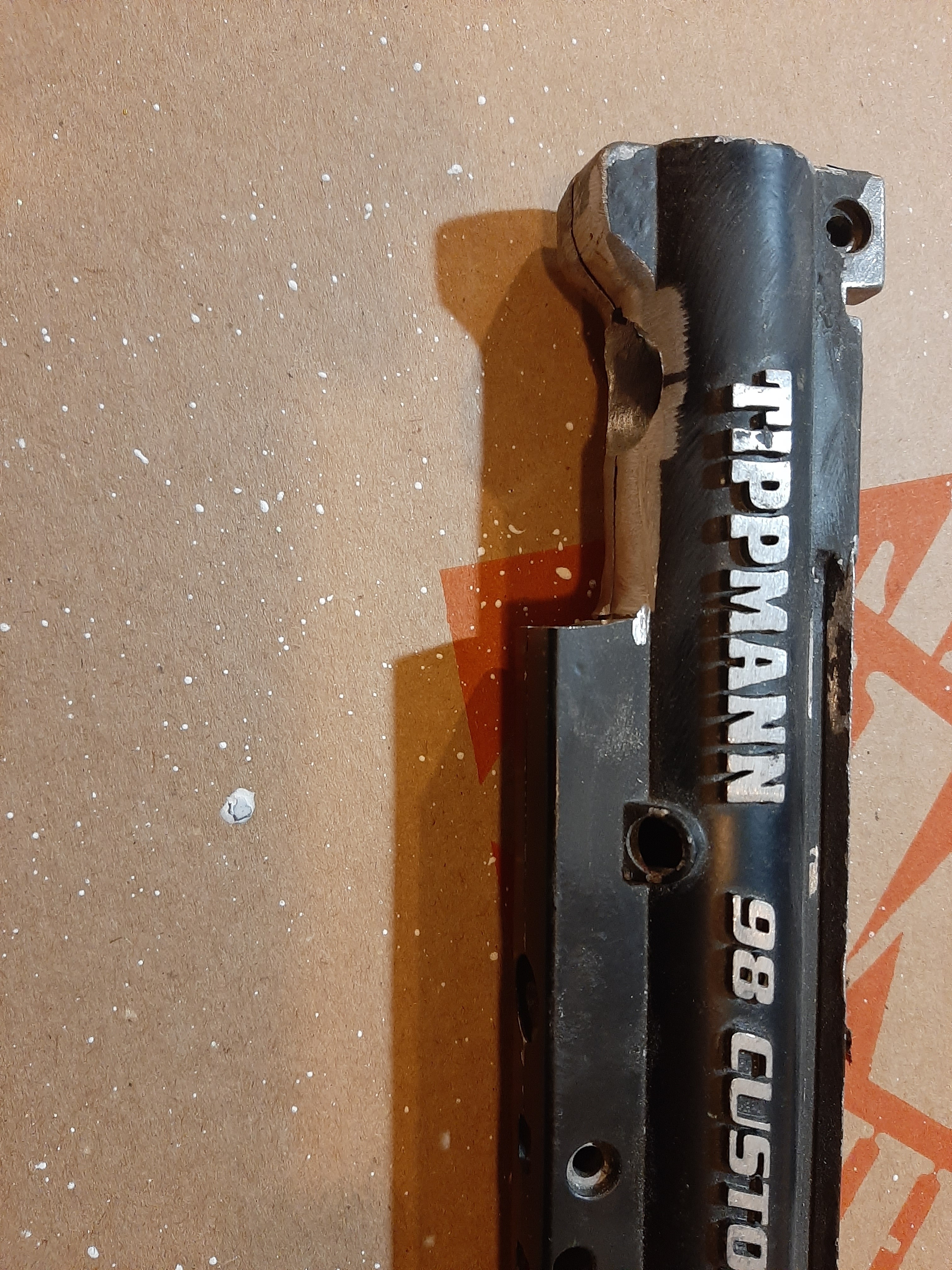

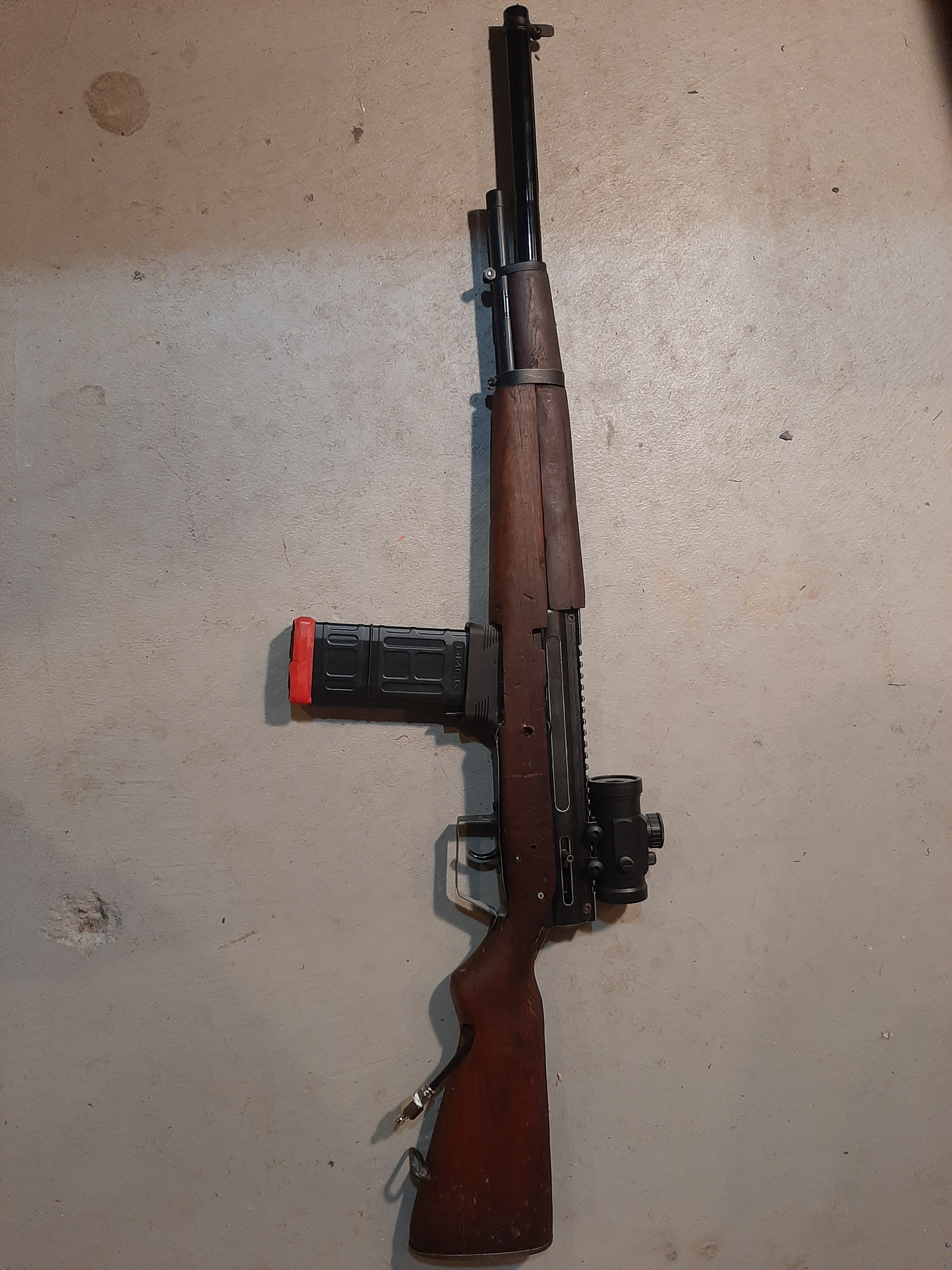

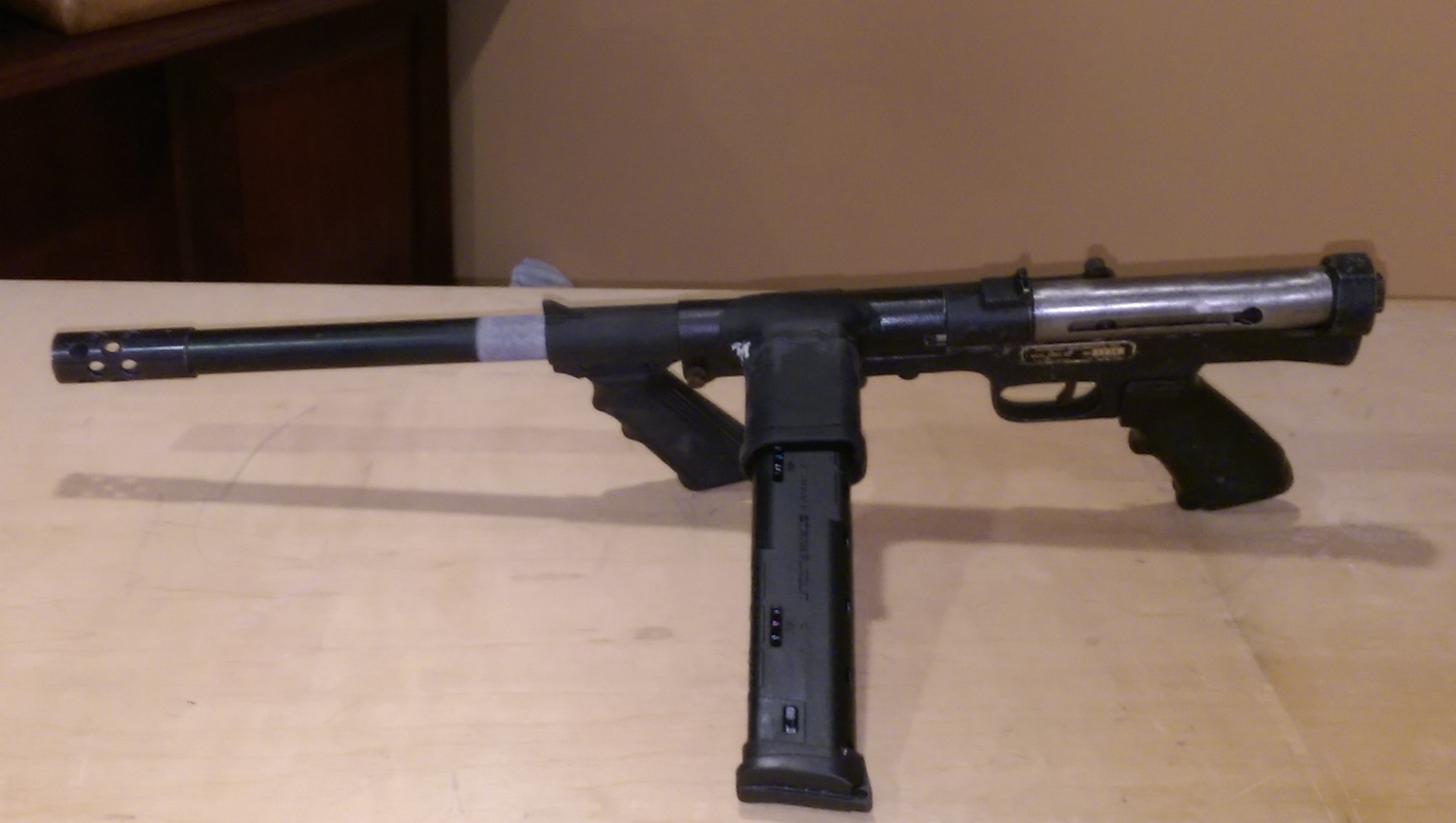

            Tippmann 98 is the easiest platform to maintain. Carbine and Pro light may be more difficult to find parts. Properly cut and fitted for DMag or Helix mags will give you a variety of options. Mag wells from MCS make a fast, durable, affordable and easy conversion. Attached are some of the conversions, and a pic of the 98 cut for a bottom feed mag well.
              Try these for a 98 mag fed system
                Those all look like they were a whole lot of fun to doctor up! A 98 seems to be the way to go. How does the 98 perform with First Strikes? Any gut swapping recs? I'd assume the stock front bolt doesn't play as nice with First Strike as it does roundball.

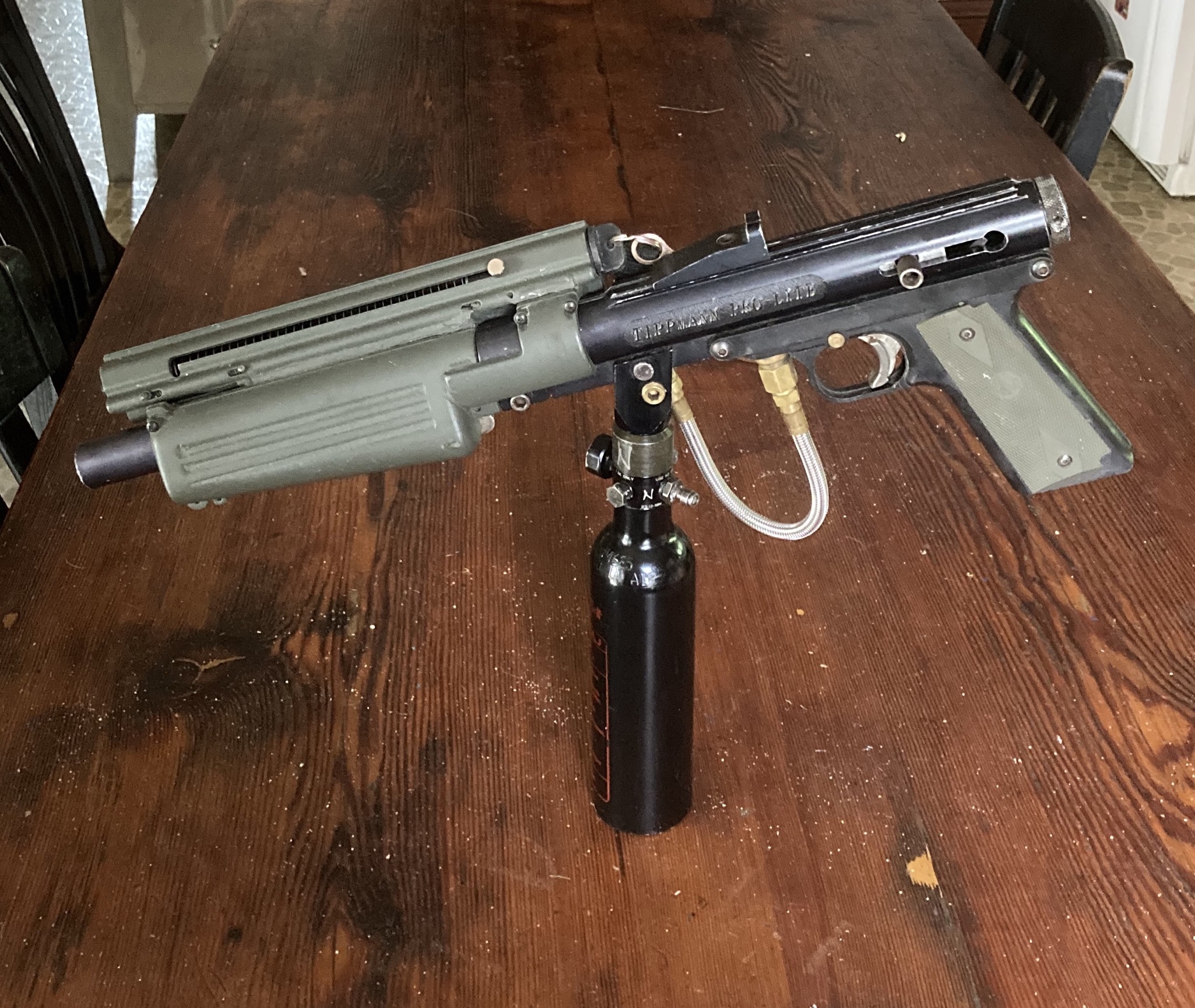

                      Not my idea, but I modified a empire spring feed to fit on a carbine/pro lite foregrip. There was a user here and on YouTube that originally made on for his. Haven't used it much since mainly playing stock class, but it was my first exposure to limited paint. Really neat being able to just switch foregrips and got from running a hopper to tubes!

                        Grabbed a 98 to start this whole project. Thanks for the feedback everyone, it's been appreciated. I'll post it up when I'm done with it!

                            You can simply 3d print magwells for the 98 if you aren't picky on mag location.
                            This thing was made with Tinkercad. Edit it online https://www.tinkercad.com/things/7lveKaFveQrI printed a few out on a Makerbot Replicaton 2
