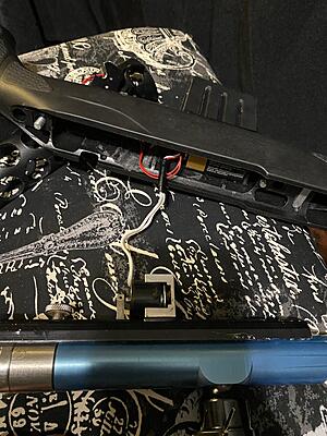

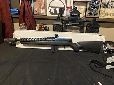

    So let me start by saying this is a full parts bin build, except the stock.. I found this Tikka 3 Ruger stock at a pawn shop for 25$. I've always wanted to do a rifle build.
    I had a ule mag body with a lvl10 classic valve and inception Stella barrel laying around.

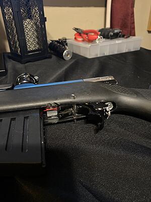

    Originally I fit the marker into the stock and then I poorly rigged a trigger from a 98 custom to the sear. That wasn't enough though.. so I tore some electronics from an azodin blitz I had kicking around. I jb welded a clapper housing to the rail right in front of the sear, and cut up a chewed up booyah frame for my trigger switch. I mounted the board and battery inside this fake magazine from an alpha salvo. So far I've only dry fired (going to get air today to put paint thru) and it rips!

    Oh fun. That mag body sits in that stock well.

      make sure you add a spacer under that field strip screw to get the proper tension on the valve.

        i did not think of that, thanks man!

      That's sick! Are you considering a spring feed?

        not on this marker.. I do have some limited ammo builds, but this one shoots pretty quickly, going to leave it hopper fed.

      Wow That’s wicked nice

        clever use of that clapper noid!
