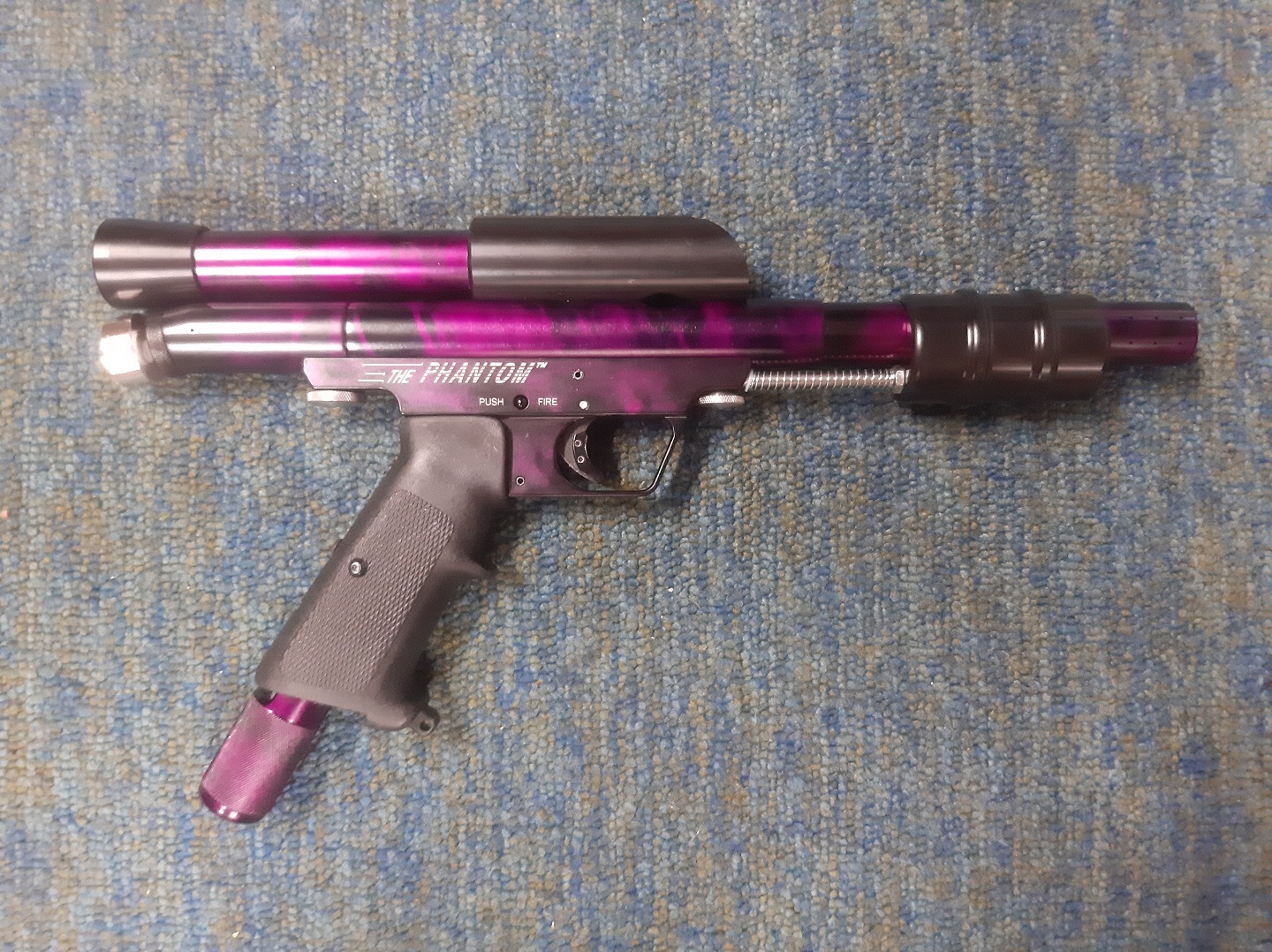

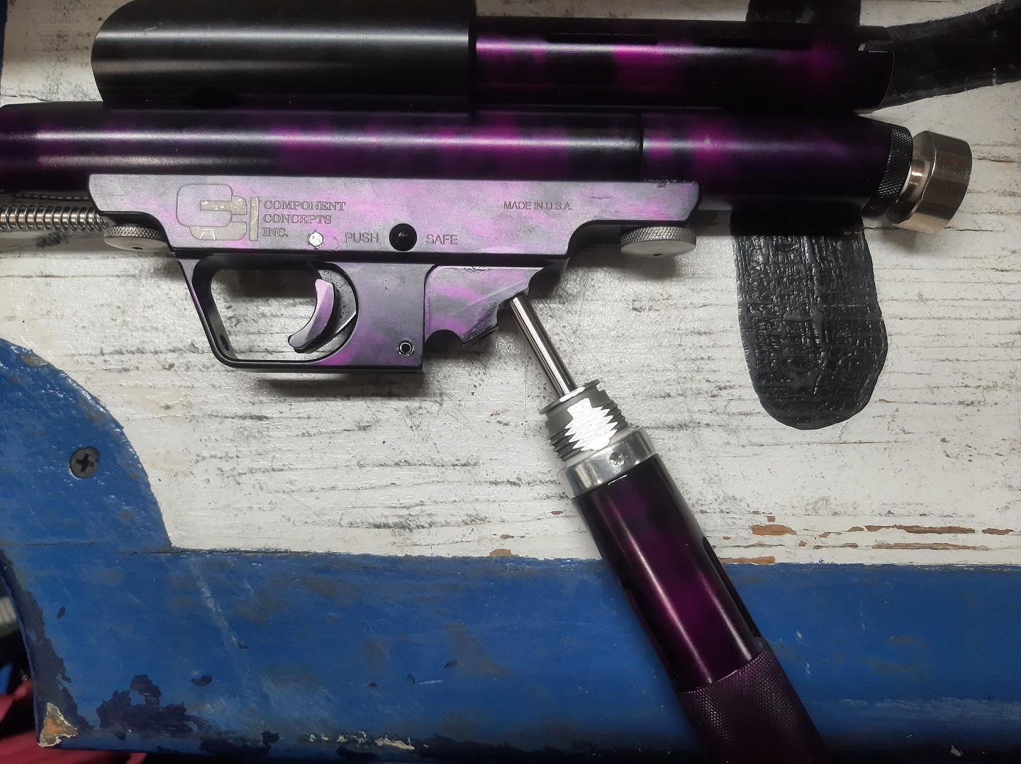

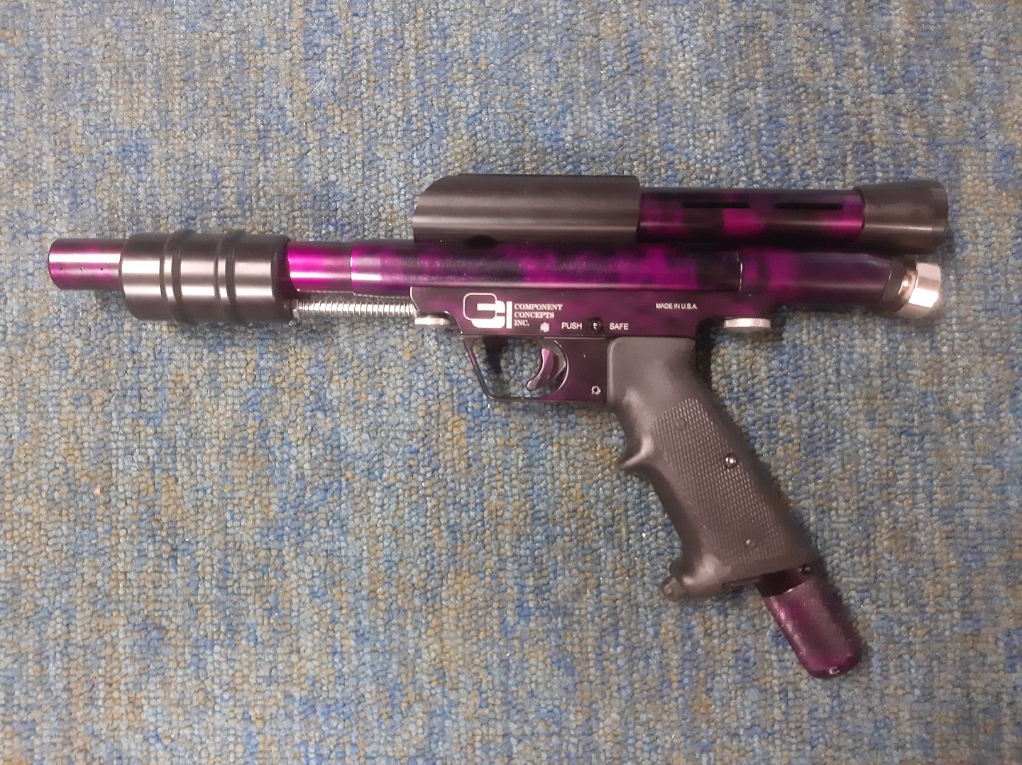

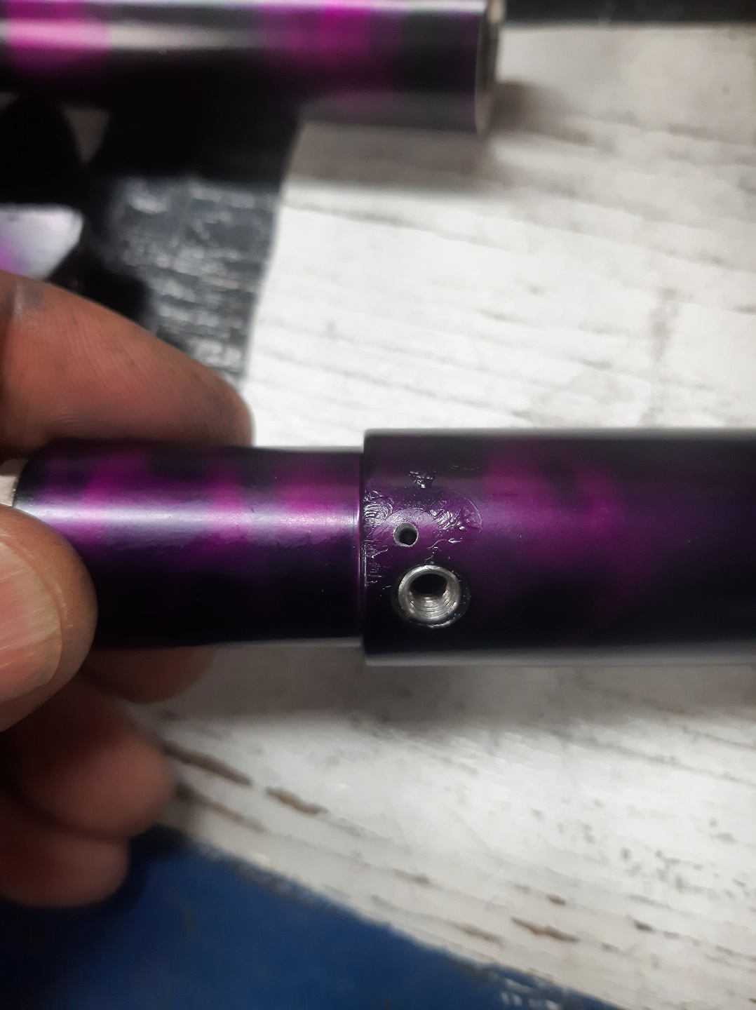

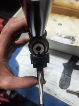

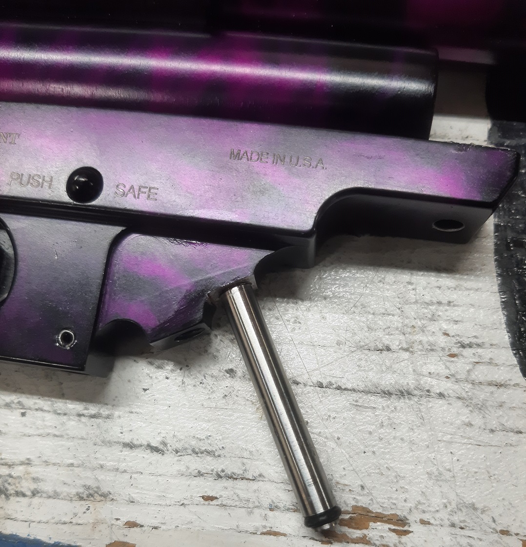

    Always wanted to do a Phantom with the air passageway drilled thru the frame. Took me a few years to get it done(right) p9.jpg p91.jpg p4.jpg p5.jpg p8.jpg

    Thanks to mark for making the transfer tube.

              Sorry way to easy to mess up. I do all my work with hand tools and messed up on the first frame when i broke into the sear area and it leaked.

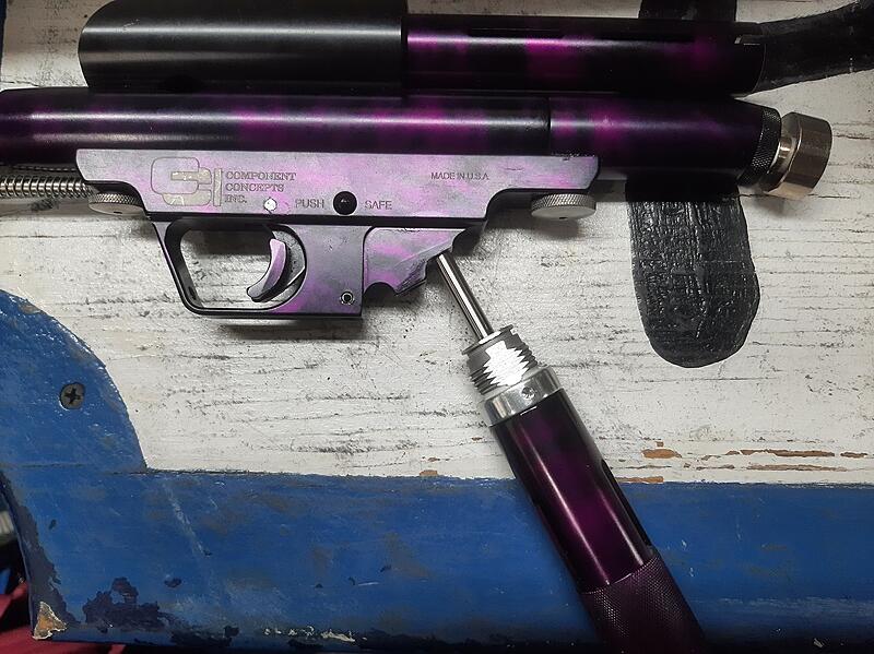

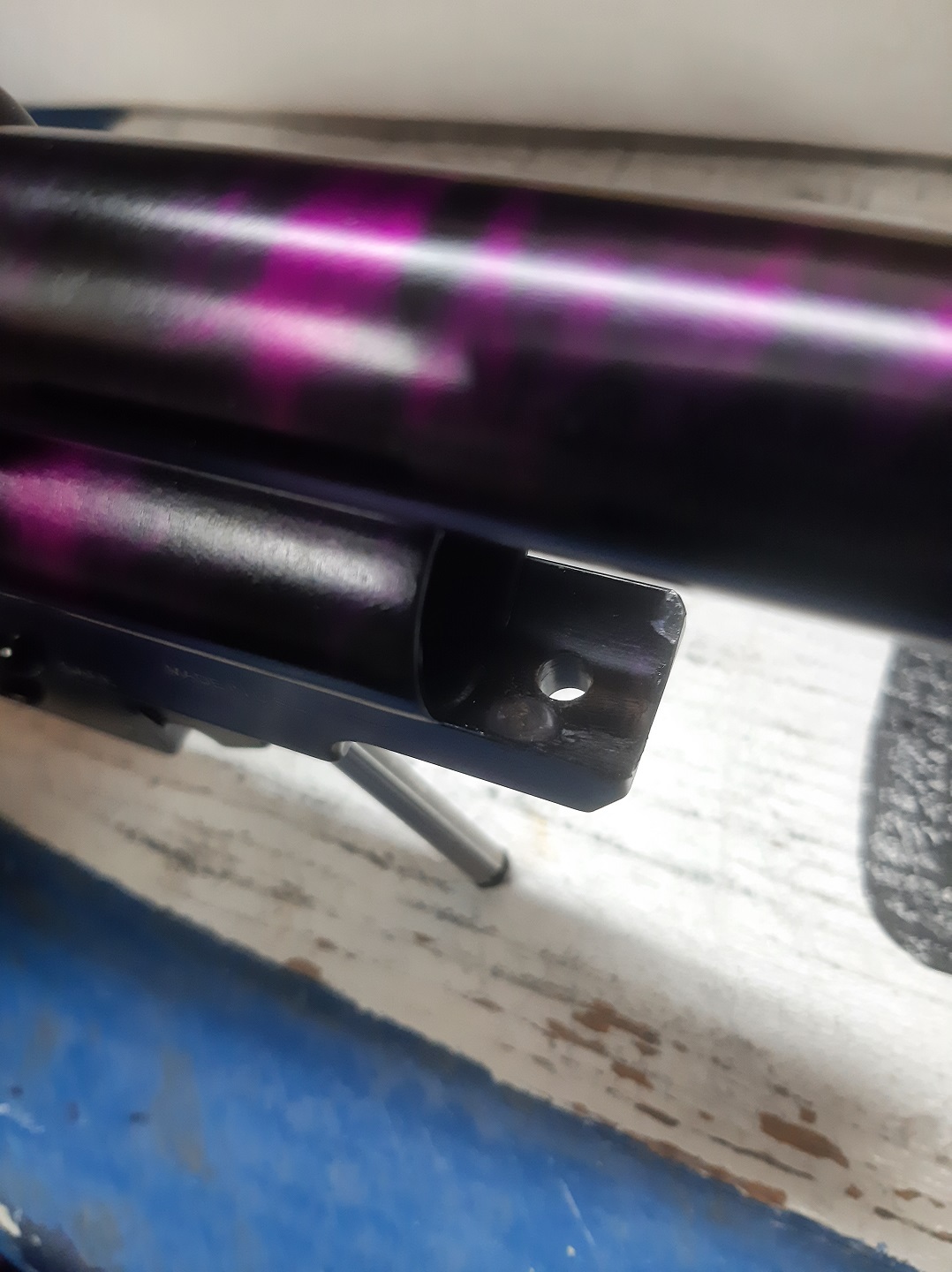

                  Any chance we could see the top of the frame, to see how the airport is setup?
                  Feedback: https://www.mcarterbrown.com/forum/b...pec-s-feedback
                  • capitalpaintball
                    capitalpaintball commented
                    if you look at the 3rd photo, you can (barely) see the oring in the transfer hole next to the hole for the rear screw. I had a clear urethane oring in there at the time of the photo.
                    there is a hole drilled in from the back, that is then plugged with a grub screw
