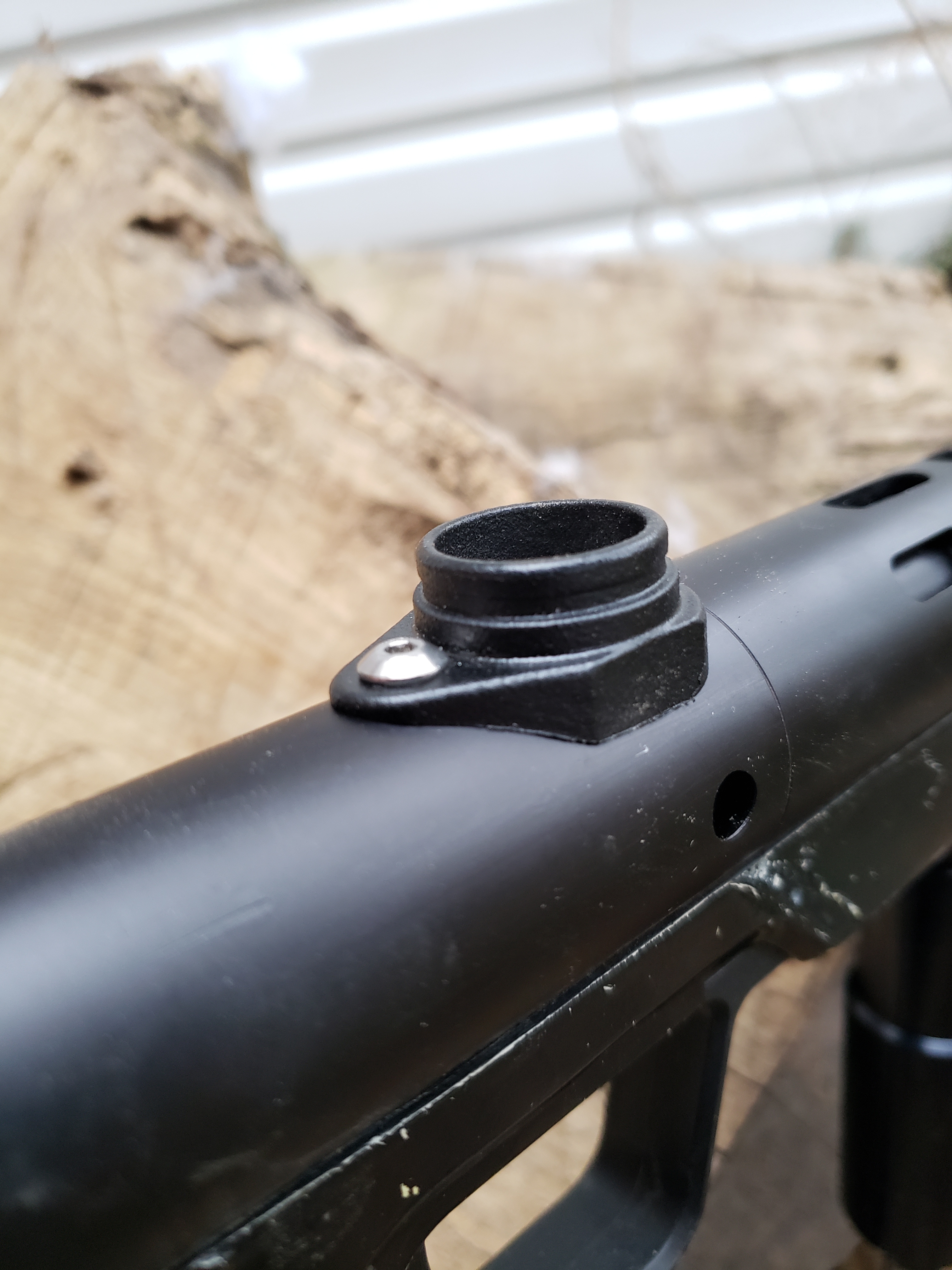

          It's actually going on an Enmey body, so I've drilled/tapped the body already.
          Like so...

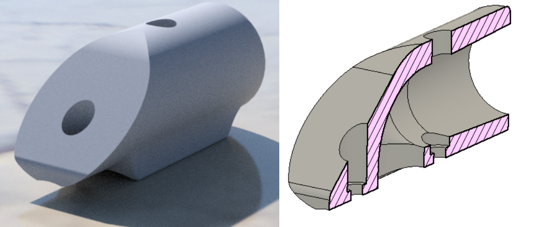

          The Ion body i have measures out at 1.225" diameter.
          Here it is altered, and screw holes on both sides of the feed hole so you could mount it either direction. I could delete one of the holes if you'd rather it only mount one way or the other.

            That's perfect! That way I can run rock back or forward.
            The plan is to have it convertible, so I can run SC or OC. Ed Peterson is doing one last pump Ion run that I managed to get in on, and I though a SC Ion build with an Enmey body (so it's BOB) would be pretty cool, but the Phantom feedblock won't fit correctly, so getting one made to fit is going to be amazing.

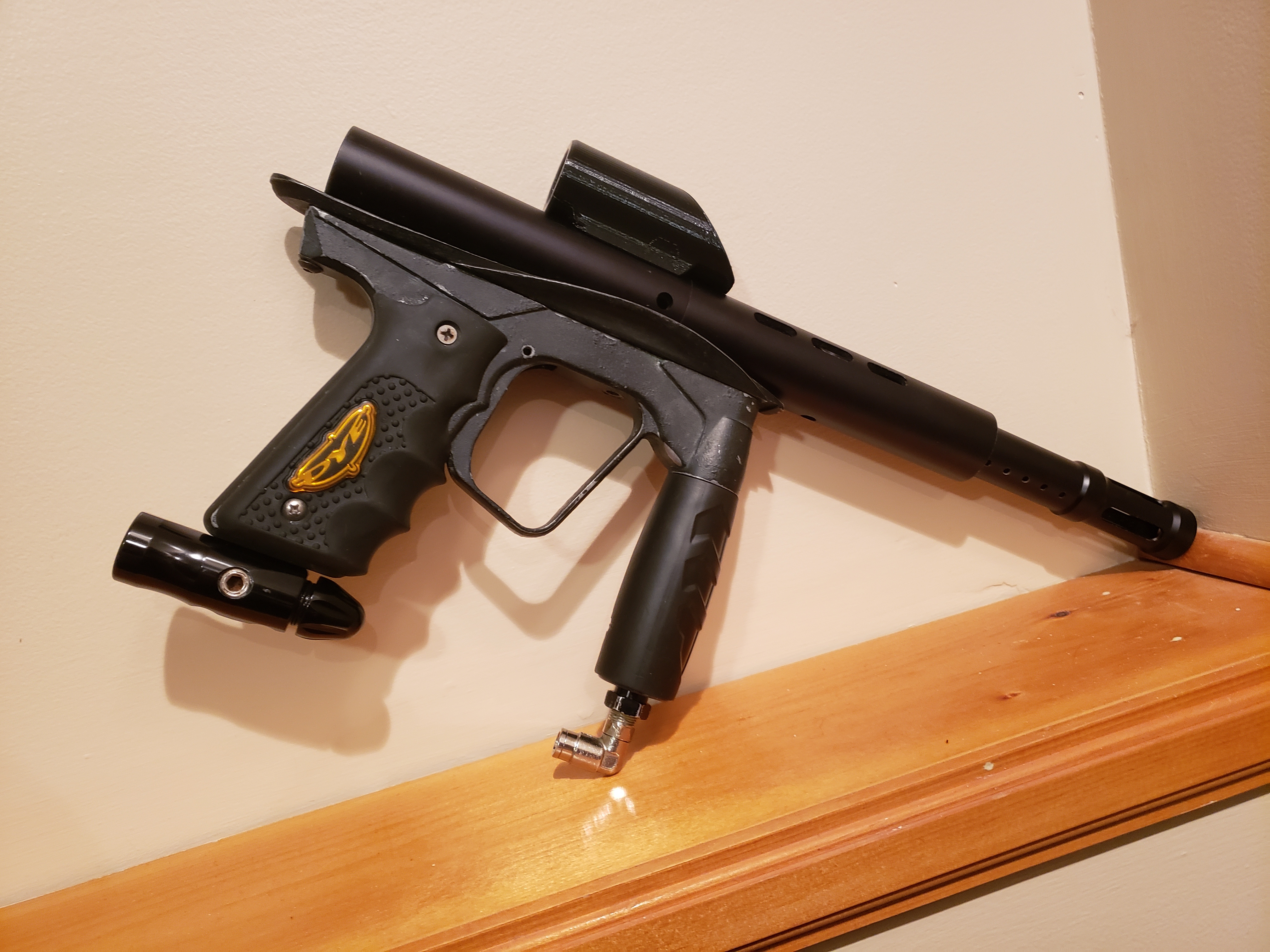

                I'm still waiting to hear from Ed on when to send the frame for conversion, so I started piecing together some parts to get an idea on what I'm going to use.
                So far, I've got an SP1 body, cut down Epiphany shell, an Ion frame, and the feedblock Rainmaker whipped up for me.
                Still a ways to go, but it's starting to come together.

                  Not a huge update, but I finally got my Phantom feedtube from CCI, and then found the feedblock back after digging for a while. šŸ™‚
                  Here's a mockup of the body. I'm thinking of modifying an Ion body to fit the SP1 firing can instead of making detent covers, we'll see.

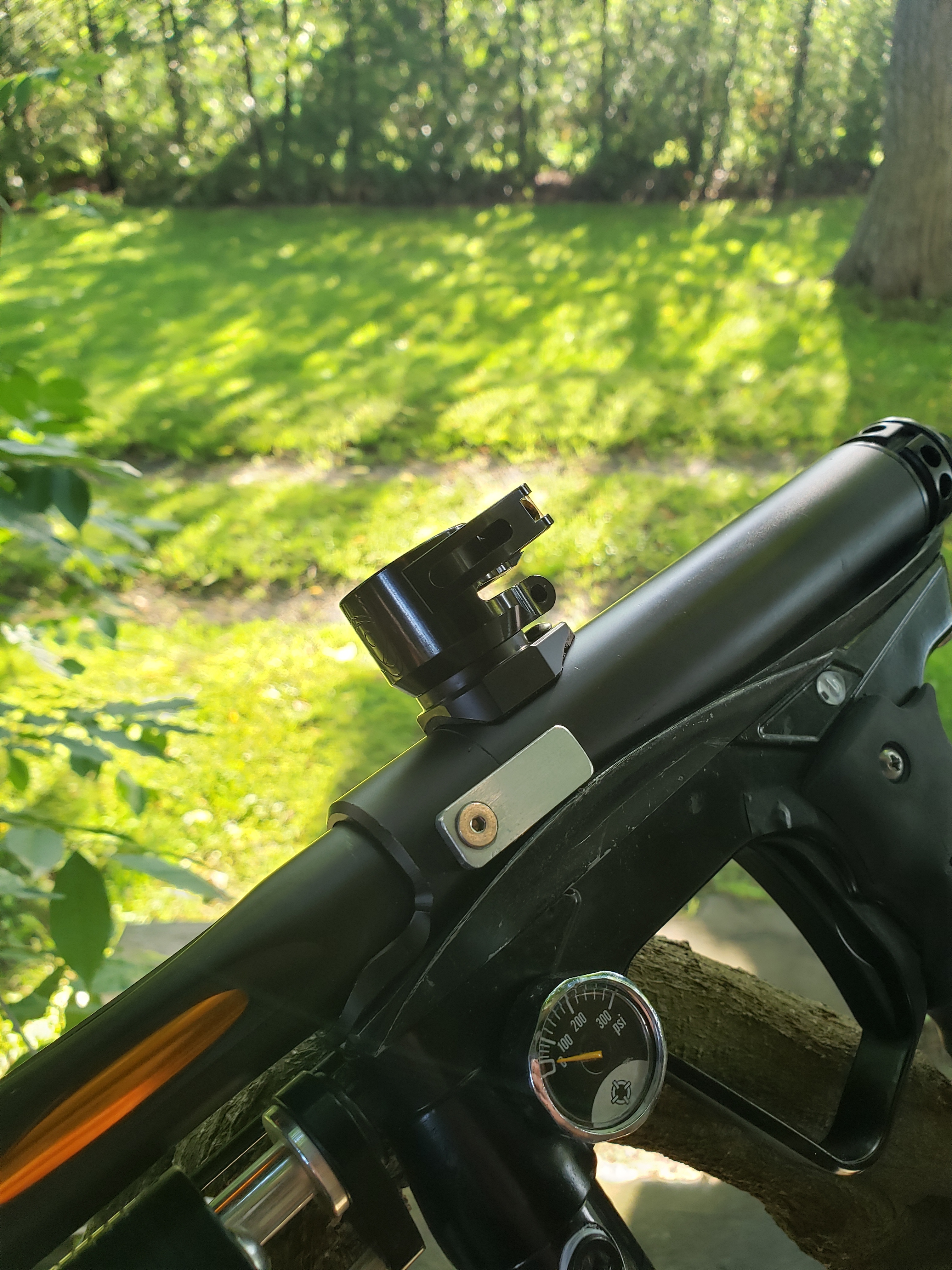

                    Final update - I finally got the drive to finish up this project.
                    The plan was to use a SP1 firing can but it interferes with the pump handle, so I ended up going with the Enmey can and used a modified Epiphany body shell as a base. I had to make detent covers as well.
                    Looking forward to using it, though.
                    Rainmaker's feedblock fit perfect, too... thanks again!

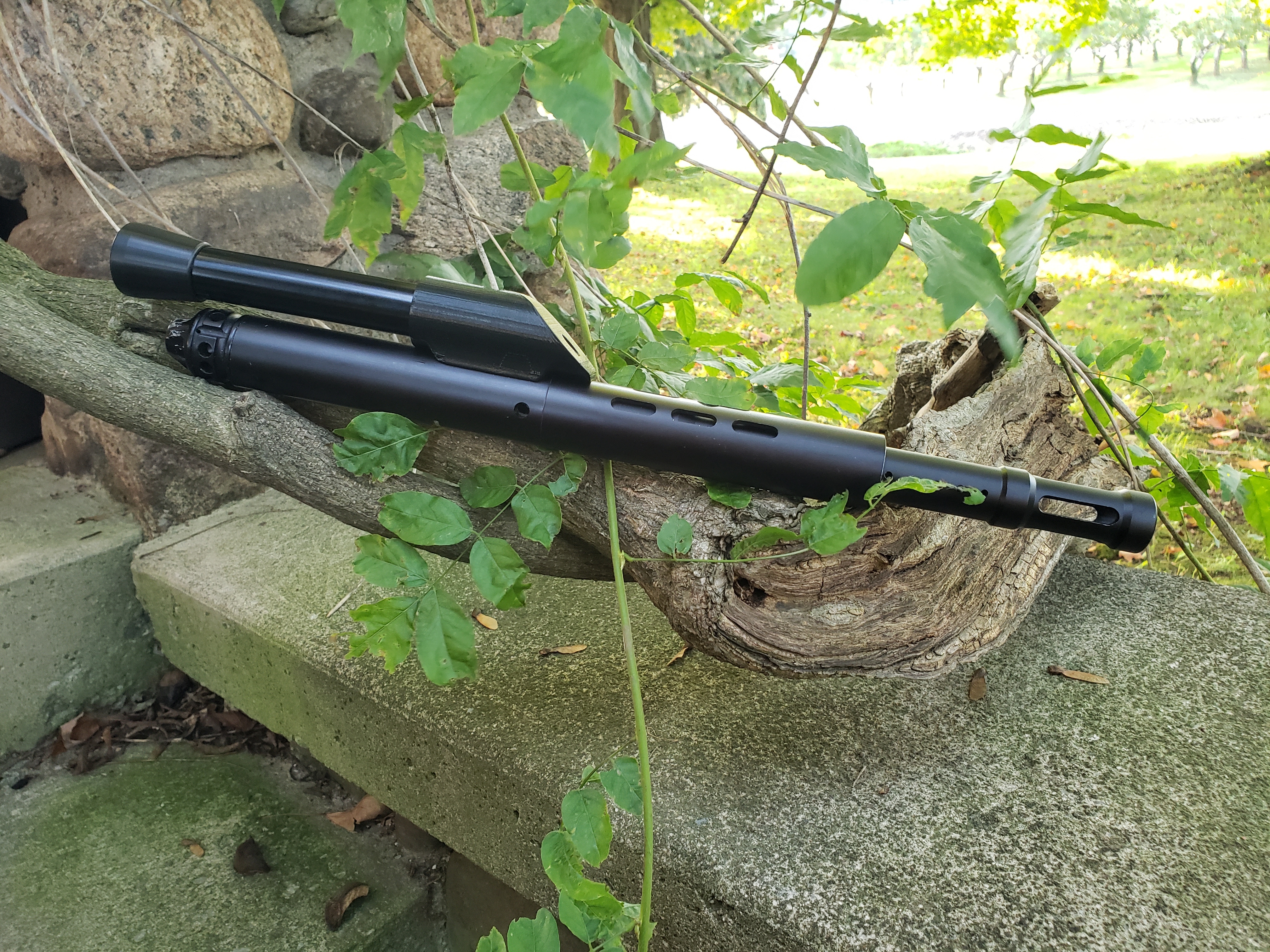

                      Final final update:
                      Got a chance to use this in a SC/magfed game and it was a blast. I do, however, want to be able to use it as an open class pump from time to time, so I picked up one of the CCI/Empire feednecks that Flyweightnate had made... got it today and after a bit of consideration figured out how I'd compensate for the larger OD of the body I'm using (compared to a Phantom).
                      Here it is, installed, with an ID feedneck.
                      I want to get a new tray printed for it so I can ditch the cut down Epiphany body, but otherwise I think I'm done. Maybe. šŸ™‚
