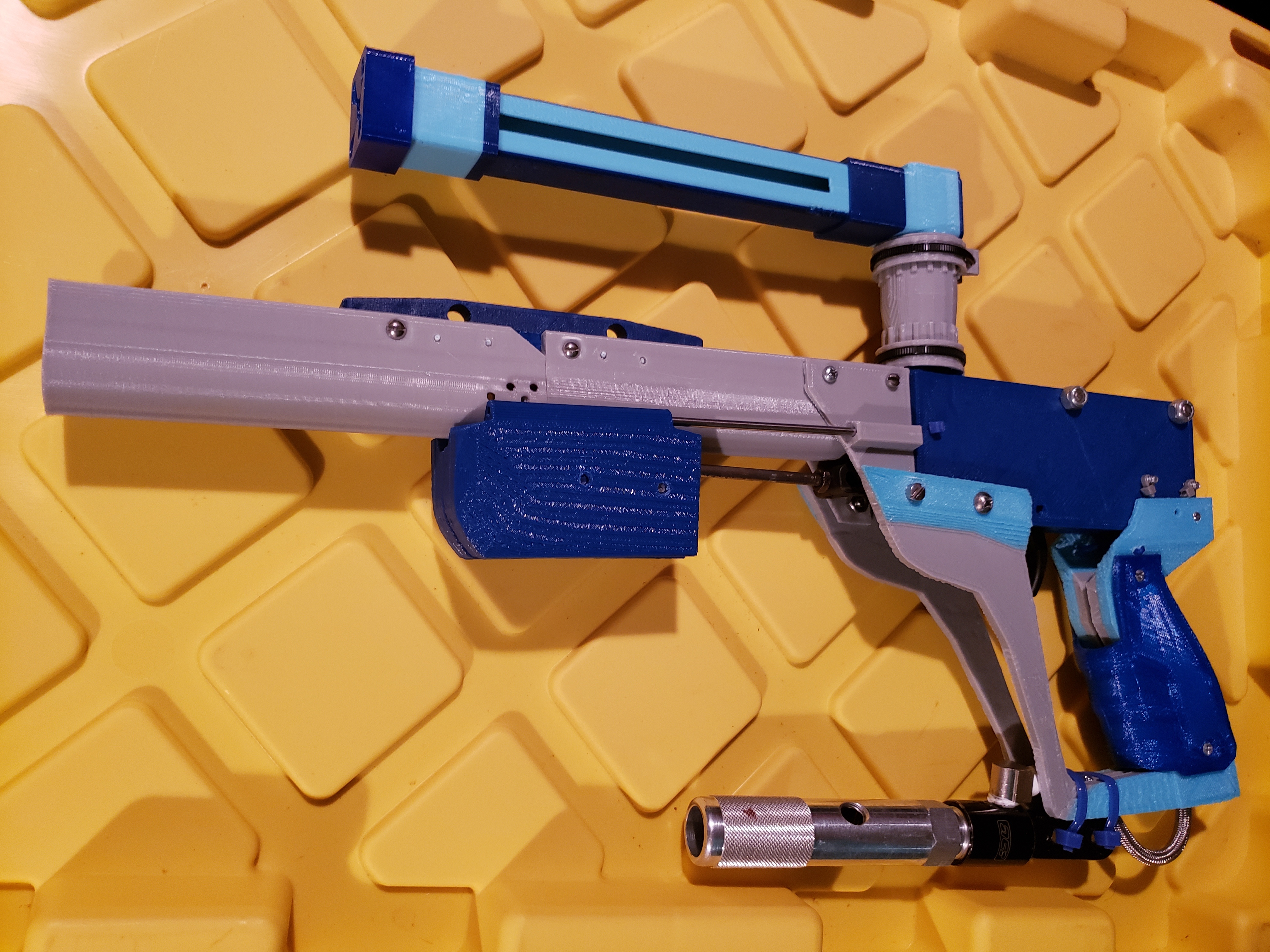

    JTER2 "MakoShark" Project

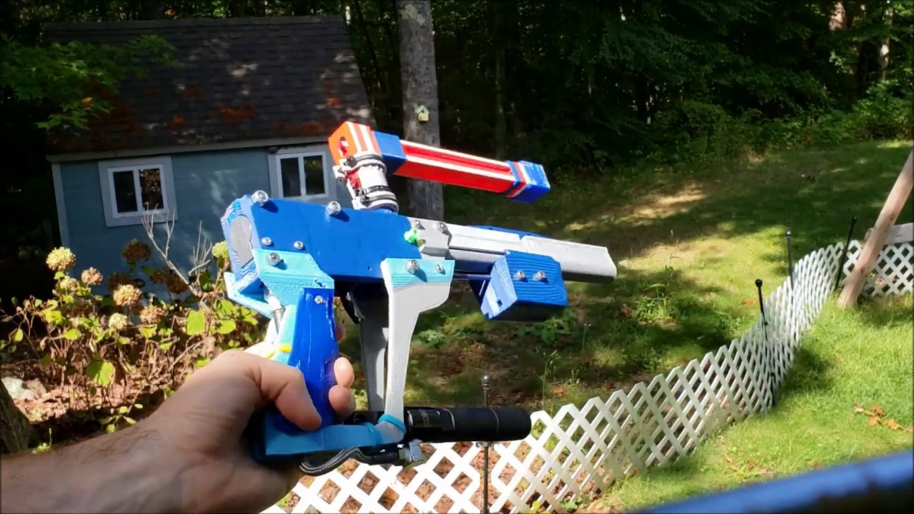

    (Bringing this thread back from the dead to motivate myself to do another iteration of this project.)
    Click image for larger version  Name:	makoshark_R.jpg Views:	16 Size:	5.41 MB ID:	115149
    This project started years ago, the initial idea being to design bolt-on printed parts that would make a "Walmart Special" JT-ER2 usable at a field and save it from adding to the landfills.
    That first iteration (using SketchUp at the time) was also infused with some Boderlands video game fun for fun's sake.

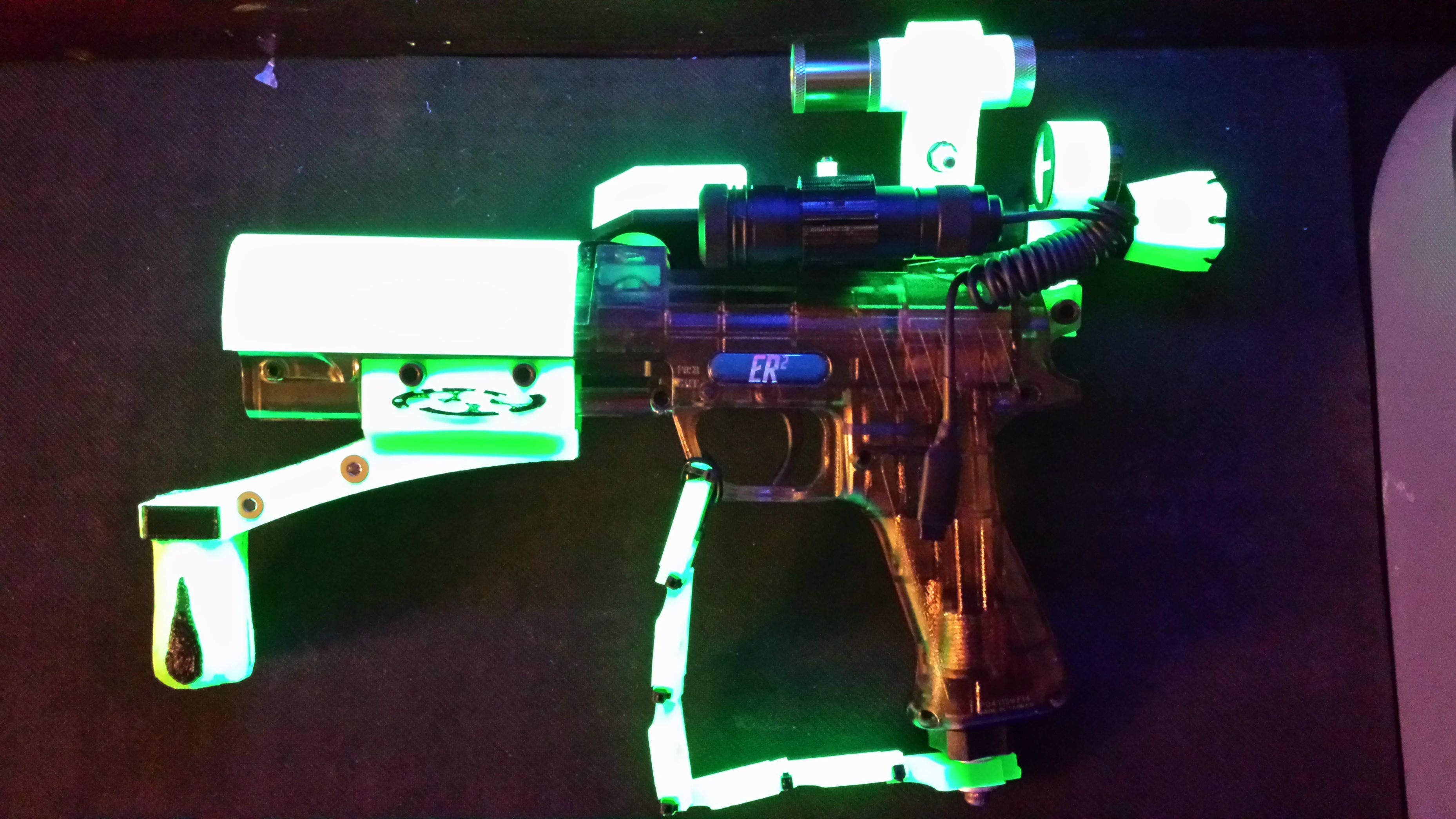

    Click image for larger version  Name:	JT-ER2_Torton.jpg Views:	15 Size:	601.7 KB ID:	115151

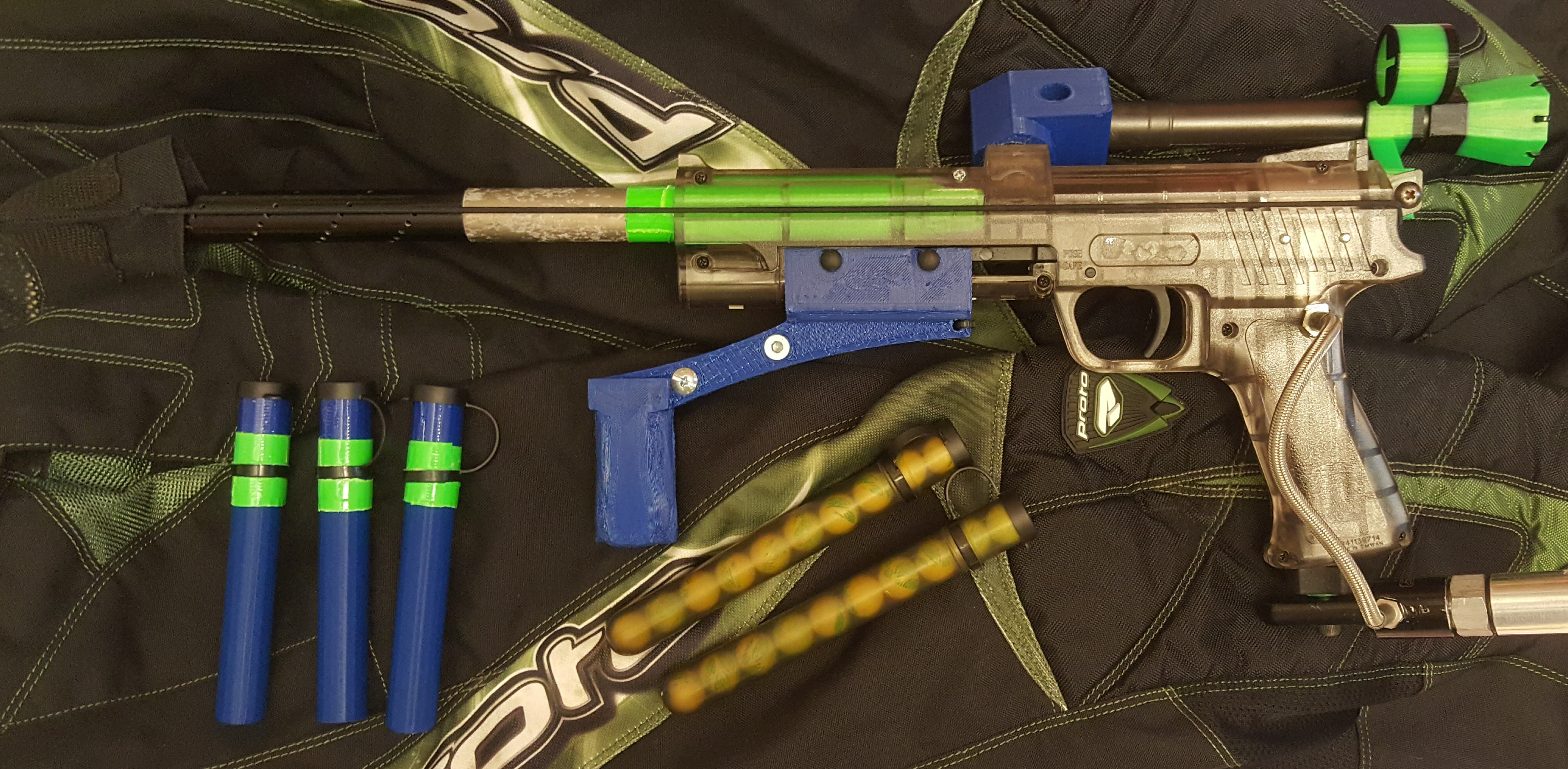

    ^ This nonsense was tested (without LASER/Flashlight) at MVP in NH and the pump handle/horizontal tube feed/speed loader/CO2 cap chain absolutely made the ER2 usable against field rentals and speedballers alike. One electro wielding opponent took a ball to the "ball" in a 1-for-1 moment... I apologized after but he wasn't even remotely upset because I "did it with that thing".
    <<3D Printer files for these parts>>

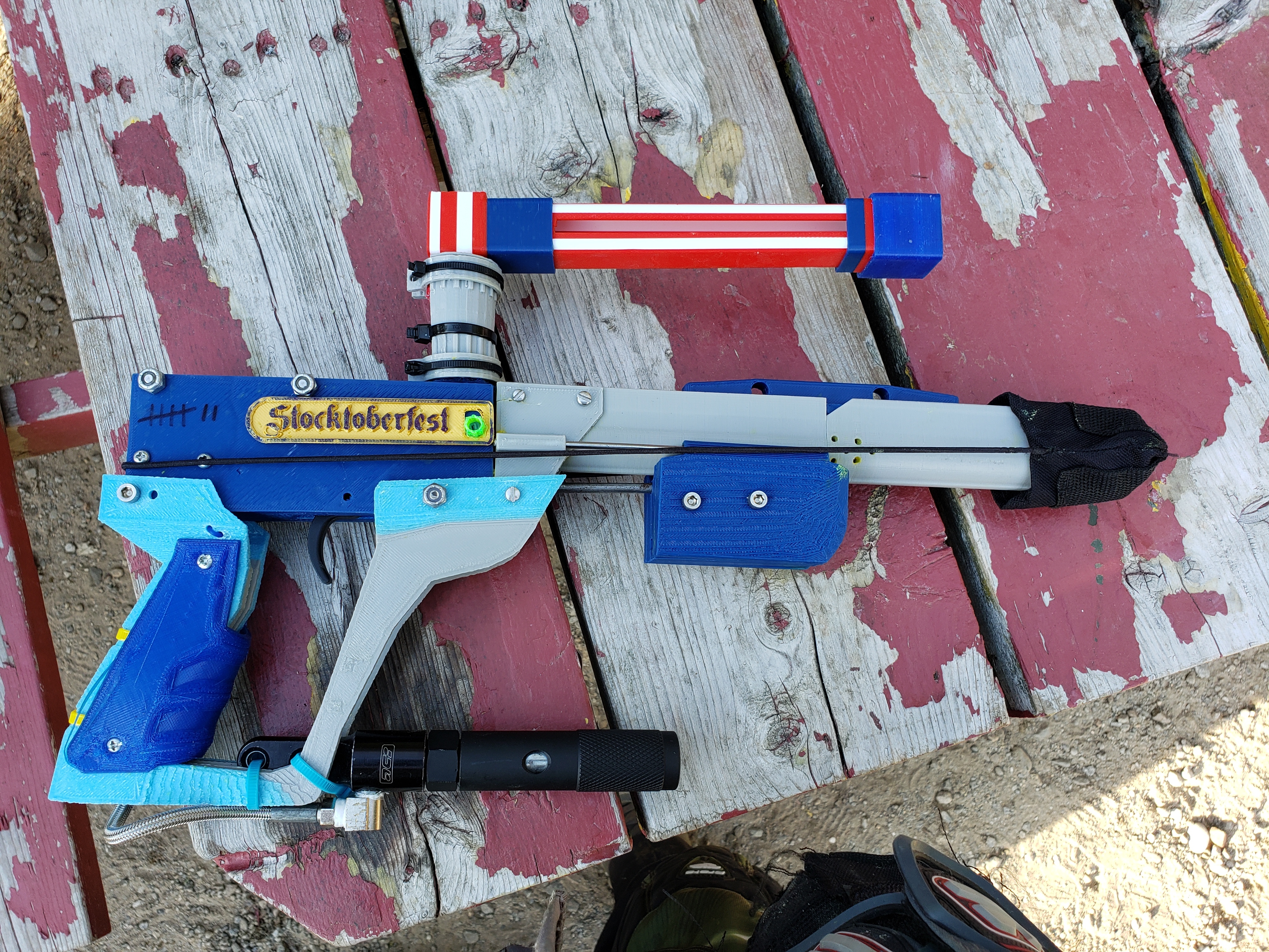

    Click image for larger version  Name:	StockER2.jpg Views:	15 Size:	1.17 MB ID:	115152
    ^ Another iteration was tested at a Slim's Stocktoberfest with a non-printed AA barrel mod. This thing performed WAY better than it should have and judging by the passive aggressive comments from the passer-by speedball kids at the field..... confused the hell out of people.
    That version was enough fun that I decided to throw the time at a fully printed body kit designed for the JT-ER2. I started with this Spyder barrel thread adapter as a scale reference and designed everything around its dimensions.
    << Deifox's JT-ER2 upgrade 3D Printer files>>

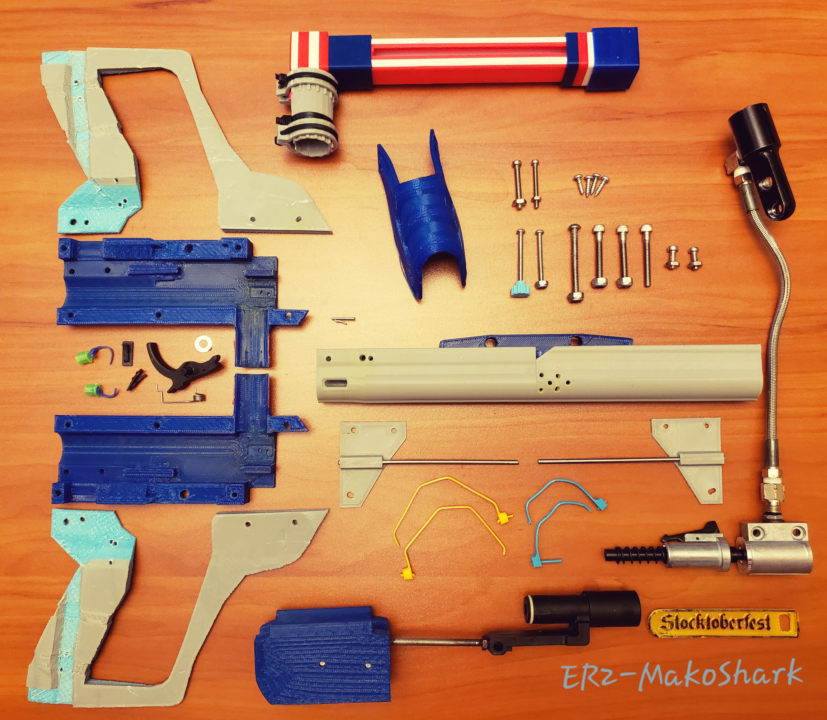

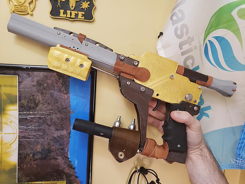

    Click image for larger version  Name:	Makoshark_parts_set.jpg Views:	15 Size:	2.74 MB ID:	115150
    ^ Errant parts include a Phantom pump rod, a chopped VM-68 spring donated by MCB member Chaos and an actual 3D Printer spare part (hollow threaded tube from an extruder had the correct threading to mate the ER2 valve body to a constant air hose). That's bonus MAKER points right there.
    This version was also tested at a Slim's Stocktoberfest over the 2-day event and got enough eliminations to be deemed a success by even the BrassEagle DemiGod itself, I would imagine.
    <<Here is an album of its evolution>>
    Notable Features:
    • All printed parts are sized to fit on a Replicator1 build plate
    • ABS, PLA and old formula NinjaFlex filament used where their properties were appropriate
    • The 2 piece ABS barrel is fully printed and Acetone-Honed
    • NinjaFlex was used in the speed-feed and soft-grip (based on old Dye 45 grip covers)
    • gas-thru grip!

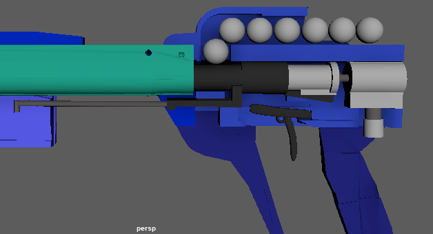

    • Designed in MAYA LT with more of an "eyeballing it" free-form approach rather than a Fusion360 hard-nosed approach.
    • Tried to use Rainmaker's printed detent in the barrel but the stock ones were more reliable. I tried them in ABS but a semi rigid filament would be better. <<Files>>
    • Remixed an existing stick feed and hope to incorporate it into the body/barrel design more in the next version. <<Files>>
    • Complete project files are NOT currently available. I'm still open to collaboration if you don't mind a bit of messy geo in a Maya project.
    Click image for larger version  Name:	XfWWhqw.jpg Views:	15 Size:	3.39 MB ID:	115153
  • Rainmaker

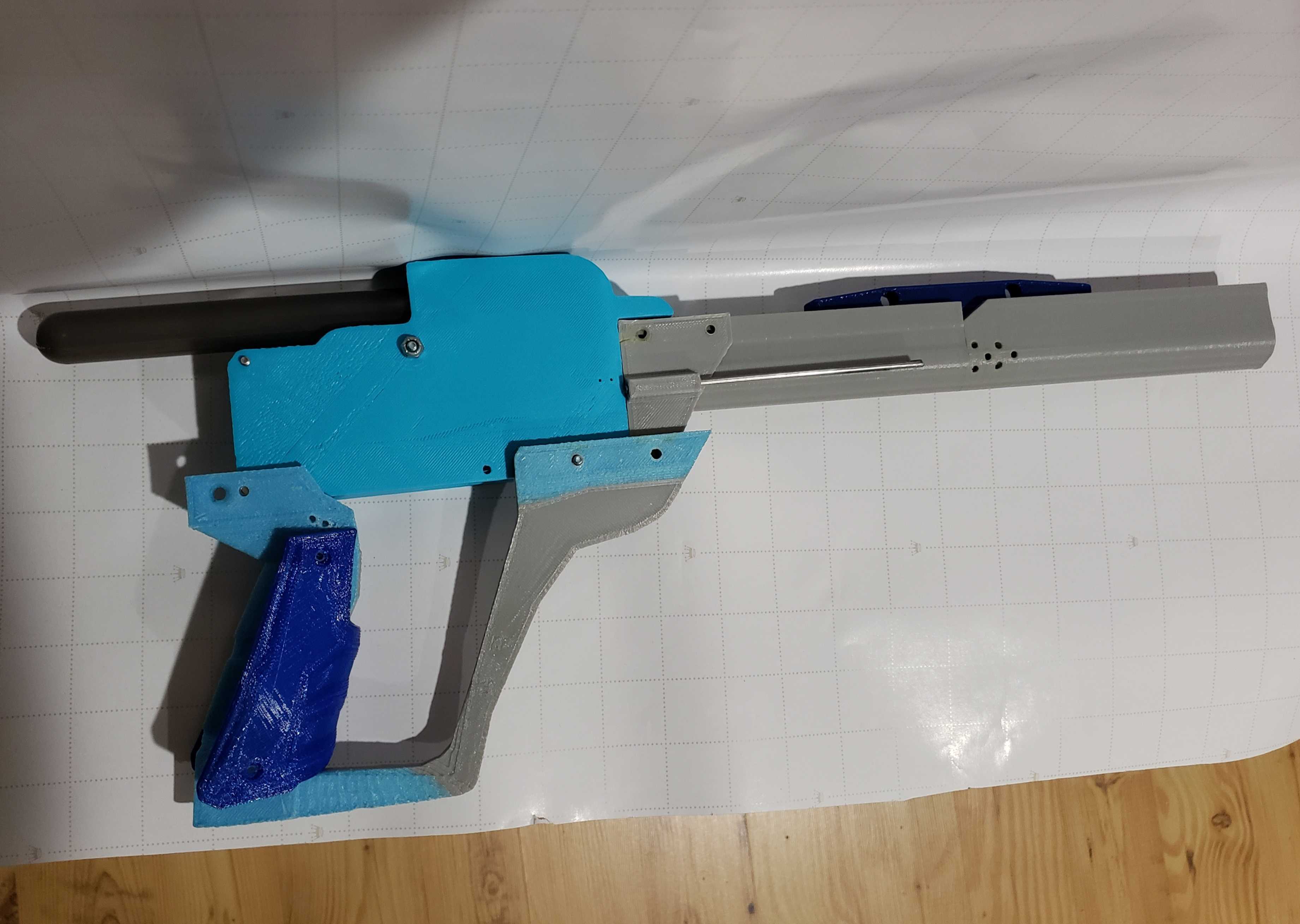

              • AtomJaay
                • 104
                • NH
                It's getting uglier but more effective and fun.

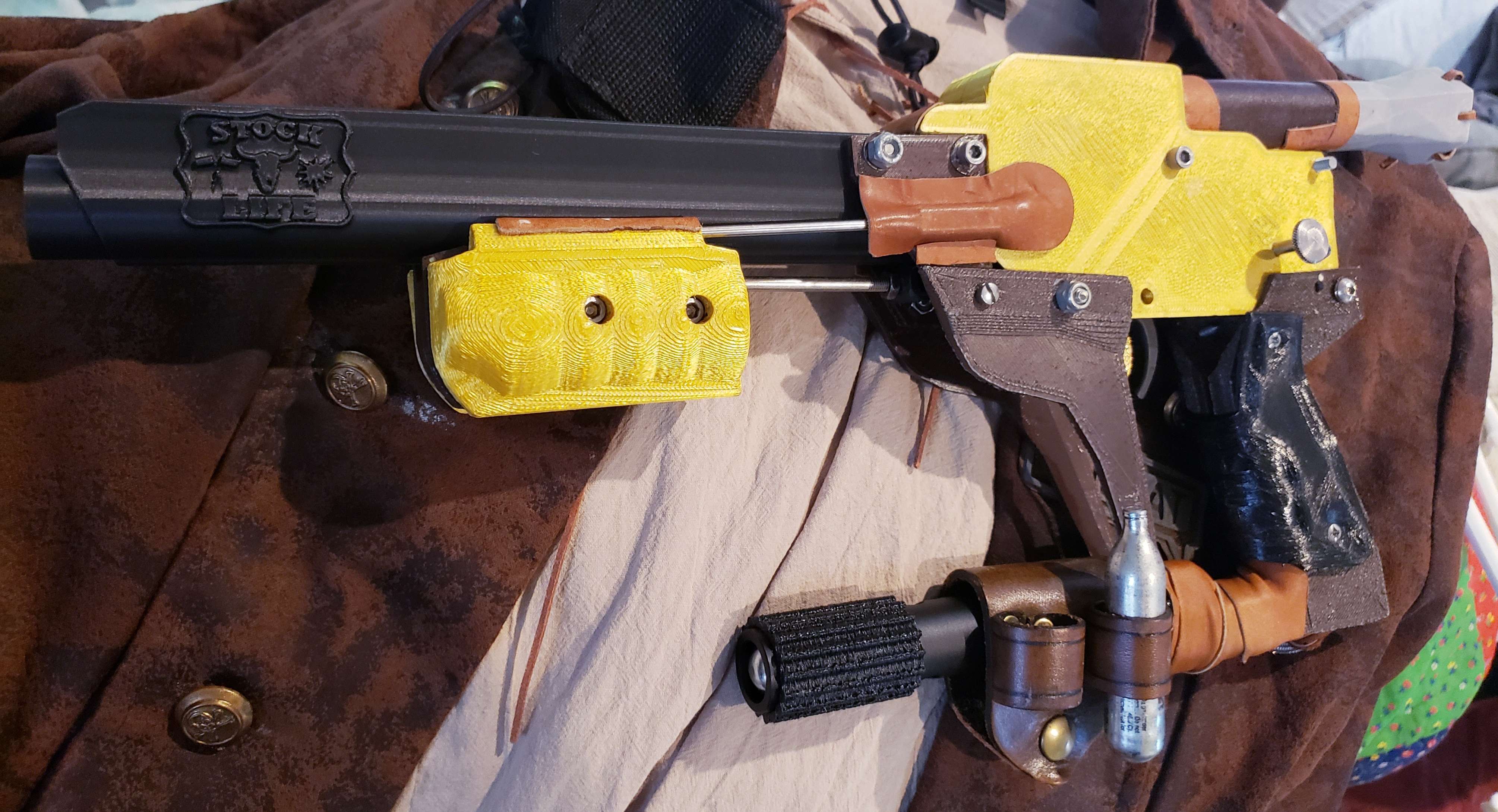

                Prepping for Slim's Western Scenario, messing with the Western theme while listening to messed-with epic Western muzac.

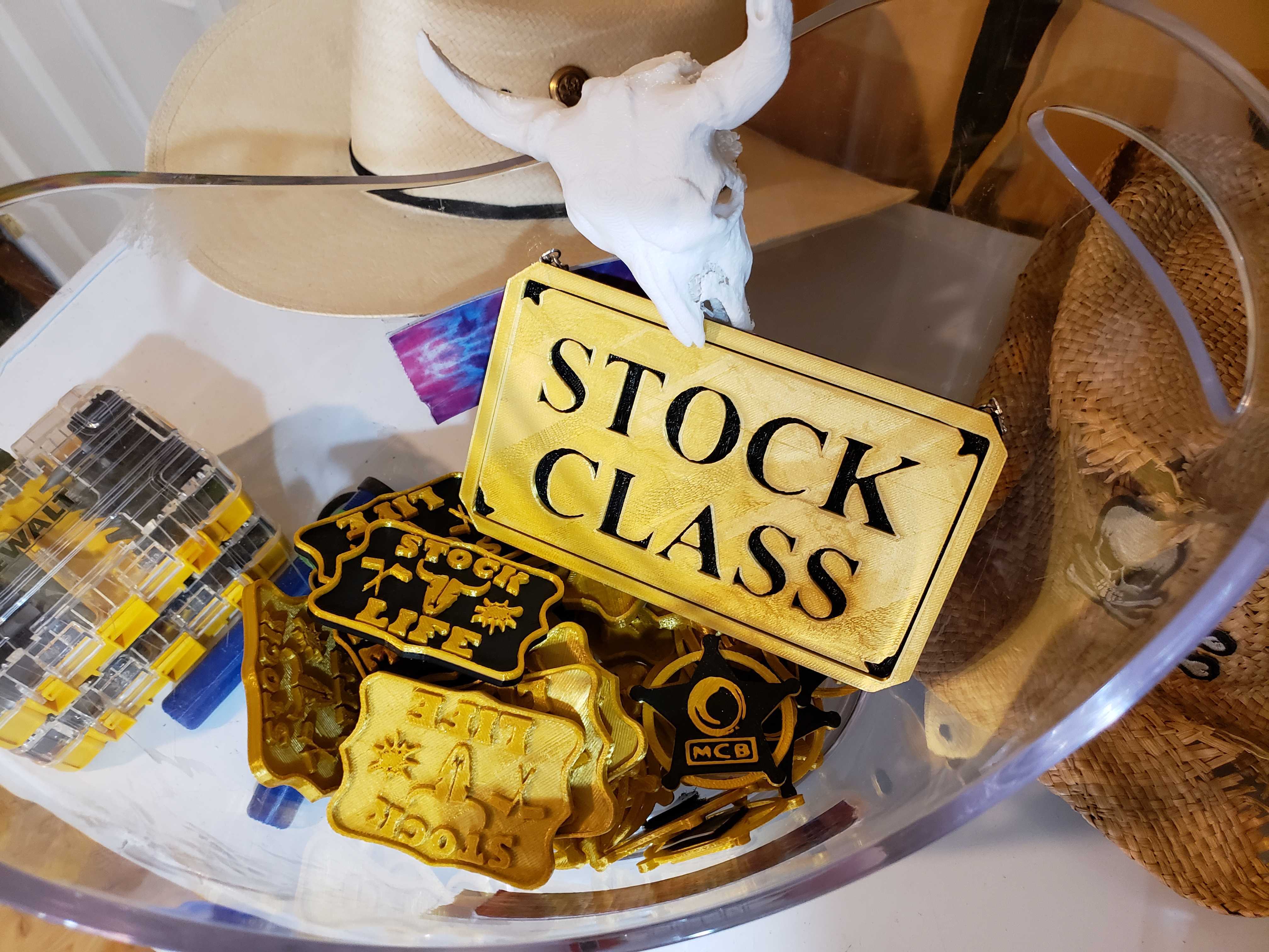

                Made some MCB deputy badges if I go Sheriff and some StockLife belt buckles if I turn Outlaw.

                    Chappy Oh no no no, let me clarify. Whichever side I land on for Slim's Scenario, I will disavow the other side completely and all associated symbolism. No Changing mid event lol.
                    However, I did make enough Bandito and Lawman swag/scenario props for everyone on both sides... i think. Pretty sure I have enough. There are 4 elite versions of each for the shot callers or big big ballers of each side. Or lottery to see who gets em, I have hats to pull from. I dunno.

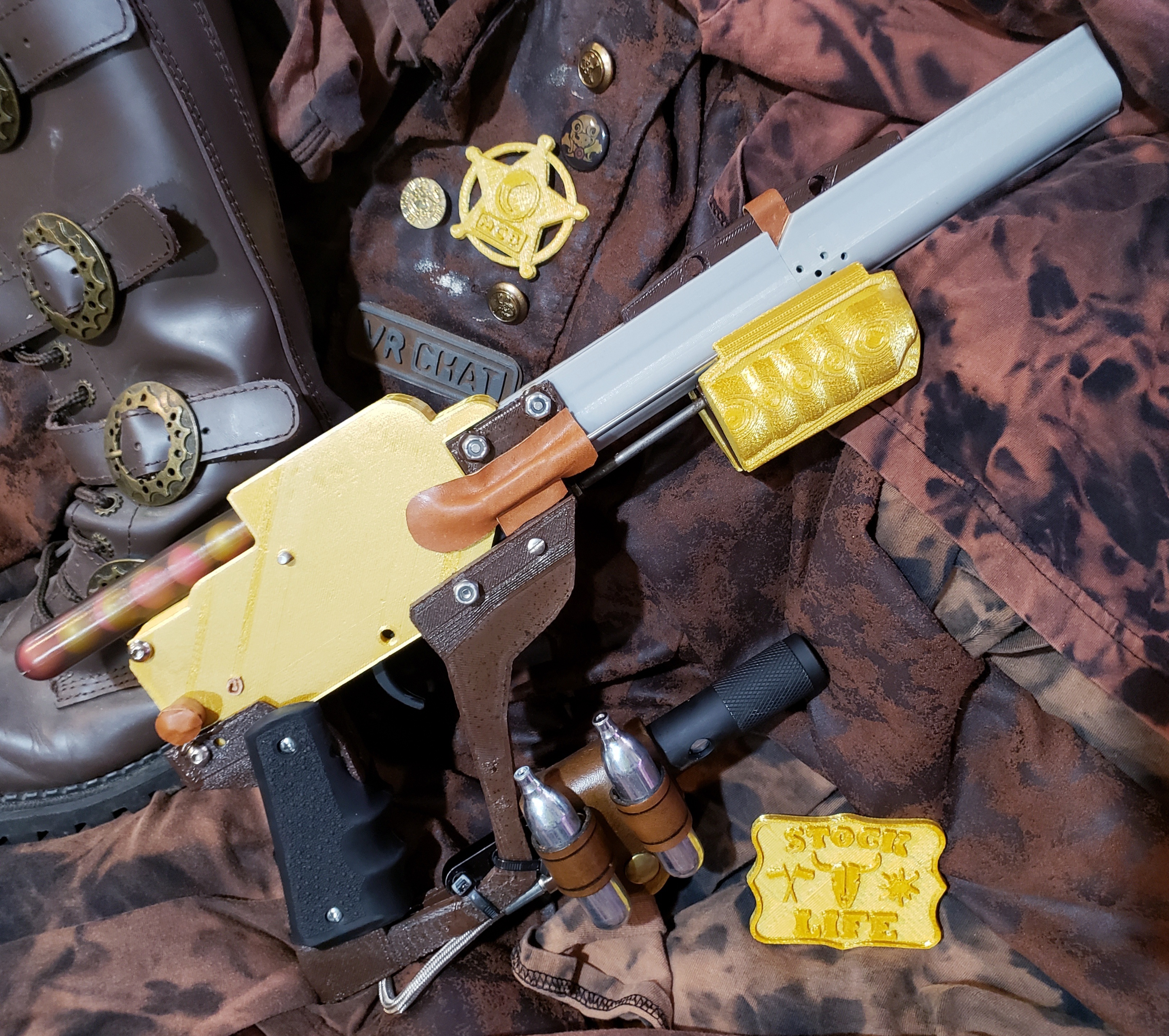

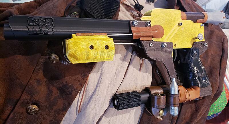

                      Another iteration of the Western MakoShark. The small paint at AG for Slim's spring game prompted me to mod the barrel and add a Freak insert. My velocity was just in the dumps and rollouts were abundant. The barrel is now a bit shorter from some false starts and my refusal to print, sand and acetone-hone another barrel. After screwing things up and hacking off the shame... I ended up using an empty 12 gram (perfect size for a freak insert resizing!), a heat gun and a hobby clamp to create the room I needed to press fit an extra .684 I had. (shoulda went smaller and bought another insert but the OSG paint was pretty perfect fit) I'm now glad I used ~16% infill on the barrel and gave it a larger OD because the inner wall of plastic needed somewhere to go without changing the outer walls of the barrel body. All-in-all it shot really well all day and I ended up using it more than planned as other markers had their own issues.

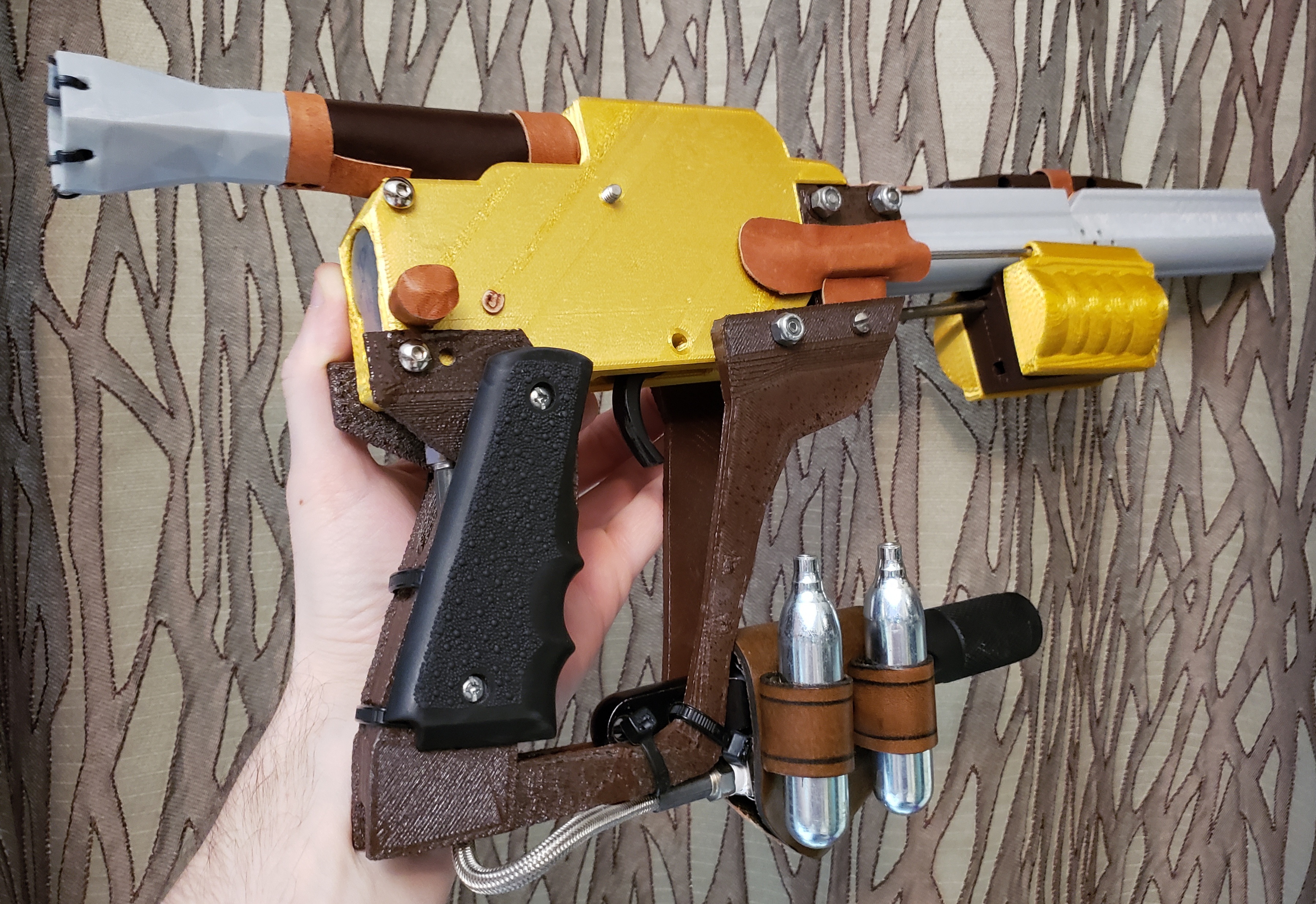

                      Did some "smithing" to the barrel before reprinting in PLA last year and added some flair. This version has a re-ball sized freak insert.
