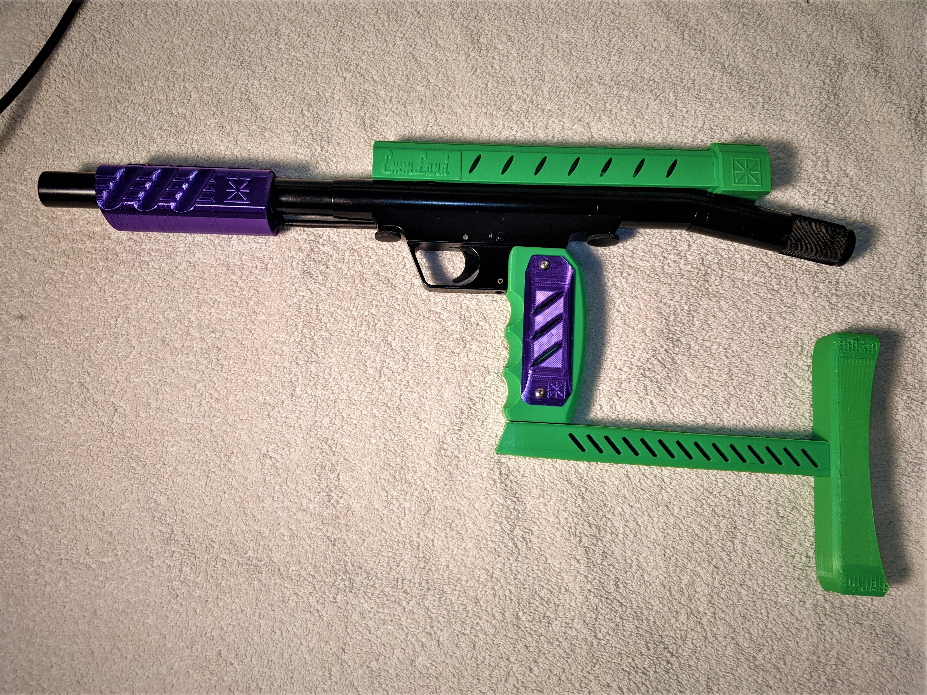

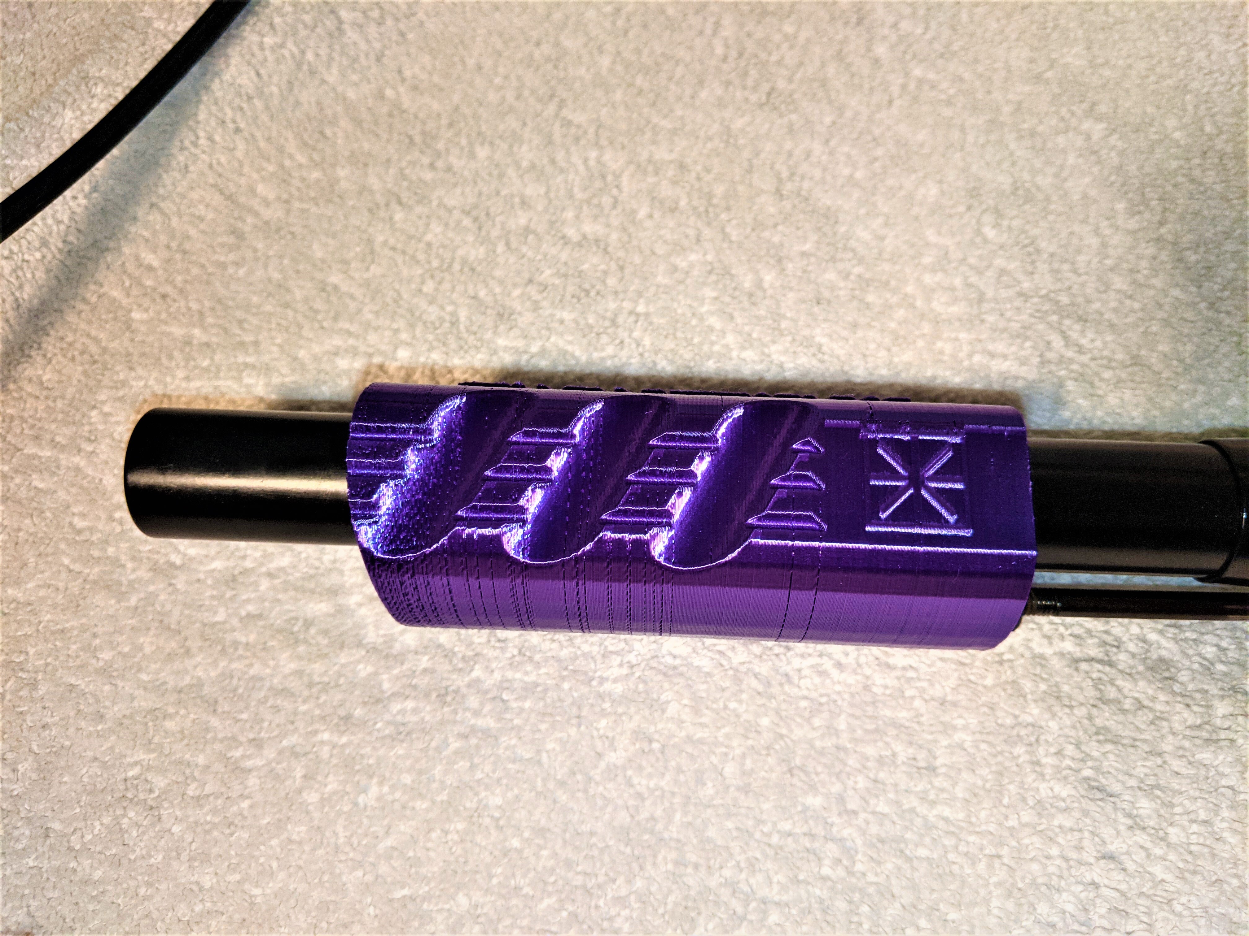

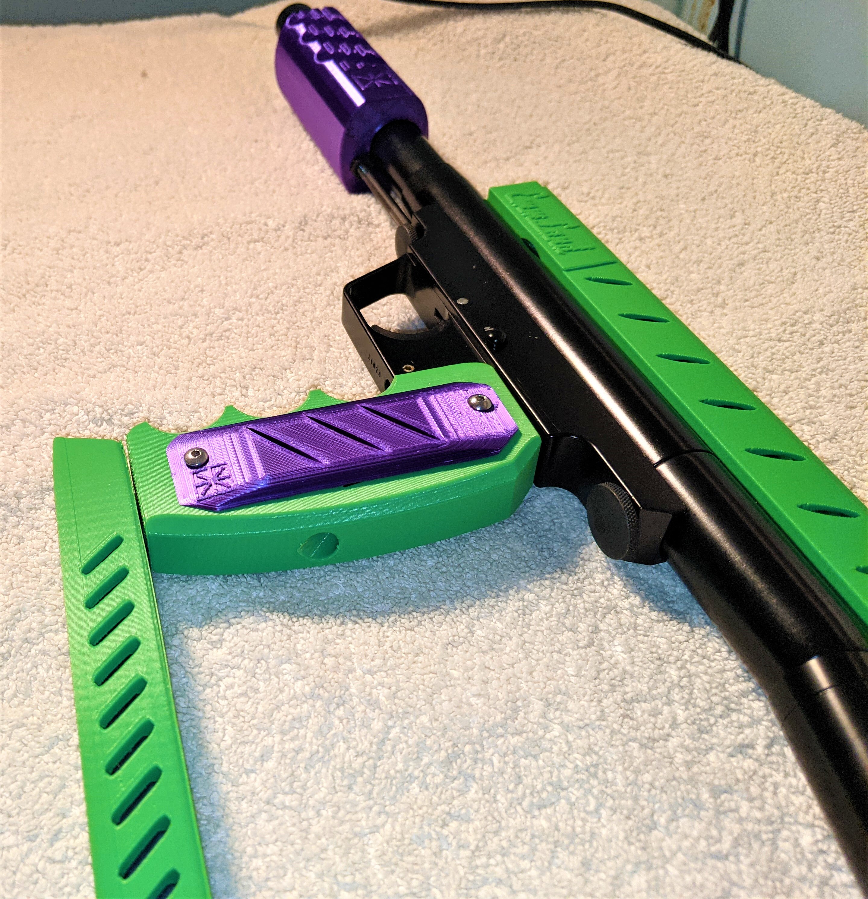

    Everyone always complains about the Phantom being way too heavy. I decided to play around with my printer and see if I could fix that. 😋
    I just did this for fun. The purple filament printed horrible. However, the grip frame and pump are incredible comfortable. I am happy with everything except the stock. I need to make that twice as long, lol. Let me know what you think.

    I LIKE IT.
    What infill you got going? I can see those shapes looking pretty slick in a Woodfill or Carbon Fiber PLA but you'd want to go 100% infill in those for strength.
    Classic Joker vibes as-is though.

      As someone who DOES complain about the weight of a Phantom…I approve!
      I like my pistols HEAVY, but my markers with stocks or tanks ULTRALIGHT!

        Looks good! Maybe use a piece of thin walled aluminum tubing for the stock horizontal member. Print the shouldering piece and the connector to the frame. Epoxy it all together and you should have a pretty light weight stock with plenty of length.

          Everything is 50% infill right now, except the rod in stock that is 100. I think I'm going to reprint with petg at 100 for the pump handle for more weight to the pump.

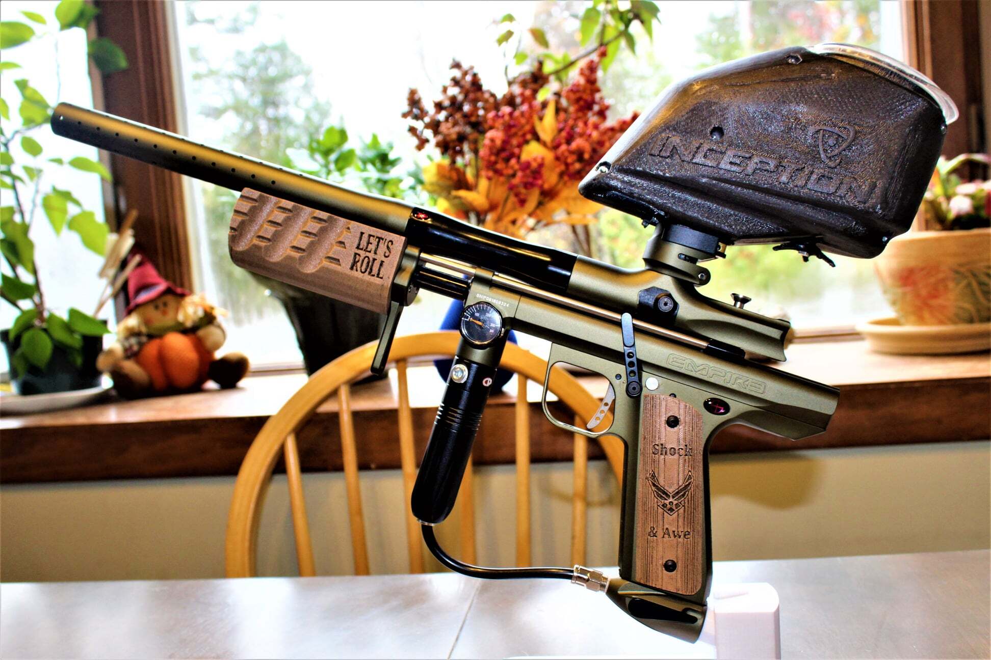

          I printed a similar wood pump handle for my sniper a while ago.
