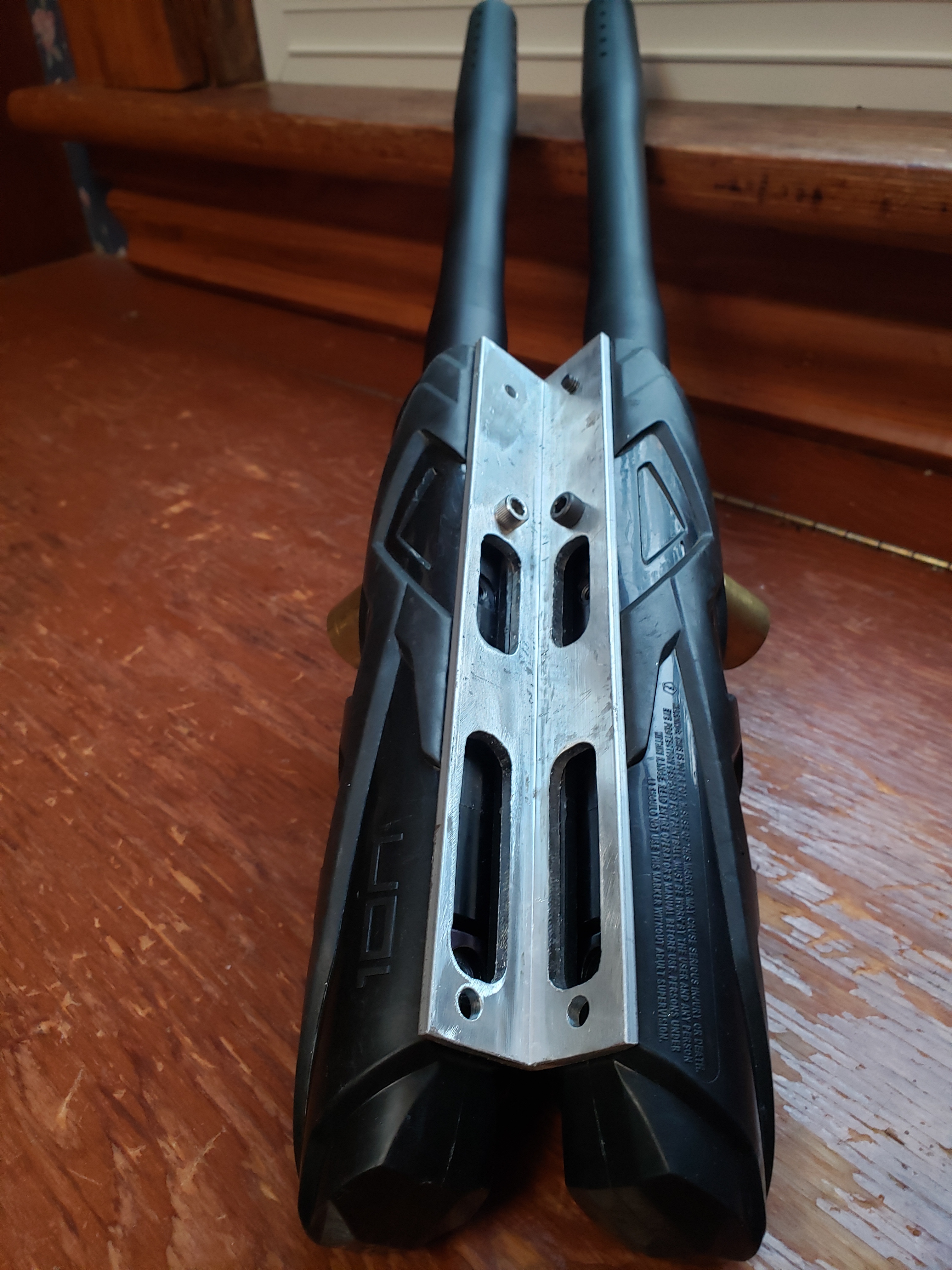

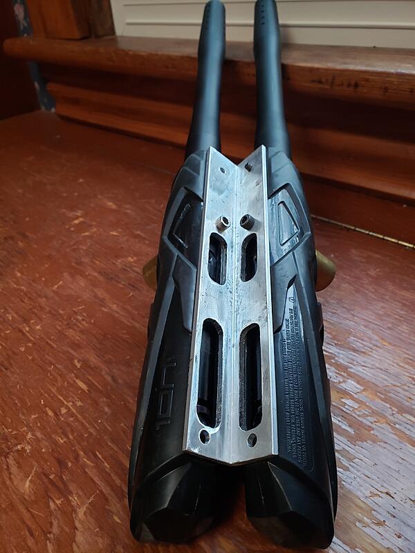

        It's going on another project I've got in the works.... sneak peek for ya.
          • 3394
          I need one of those rails! Hahaha
            Jordan commented
            It's 1x1x1/8" aluminum angle... the hard part is making the holes and mounting points.
          • 3394
          I can use a bridgeport at work, and likely snag that L channel. Maybeeee ill have to make a second double ion that uses normal hoppers. Hahahaha.
          But I think Id morlock the second one and see 8f I can make them shoot off kilter and make it sound cool.

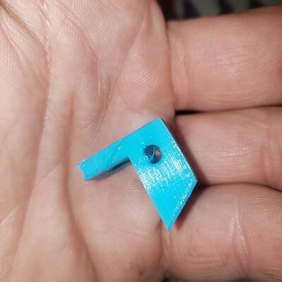

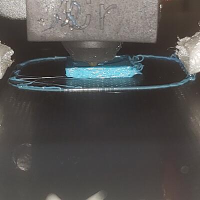

                  I think my filament may be too high on moisture content, but its a 45 minute print so imma let it run. May not be pretty but may or may not work. Lmao.
                    • 3394

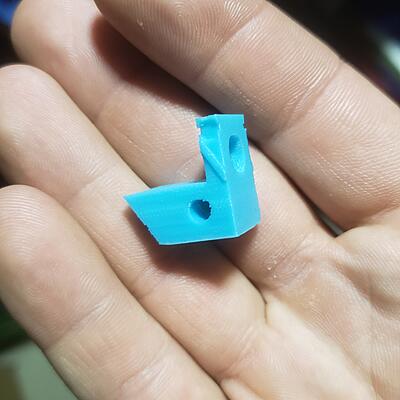

                    Well? I think itll work. I dtill dont have my printer dialed in yet. starting another one. If we are talking canada shipping, I may as well make ya a few.
                      BrickHaus commented
                      Oop. That one broke. Smav hole was snug and I was forcing a smav into it. Second looks wayyy better on the bed.

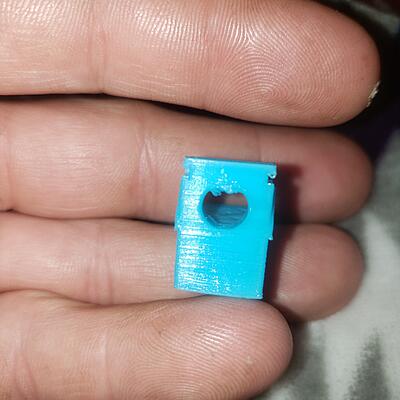

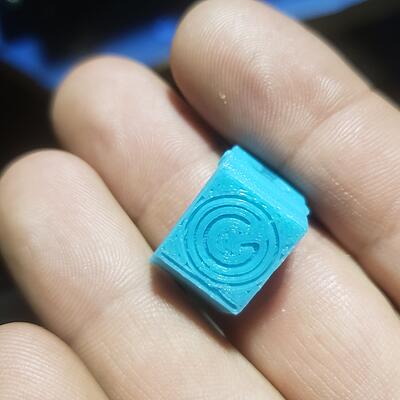

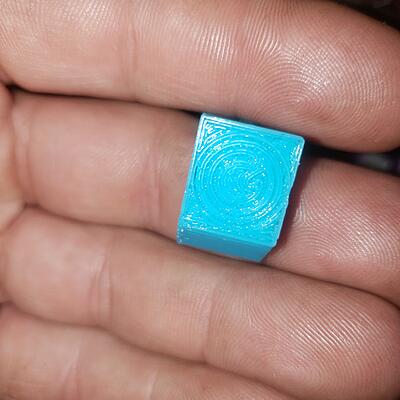

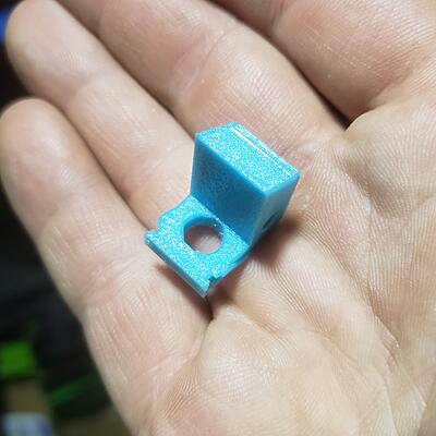

                      Second one looks alright. My overhangs still suck. Im gonna snag some new pla on my way home, and try a different roll tomorrow afternoon.
                      ill start another one in the AM as well.
                      You may have to clean em up a bit, but you seem savve in that manner.
                      This gallery has 4 photos.
                        Jordan commented
                        I have filed a thing or two...
                        BrickHaus commented
                        Pla is pretty workable with an xacto knife. Or even hand turning the appropriate drill bit in the holes. A file may not be necessary.

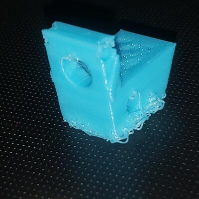

                      2 done, nozzle clogged this morning on my third, and failed the print. I couldnt get it to feed in tge few minutes I had. Ill keep churning em out tonight.
                        • 3394

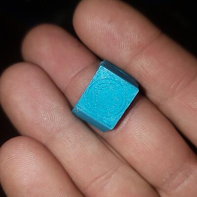

                        Alright, got my printer dialed in pretty good. It seems to have been a crappy nozzle this whole time. Working on the 4th. Ill get a 5th done tonight and ship em tomorrow evening.
                        Here is the third. Looks pretty nice..
