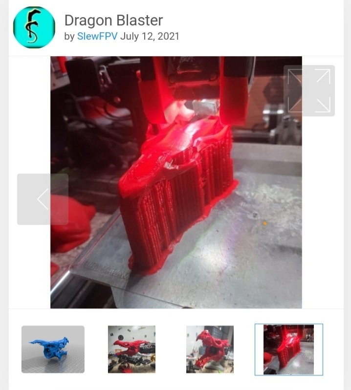

          A guy took a photo on his printer bed with the printing support
          Look like a nightmare to make and clean

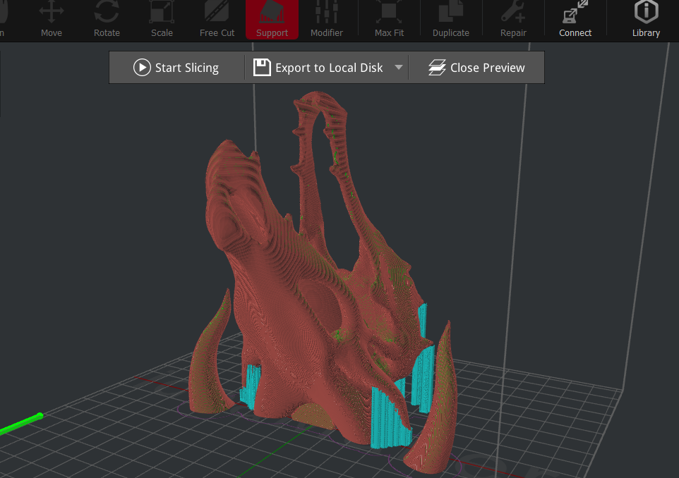

            Against my better judgement, i may have just wasted an hour tweaking this CAD to print better...
            - enlarged and angled the teeth forward
            - Filled in hollow portions of the skull
            - Changed orientation
            - sliced off rear horns to print seperately
            - couple other things i'm forgetting to mention
            Not saying I'm volunteering to print it or anything, just was bored during a teleconference...
            Click image for larger version  Name:	Optimized.png Views:	0 Size:	132.6 KB ID:	191980
            Click image for larger version  Name:	Optimized-print.png Views:	0 Size:	262.1 KB ID:	191981

              Man you are good with CAD!
              I hate working with spline and complex surface
