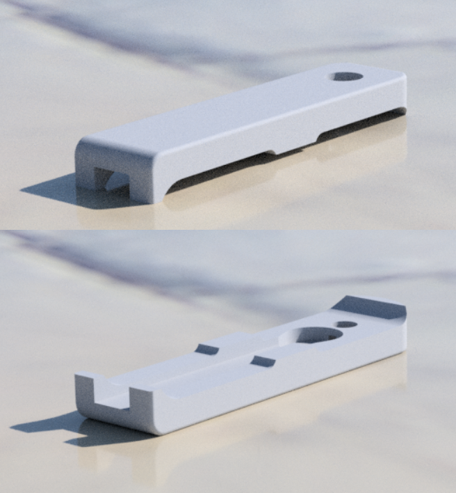

    This won't be the best video you've ever watched about CAD, but I felt like making it, and so here it is. For anyone who is curious how I think about things when I'm CADing (is that a word?). I need to do a better job next time with screen record and stuff though. This was just a quick and dirty. My intent really is to show some of you beginner CAD users that the best way (IMHO) to make solid shapes in a platform like Fusion is SKETCH and EXTRUDE, rather than creating a cube or other basic shape and cutting it up to the right shape. (not sure if i'm articulating this well)

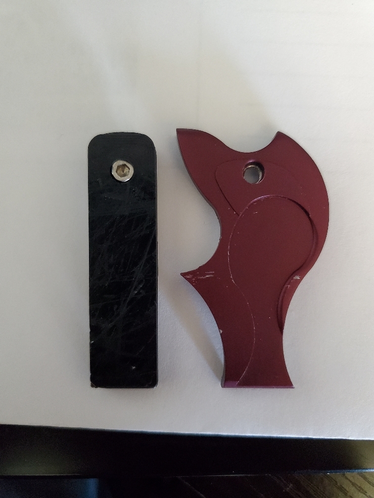

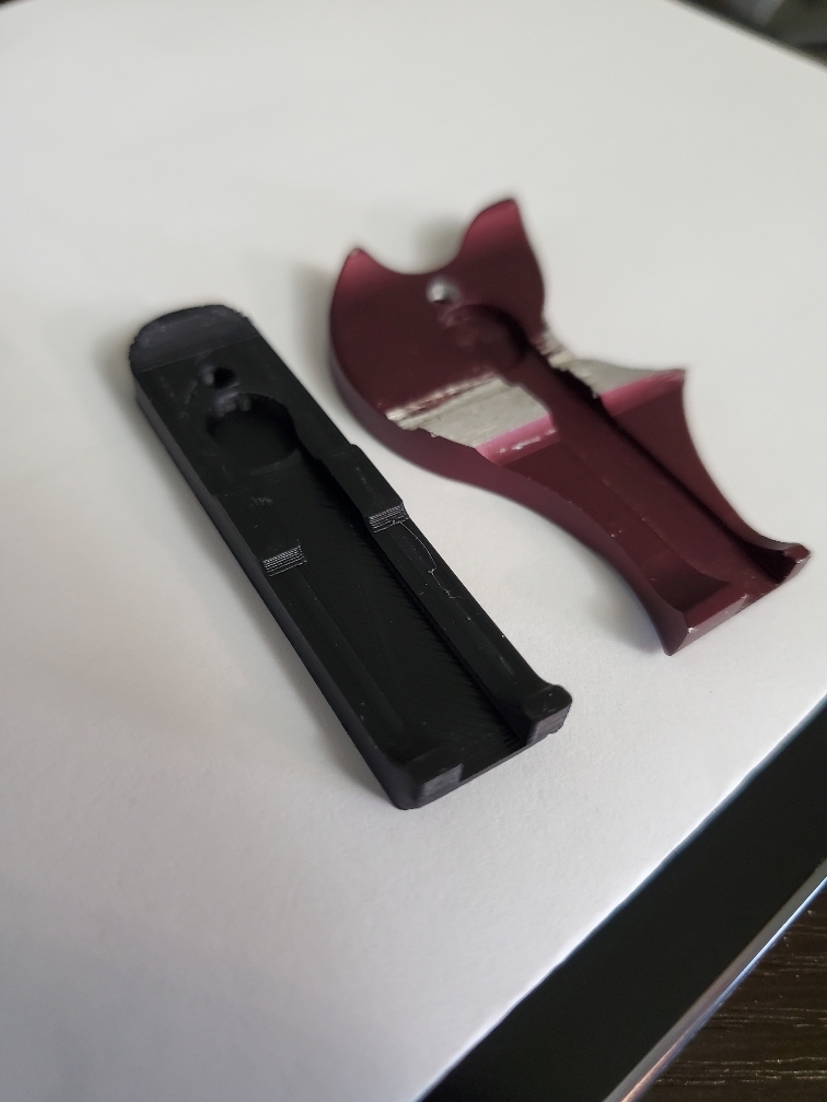

    Cdn_Cuda sent me an eye cover for his System X Dragon cocker, with hopes that we could make something a little less obnoxious.
    And here it is:

    Great looking final product, I don't see any layer lines at all (Resin printed?)! I'll have to check out the video, I have been using Tinkercad and I know I need to move away from that so I can get more out of my printers!

      Thanks! Nope, it's just regular FDM printed. The black material just isn't showing the layer lines very obviously.
      IMO, for part design, there's no better CAD program than a Solidworks-style platform. And Fusion360 is along those lines (and free). I've messed around a little with a few others, and just keep coming back to Fusion. YMMV
