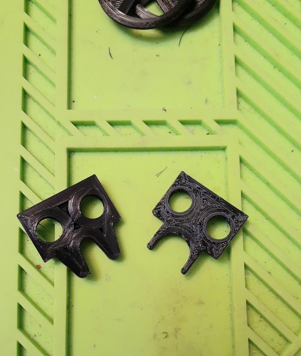

                    Thanks all for your advice, I was able to print some VM68 ball detent and speedfeed in TPU on the 2nd print!
                    happy with the result
