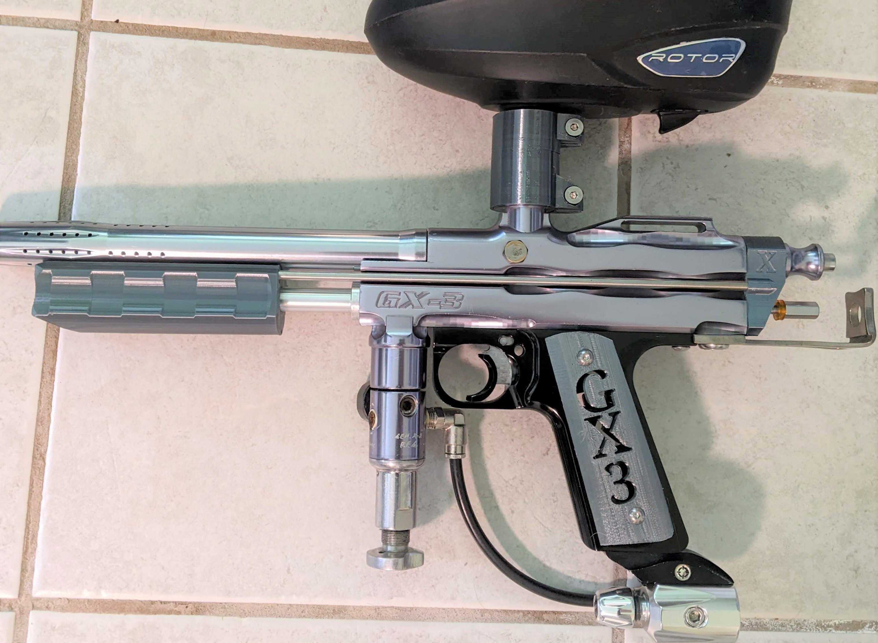

    I got a GX3 project in not too long ago (Bought off pintbuster) . I finally got around to it. I got it working as a pump, but the colors were really off, and I couldn't find the right parts in Pewter to match. I decided to 3d print the parts that I wanted. This is not a brag, this is a fluke! Every part I printed fit and worked perfect the first time! Design took me almost no time and since it printed perfect the first time this was done in almost no time.
    3d printed parts:
    -Pump handle to replace old school super huge WGP pump handle. I didn't like how far out the pump handle set, so the pump arm goes into the handle a ways before it screws in.
    -Back block. The only one I had was bright blue and thought I could get closer. It has a cut out for the cocking rod and cut outs for the bolt's ball bearings
    -Grip panels, I thought see through GX3 cut outs would be cool
    -Over the feedneck hopper adapter. This was inspired by FredMnkyDad10 he thought it would be cool to design and print one.
    I just swapped all orings and cleaned it up. She is shooting perfectly!
    I don't have any pewter filament, and this was the closest I could find to match.

    That looks sharp, don't be so humble 😉
    • FredMnkyDad10
      • 2260
      Dude this is awesome great work. I really like that the look of the pump handle. I will be hitting you up for couple of those, need one for a flatline and ptp cocker.
      Feedneck looks great too.

        That looks great man, glad you could tie it together!

          Any chance you could share the file for the feedneck adapter? I've also got a GX3 and would really like to be able to print this off!
