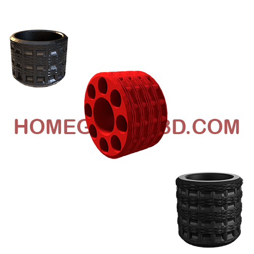

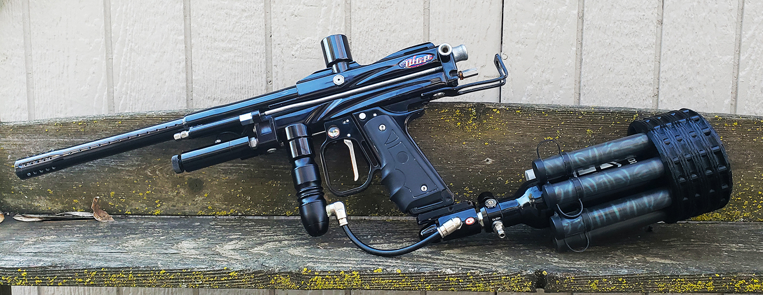

    I released my 13ci and 15ci tank cover butt designs! Including a tube butt! It's fun to say butt.
    The tube butt holds 8 10-round-tubes. I am working on a capless version of it as well but orienting the tubes that direction presented a few more variables I have yet to conquer for best function. Will comment/post up when the capless is done.
    13ci tank cover butt tested with HK tanks, and 15ci tank cover butt tested with first strike tanks. Not sure if dimensions vary from brand to brand.
    For 3d printing in 95A TPU.
    Enjoy!!!

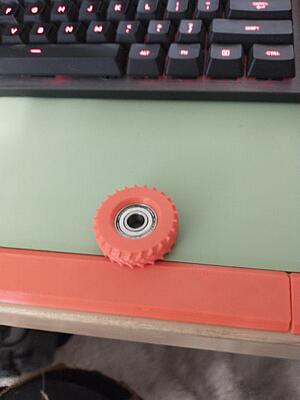

      Looks like ill need to practice tpu printing.
        XEMON commented
        I have an ender with single gear extruder and I print TPU with no problem 👍
        I did print a new top plate for the lever/tensioner mount: https://www.thingiverse.com/thing:3844646
        It makes a world of difference!
        I can send you my settings if you want

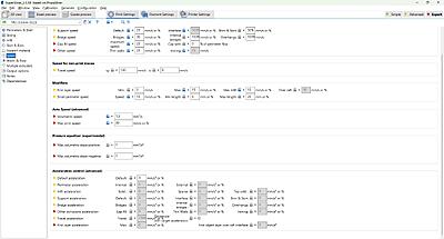

        Besides the usual temperatures and bed conditions, the main thing I found with soft tpu like ninja flex (85A) is volumetric flow rate. Rather than fiddle with all of the various flow rates, you lower the volumetric flow rate to limit everything. It is very slow, but it's really handy for seals and squishy things.
        The setting in slicer is under print settings, speed, (advanced) auto speed. My ninja flex is set to 1.5mm3/sec.
        ***this lets you keep the travel speed high, reducing strings and blobs.
        Mainly though, if you have trouble with softer TPU, trying slower feeds may help.
        • MuddyBloodyFactory
          MuddyBloodyFactory commented
          Not sure I follow this comment. Why not perform a flow tuning procedure?
        • Spider!
          Spider! commented
          It limits the flow rate across the board, including bridges and infill. I had an exception setting somewhere that would speed up and cause trouble. The print would work fine up to that point, but it would under extrude and then blob on a detail.
          That's with super slicer.

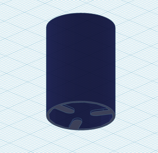

ID:	436590I would love to figure out a reasonable way to make it capless, but another thing I've been tempted to test is to make a "speedfeed" style cap for 10 round tubes that has 3 small flanges on the top that just allow you to jam the tube into your stick feed / cram and jam, and it will just slide down the tube.
        Just need to perfect the design so that it's tight enough to keep the balls in the tube when running around, and loose enough that it can easily be pushed down with the force of reloading a stick feed.​

            Kind of, but it works in the opposite way.
            Here is a picture of my current design.
            It replaces the cap on the end of a 10 round tube
            The flanges open when you push the tube into a feed stick
            The cap will slide down the 10 round tube and get stuck a cm or so down.
            This will mean you never lose the caps, and you can load your feeds without needing to remove the cap.
            It allows you to use any harness as if it were a capless design.
            I need to do a lot of testing though, I have to perfect the thickness so that it's easy enough to operate, whilst still maintaining structural integrity on resets so that the flanges don't get so loose that the balls jiggle as you move around.

                I mostly abandoned the design. If it's too soft the balls bounce around to much and is annoying. If it's too hard it doesn't work well. The other thing is it inevitably softens up / becomes more angelled with use so it becomes problematic.
                I ended up just creating and using a capless holder.
