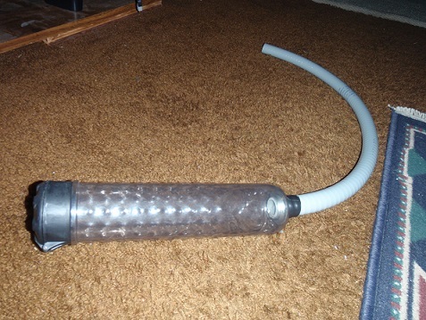

    I made something similar that used to be up on the old site with instructions and all. mine was different in that:
    - I drilled a hole in the bottom of a pod and ran a length of flexible conduit hose into the hole
    https://www.homedepot.ca/product/car...oil/1000117040
    the conduit is waterproof and pretty crush resistant so I never worried about crushing paint
    - my dads good with a sewing machine so with his help I made a sleeve that fit over the entire thing and allowed me to hang it off the back of my tac vest (right shoulder)

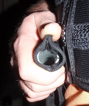

    - their were a few ways to construct the open feed end, one would be to just stuff the cut off top of a ten round tube and stuff it into the flexible conduit and just use the 10 round tube cap to keep it closed, this method would work good for filling a phantom removing the need to carry tubes all together. the method I went with was to sew in some rigid plastic to make it open and close like a coin purse.
    I found the same issue as you with paint bunging up at the funnel of the pod but with the length of flexible conduit coming off the pod long enough to hold about 40 rounds as it wrapped around from my right shoulder to my left hip I could load a hand full of tubes before it stopped feeding and as I ran around and played it would dislodge the bung and refill the length of flexible conduit.

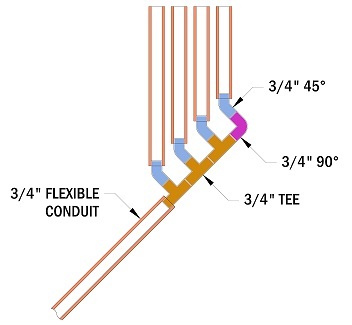

    I started a build of a second version a while back but never got around to sewing up a new cover for it to complete the project (maybe this winter) but the new version got rid of the pod all together using coper plumbing parts with the same flexible conduit. Essentially I have the same length wrapping down to my hip but instead went through some plumbing parts, I made a diagram to explain it better but the concept was to reduce the overall thickness so I can lay on by back easier and crawl through the bush with less snags, I also have hopes the new design will bung up less frequently.
