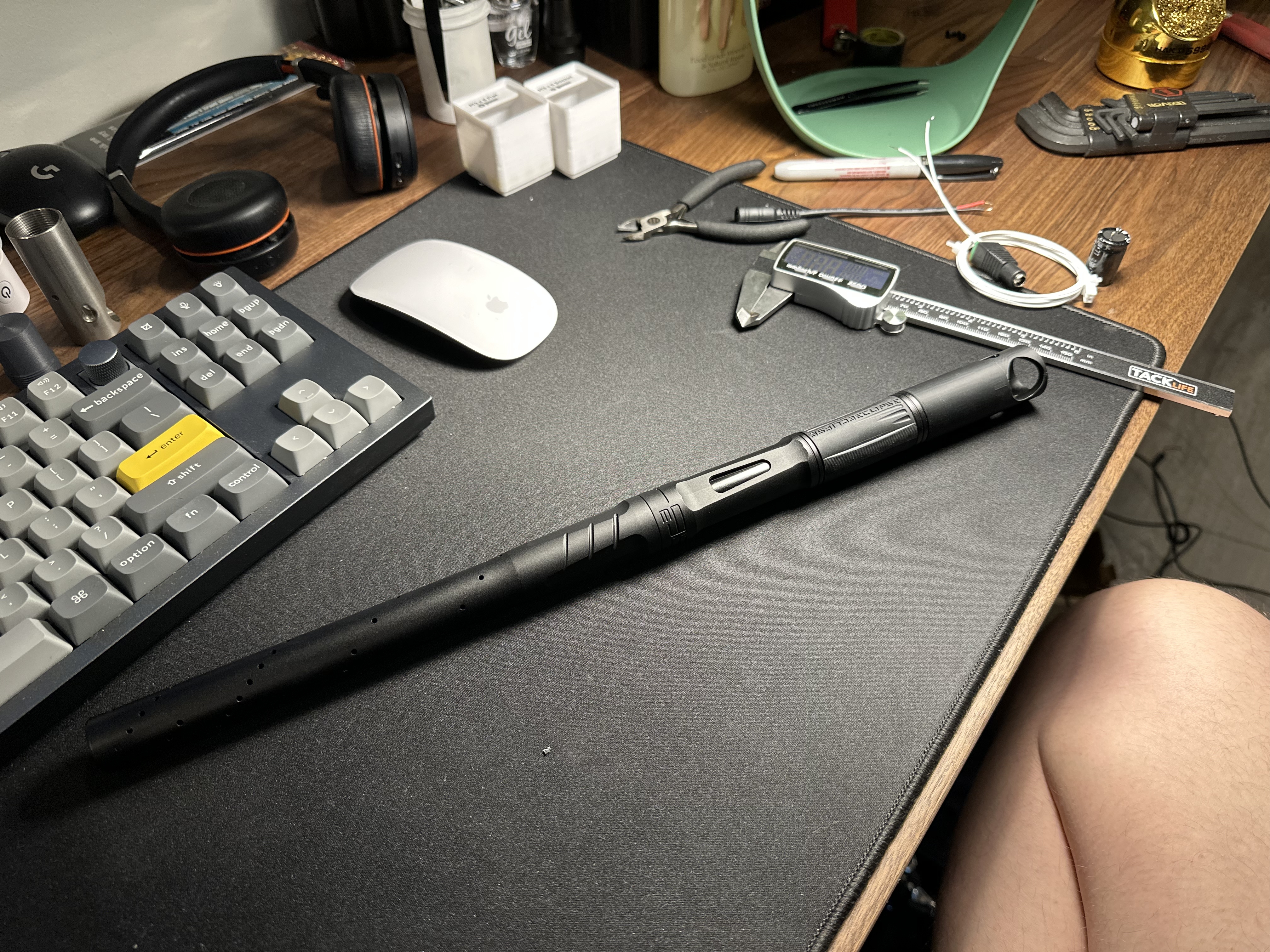

    Built from scratch. Yes it works. It's stupid light. Please for the love of god, understand the risks. I'm printing at an angle for layer adhesion.
    Spyder detents on this version. I will be creating my own detents so you can TPU print them.
    PLEASE USE ABS/ASA/NYLON for this and understand how little I care if you blow yourself up.
    There will be more, working on polymer rails for mags. Let's play.

      On a PE barrel

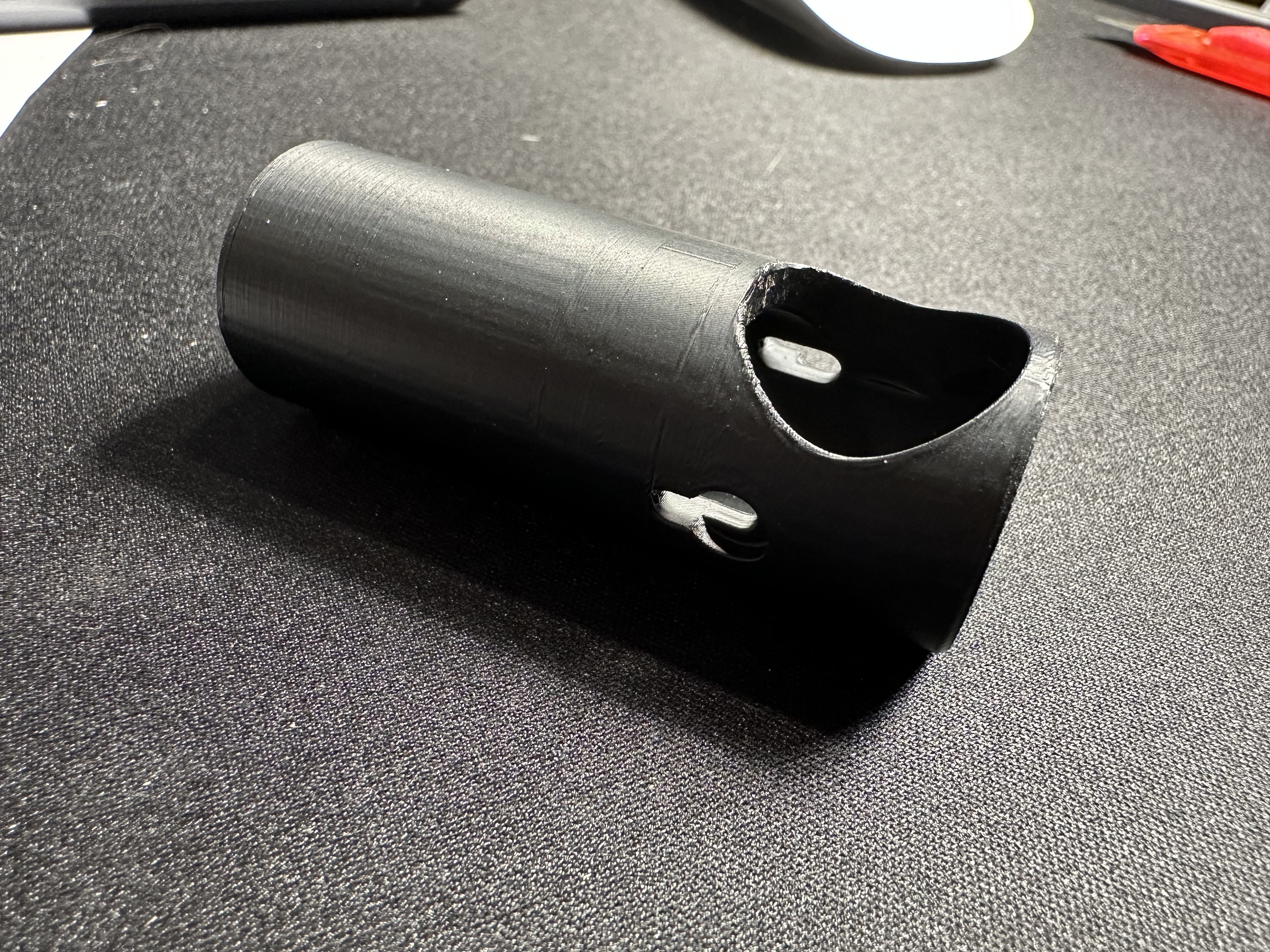

        Neat! And great job. A stupid light adapter for a twist lock would definitely help those who want to use reduce weight on their classic builds, I'm dense when it comes to 3d printing but is there anything 3d printing material that would help with durability?

          I'm having best luck with ABS/ASA prints. Nylon is printing a little too tight on the threads. The adapter stays inside the body and eliminates the twist lock entirely. There are 3 positions for each body type - left feed, right feed, and center feed.
          So far it's holding up just fine. It's considerably lighter than the stainless steel version. Since it sits down inside the body it should resist breaking rather well. Time will tell. Worst case you print a few and throw em in the bag as spares.
          I'm exploring further changes, shortening the length somewhat and also the aforementioned printable detents.
