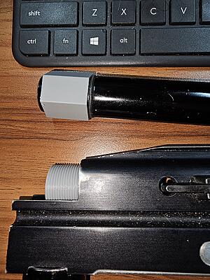

        I ran a print and toyed around with trying to pull the thread info.I wasnt able to get the current info so ive been learning how to model them. its been a challenging and fun experience so far

          Just last week I was looking for a way to copy threads and get the female pattern from the male.
          It didn't end up going so easily, i was under the impression that i needed a special plugin for OS to create them in studio.
          Not the case at all.
          the male was trial and error, the female was spot on first shot.
