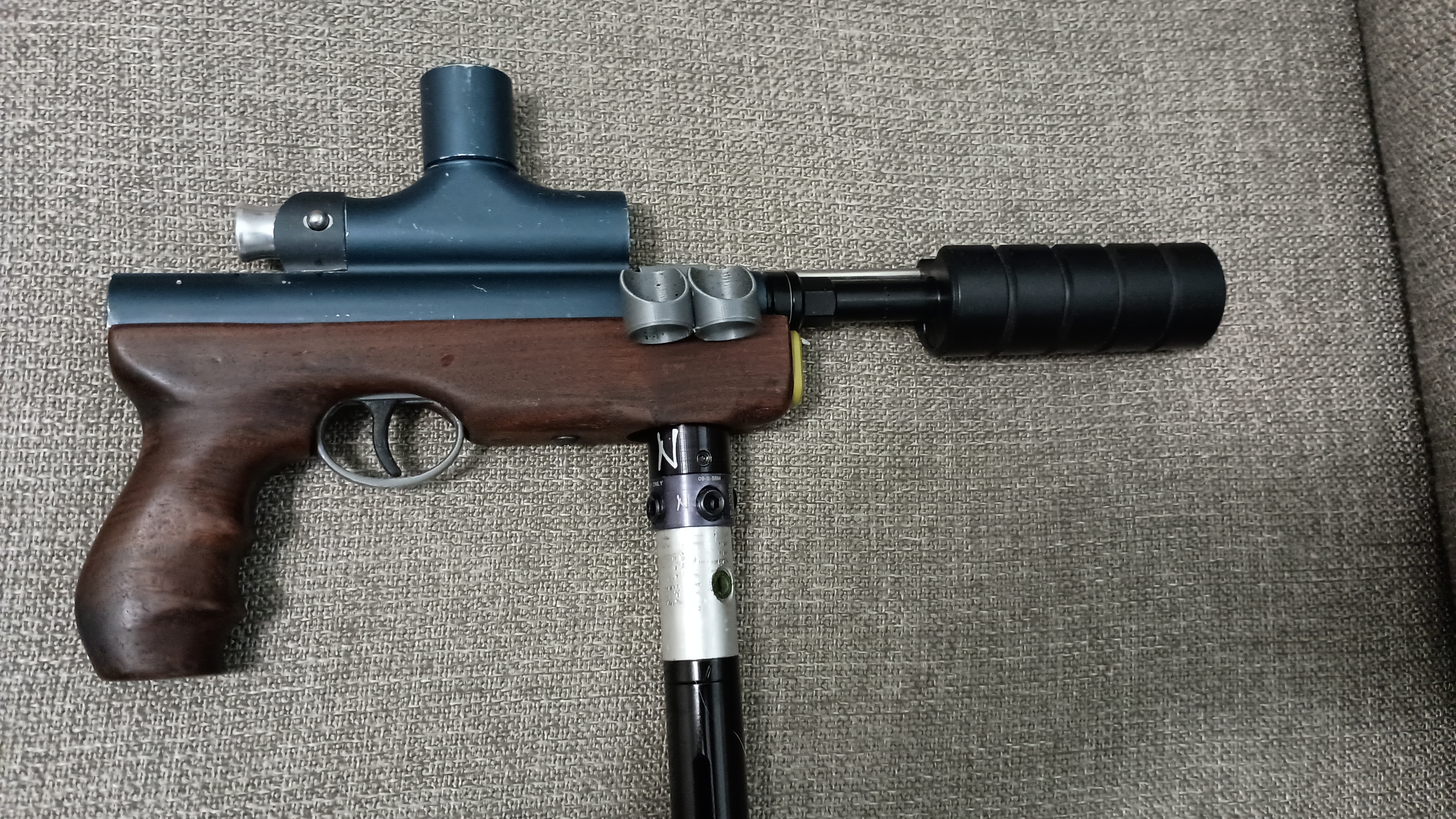

    Has anyone done and used this? https://www.thingiverse.com/thing:5237390 frame screw spacing is correct however it appears that the sear may be missing. trigger and slide plate are integral the frame itself seems correct minus the grip mounting location but thats easy to take care of.

      That's mine. I haven't used it a lot, but it still works. It uses the trilogy (cocker) sear. I think the cross pins are brass rods. None of it suffers much stress.The point of the build was to make a small unregulated pump build with the custom stock. I find I can tune a regulator with less effort than all the dis/re-assembly of tuning a poppet. I think I can find the files if you have a different stock dimension to build.
      The mounting scheme I got from Walz, which is that front screw post. I used rifle bedding epoxy to make the fit really snug.

        Yeah, that was an early (to me) model on my cranky printer. It does need some support on the housing. I couldn't get away from that.
        Separate the trigger "plate" and print it flat. Print the body vertical. That makes it all pretty tough. You can slice the two parts and add height to make them taller, not sure if they can get shorter.
        I used the sear pin and sear from the trilly. 1/8" brass rod for the front and back guide pins. I think the trigger return spring is the size of a pen spring, if not actually one. The sear spring might be custom, I would have to look.

            I put the step file on thingiverse, Ecapnation checked it on solid works.
            Hah, I just remembered what the front and back holes in the housing are for. They are pre and post travel (Allen) screw holes, #4 or #6. Then you have lug engagement to adjust.
            I think I copied the trigger plate angle, but I have wondered about changing that angle or shape to see the effect on trigger pull.
