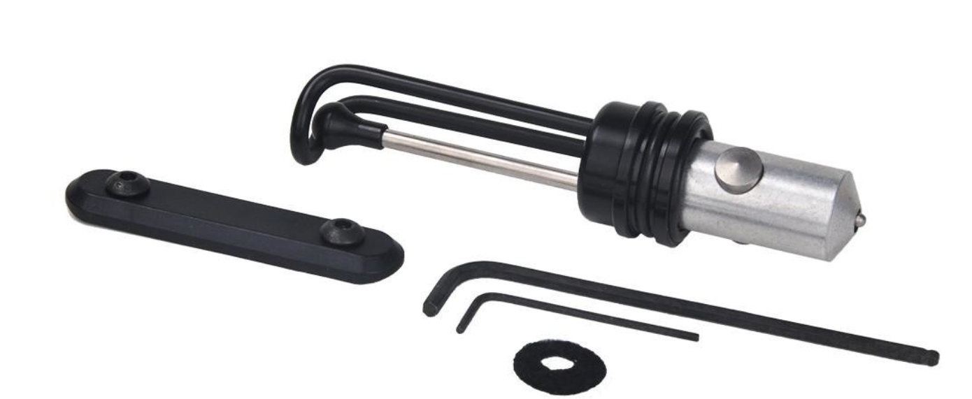

    Was curious if anyone here is aware of an STL of the bolt cover that would come with the rear cocking kit. I've never seen the backside of the cover so I'm not entirely certain how it secured to the receiver.

    The screws thread into an insert with a flared edge, the insert pulls into the slot. dont over tighten or it pulls right thru. Also the screws have holes drilled thru to allow the recock air to vent.

      Thanks for the insight. I was able to find a CAD file of a Tippmann 98, perhaps I can try and model a cover off that.
