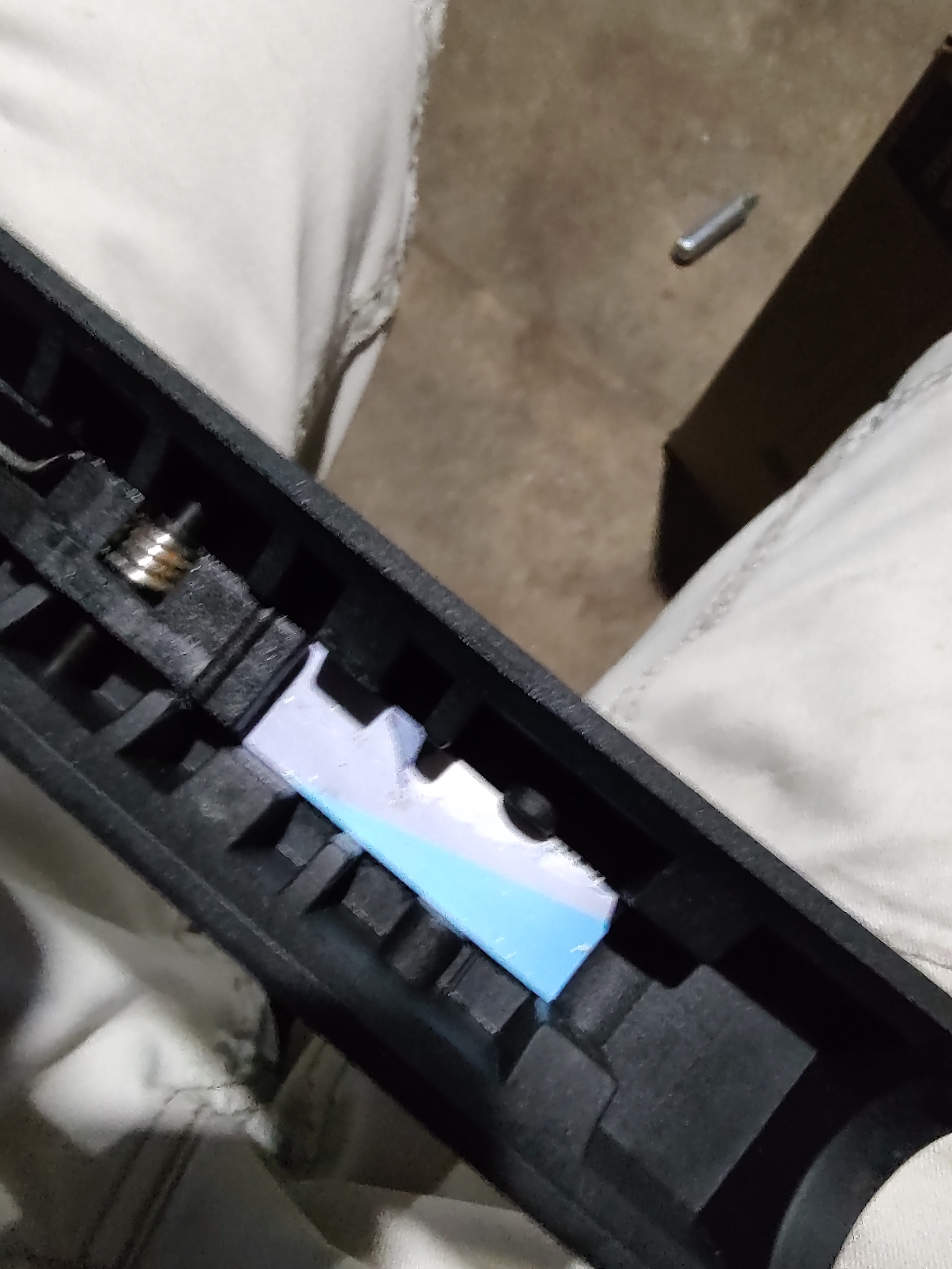

    The trigger pull was the first thing I approached, the stock pull is stiff and long (wink wink), so I chopped up a credit card, stacked it 3 pieces high and glued it under the trigger sear to take out some of the length.

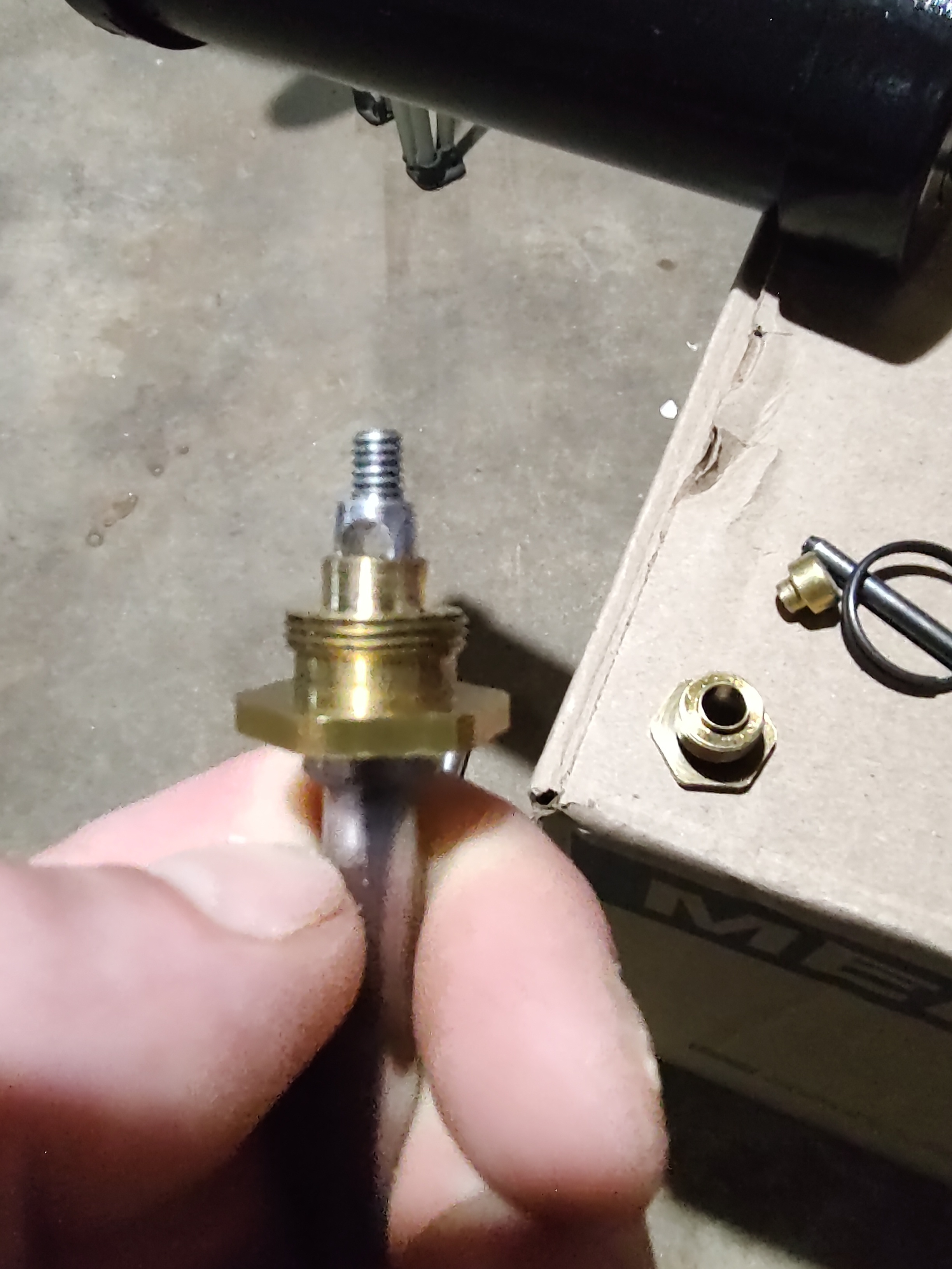

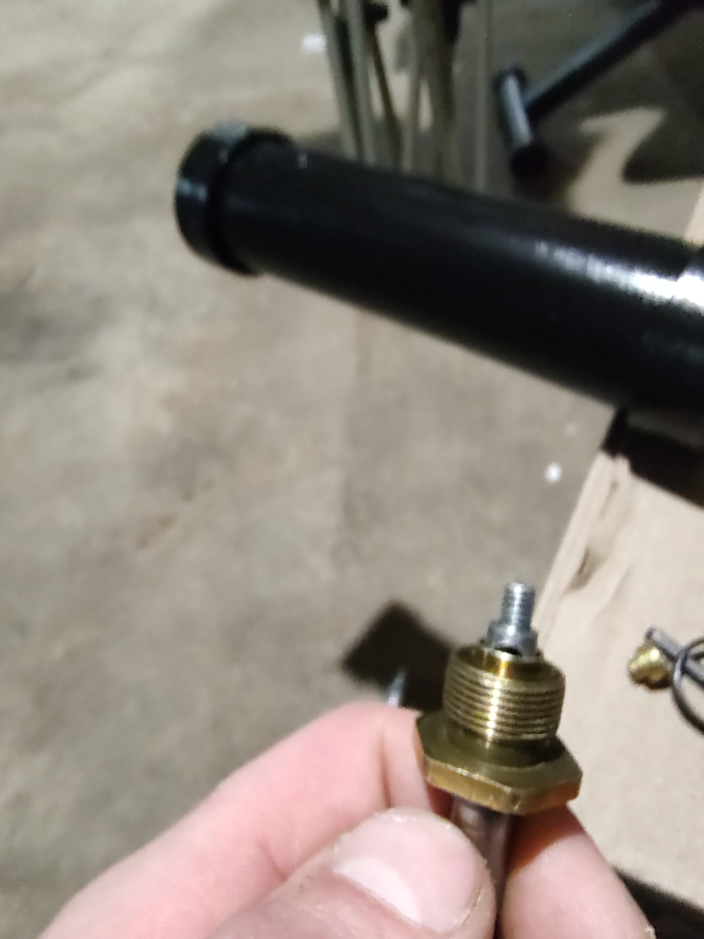

    Today the final piece arrived. The stock valve's design leaves the velocity somewhat low. netsurferdude2 (thanks as well!) turned it down and removed some excess threads/materials to allow for better airflow. I've yet to test it over a chrono, but it certainly seems to be shooting better now.

    I had a theory that the tigershark needed a little more volume in its valve area. Ill tool up for valve mods once again. Thanks for trying it out! And thanks for giving me inspiration to try my own mods!

      No, i dont think an expansion chamber would work. I think the immediate valve area needs to be larger. This is of course just a theory.

      I've thought about expanding the passageway from the back bottle threads into the valve chamber. Got any thoughts/experience with that?

      Opening up the passageway from the air supply is a good idea. Ive never done it but im sure its fairly straight forward
