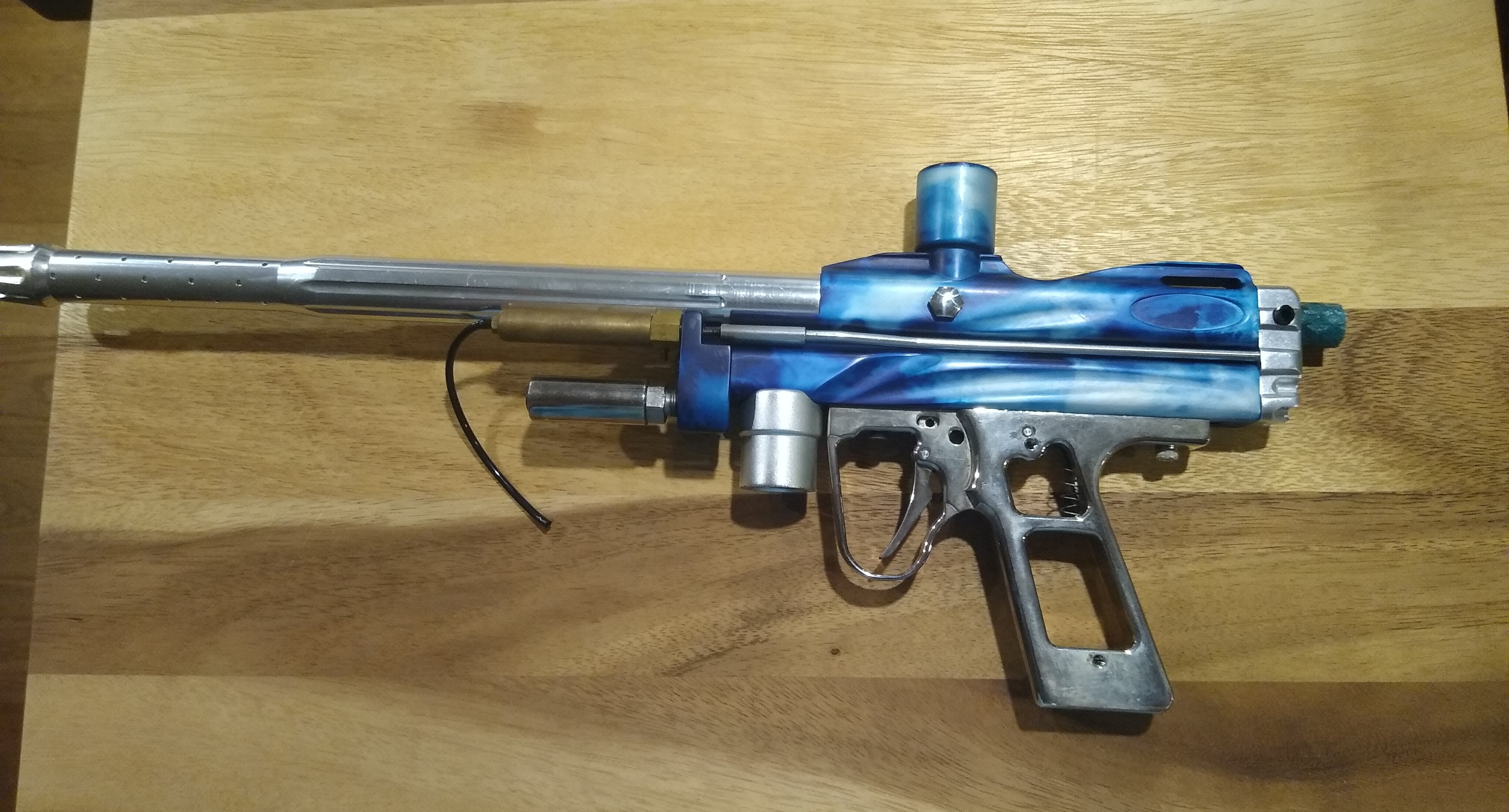

    just finish this one tonight. used to be a high gloss blue ano now its a matt blue/light blue/clear acid wash. According to my research afterwards the finish was dulled because it was anodized at to high of a temperature. It should have been around 70* but since I need to get to bed at a decent time tonight I didn't want to wait for the ice packs to cool the 12 galons of water from ~80-85* and incorrectly thought it would be fine.

    Looks great! Good work! In my experience you lose the gloss whenever you remove the previous ano with lye etch. If I want gloss parts I remove ano with lye, polish, degrease, then ano. I'm not expert that's just how I do it

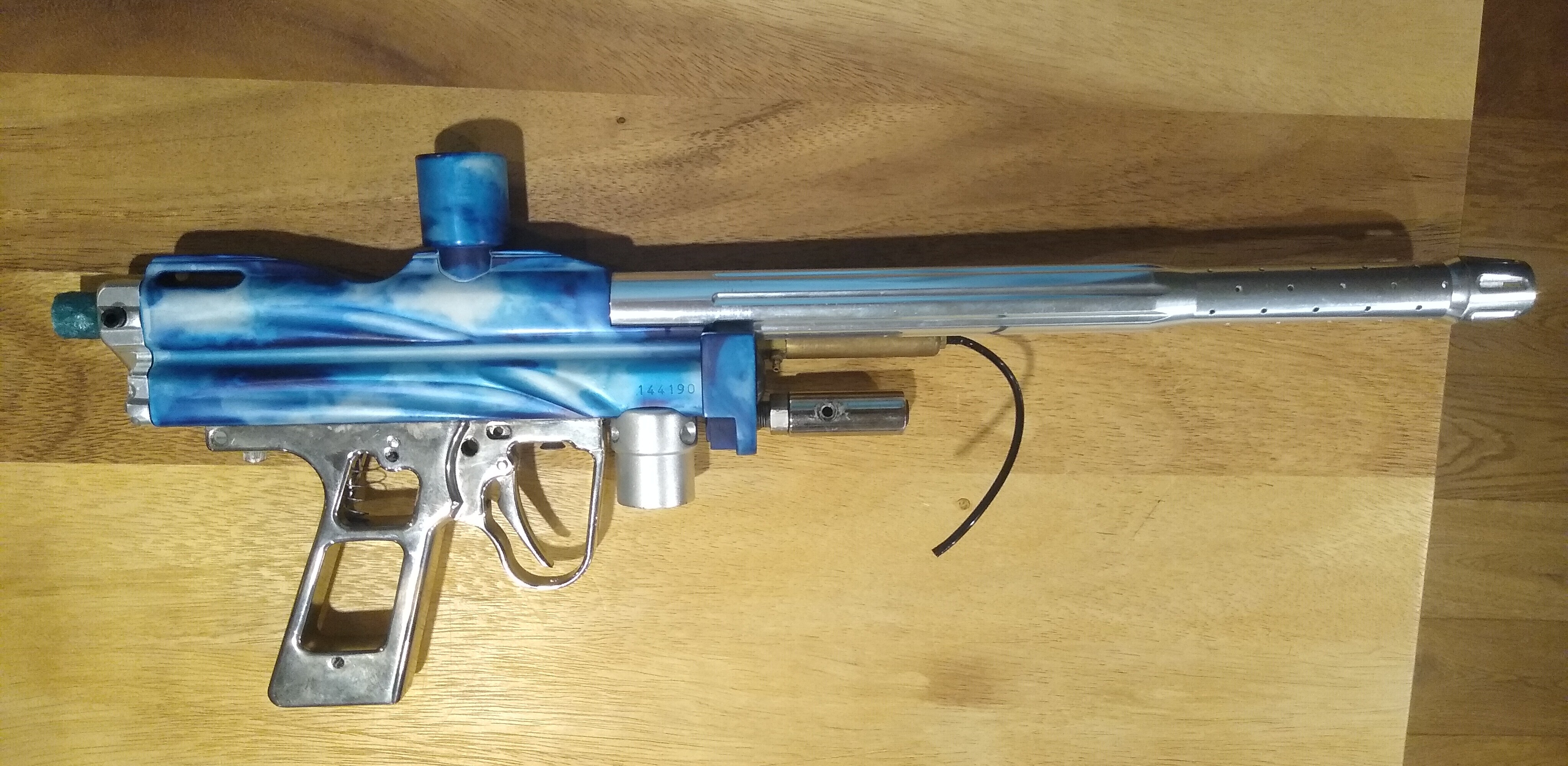

                small update::
                Threw together the gun and not to toot my own horn but I'm pretty excited about this one. The plan right now is to reano one of my black regs, ram, and 3 ways to clear so that they match the vasa and back block.
                This will probably be the last update on this body since once finished I plan to sell it.

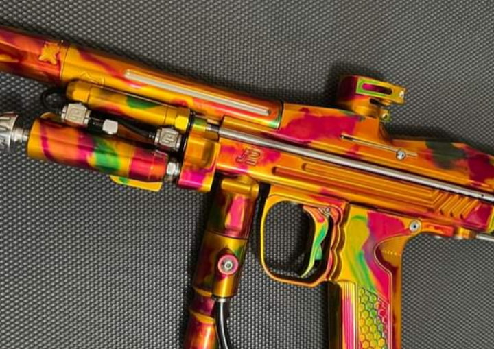

                i was wrong, it is possible to get a three color acid wash with out getting brown. I found this example from a much more talented anodizer than I Screenshot_20231003-155926.png
                If i were to guess this was done by:
                1. dying it red
                2. remove most of the red using the bleach, thorough rinse, reopen pores with diluted sulfuric acid, thorough rinse method to get acid wash (I skip the bleach part and just use sulf acid because its safer since there is no chance of the bleach and acid mixing if i don't use it. My method still works but using bleach to remove the dye works faster on some colors)
                3. put part in amber dye until desired shade achieved, rinse excess dye off well
                4. drip blue dye onto part and let it sit for a bit to get the green. I've heard that dye can be thickened with cornstarch to keep it from running so much during this step.
                5. rinse then seal

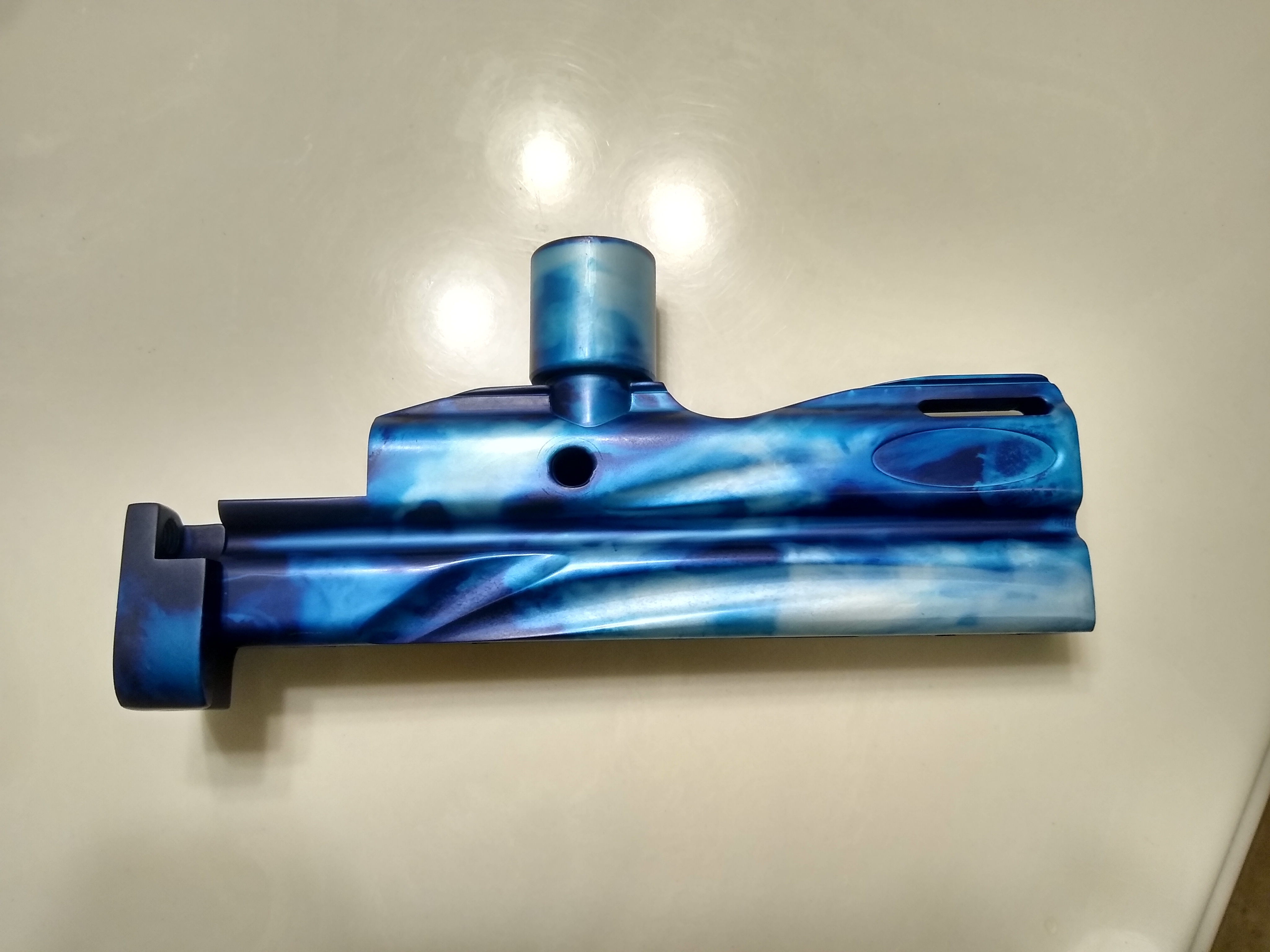

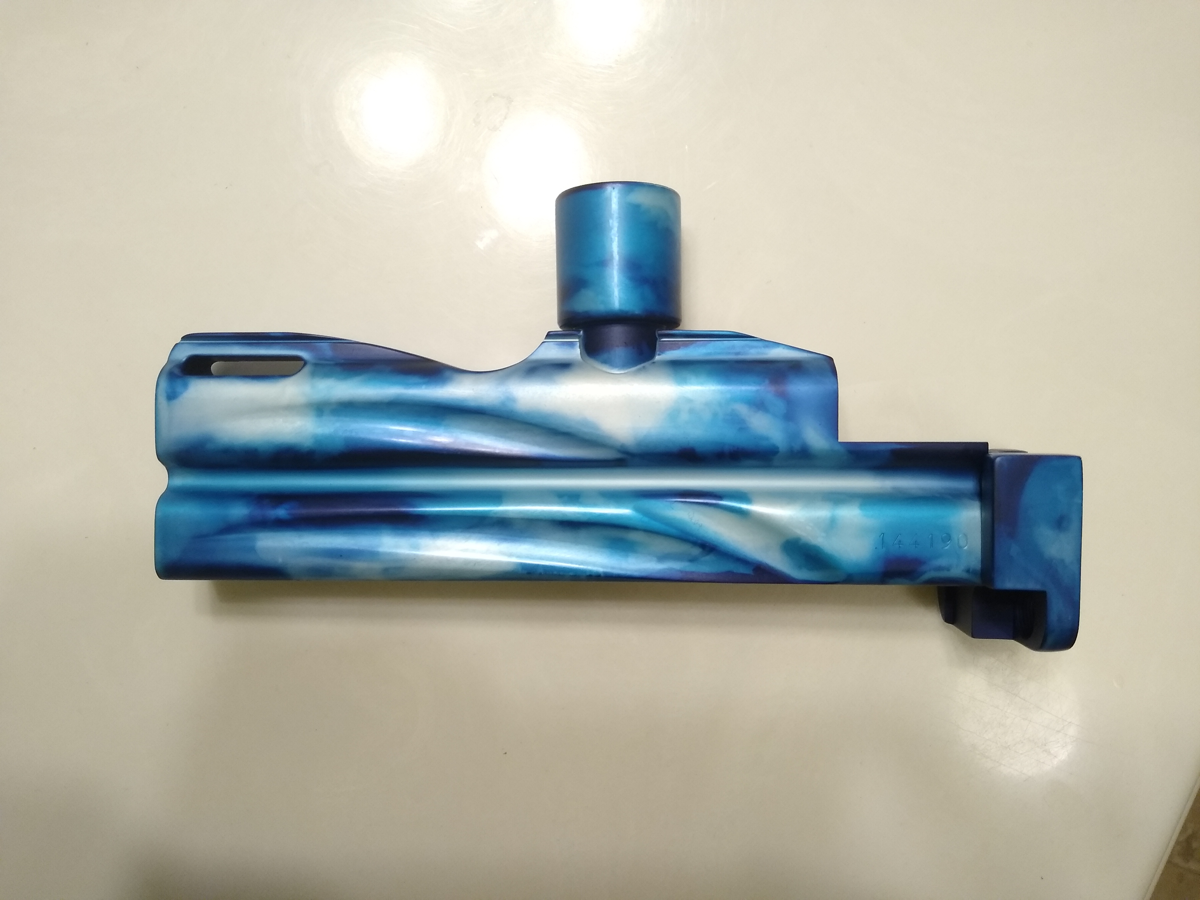

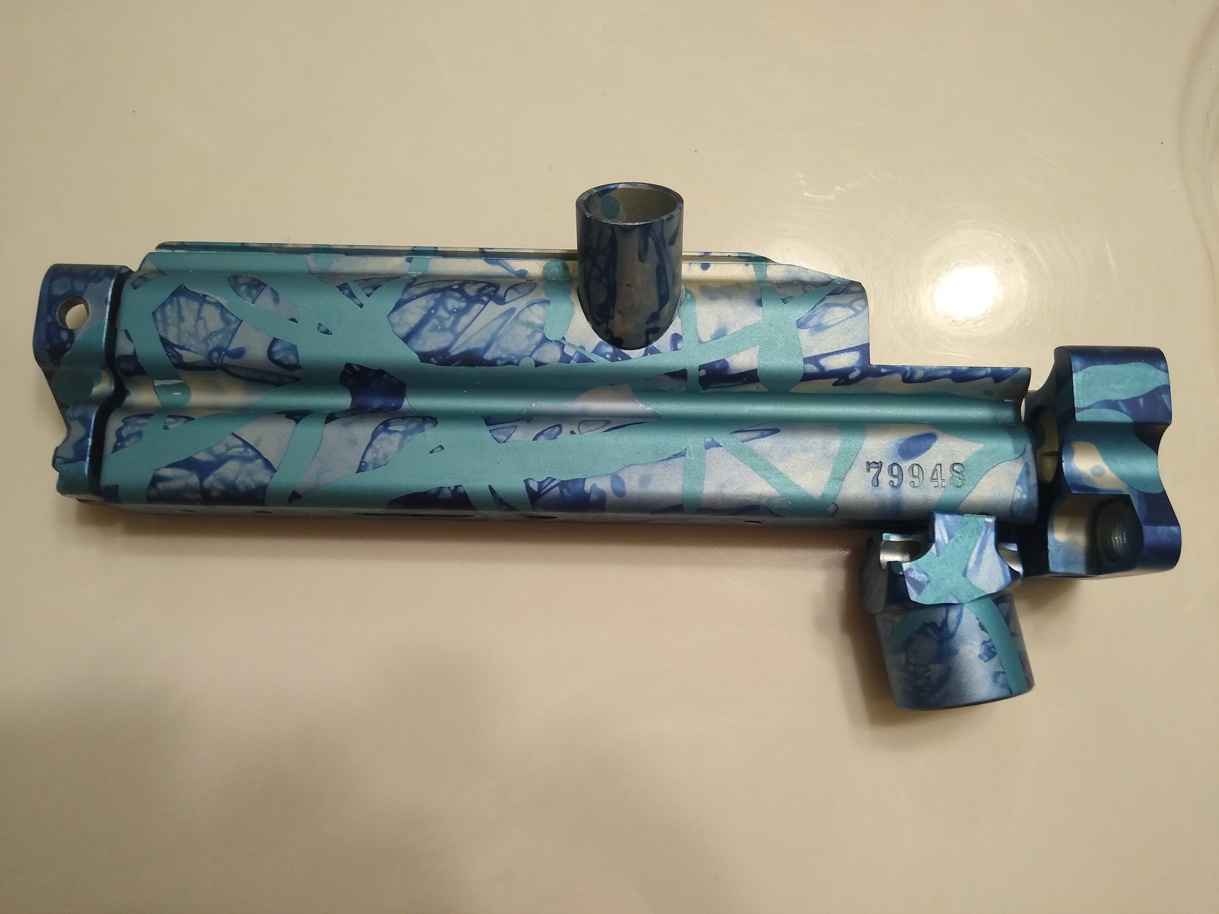

                  Light blue splash with dark blue marble. Will post details later it's currently 1am and I need to get to bed
                  • jetenginekyle
                    • Jun 2023
                    • 580
                    For all steps wear appropriate ppe gloves, goggles, and respirator
                    I ran the ano @ 3.44 amps for 160 minutes, bath temp was about 65F at start of run.
                    Dyed it in caswell fast blue 2LWN, dye temp was about 70F ( i should have heated it, took forever to absorb)
                    Dry off part, then put applied splash mask. ( I use GE Siliconized Acrylic that I've thinned with acetone until it has paint like consistency)
                    Remove light blue not covered by the mask by dipping part in solution of ~10% sulfuric acid 90% distilled water. rinse part very well
                    Put about half a teaspoon of caswell blue 4A in a plastic grocery bag and shake it until dye droplets cover inside evenly, then put the parts in and wrap them in the bag. I put the body in its own bag and the vasa and blocks in their own separate bag. For the bag with the small parts I twisted the part around when wrapping it to keep them from touching each other.
                    wait 30 min, then rinse well
                    seal in caswell ano sealer for 30 min
                    clean off masking with plastic scraper and acetone
                    seal again since otherwise the parts that were under the mask wouldn't be sealed correctly

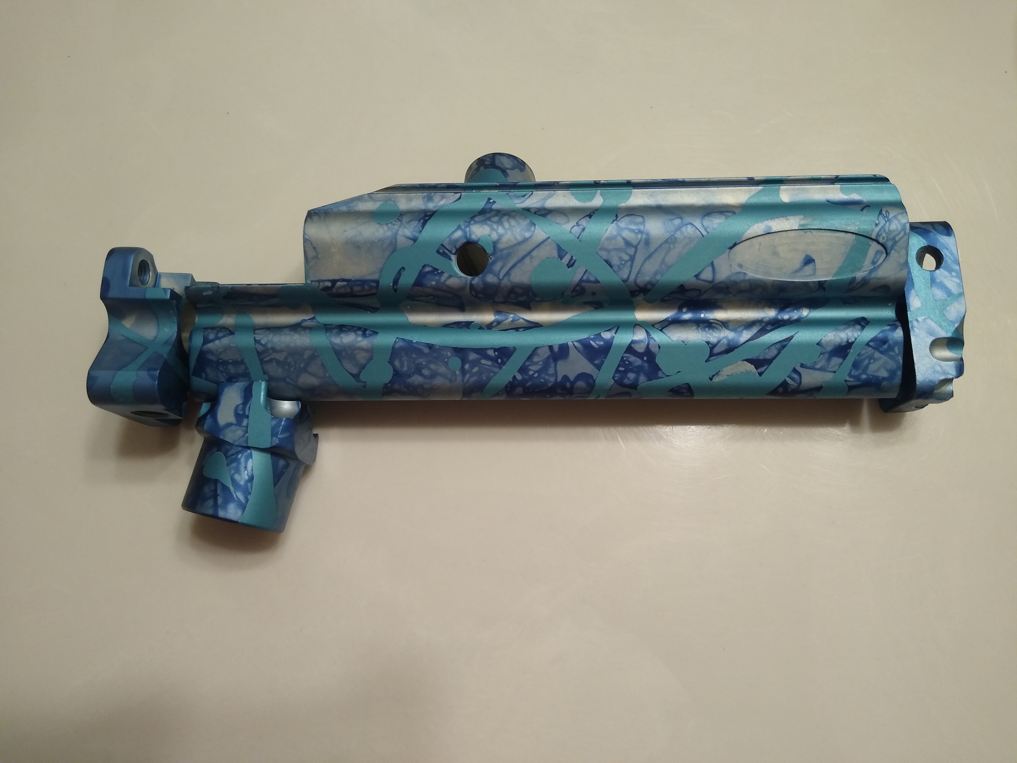

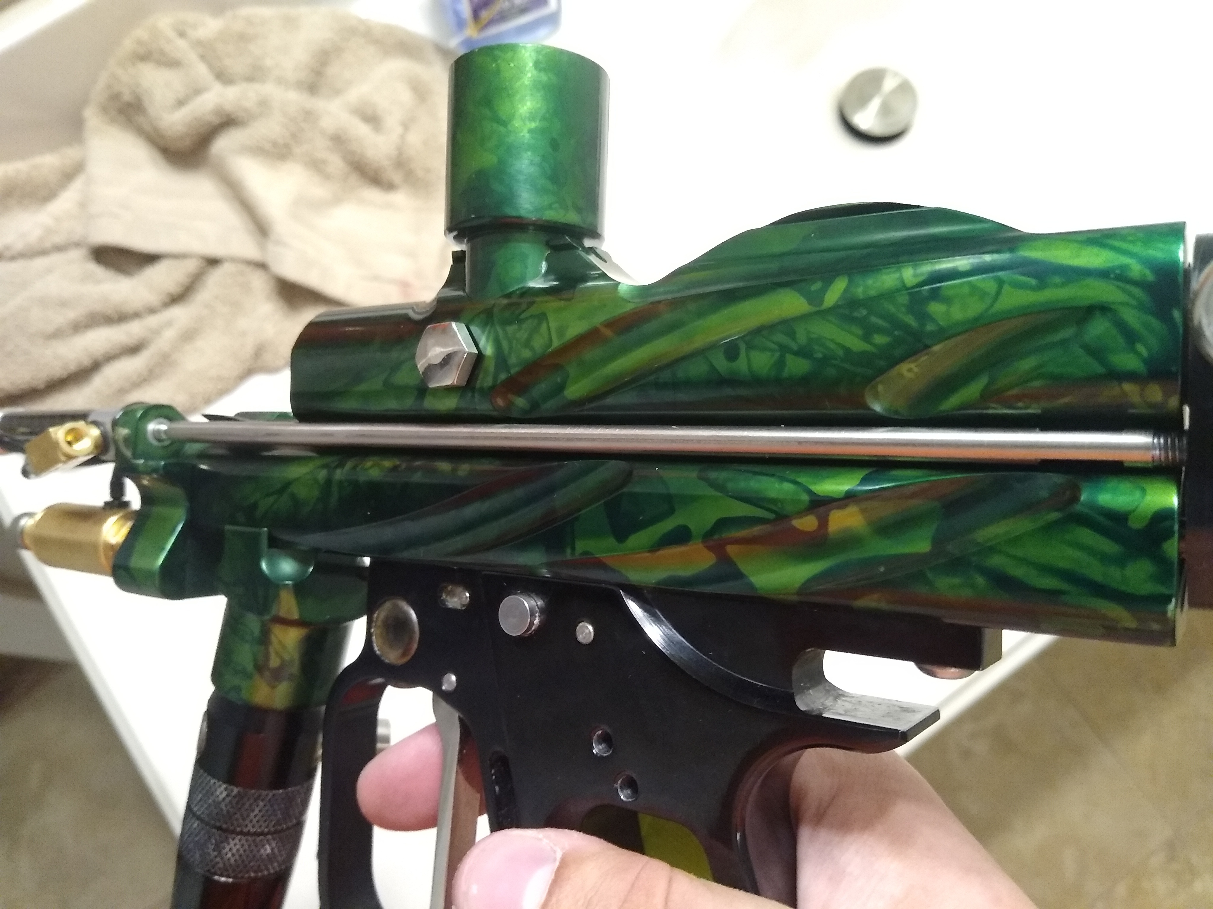

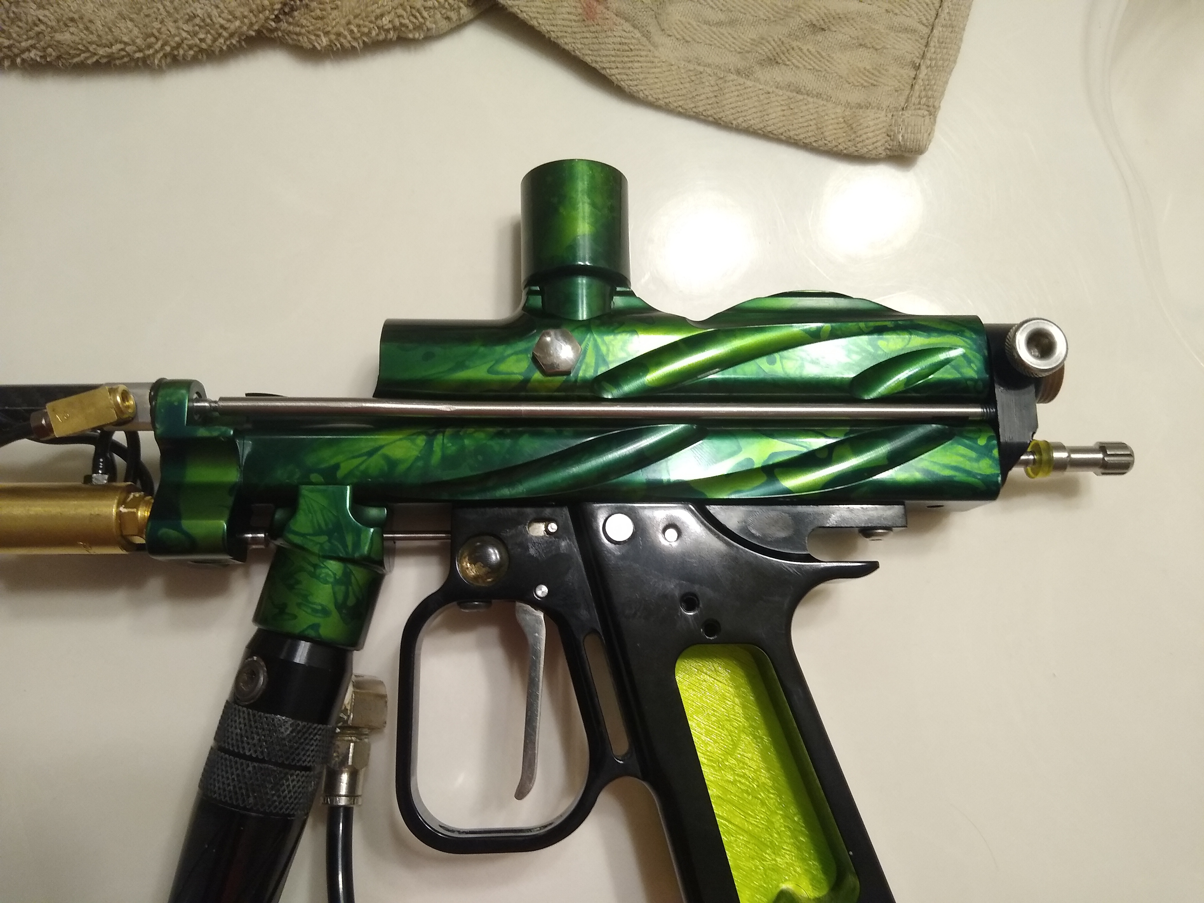

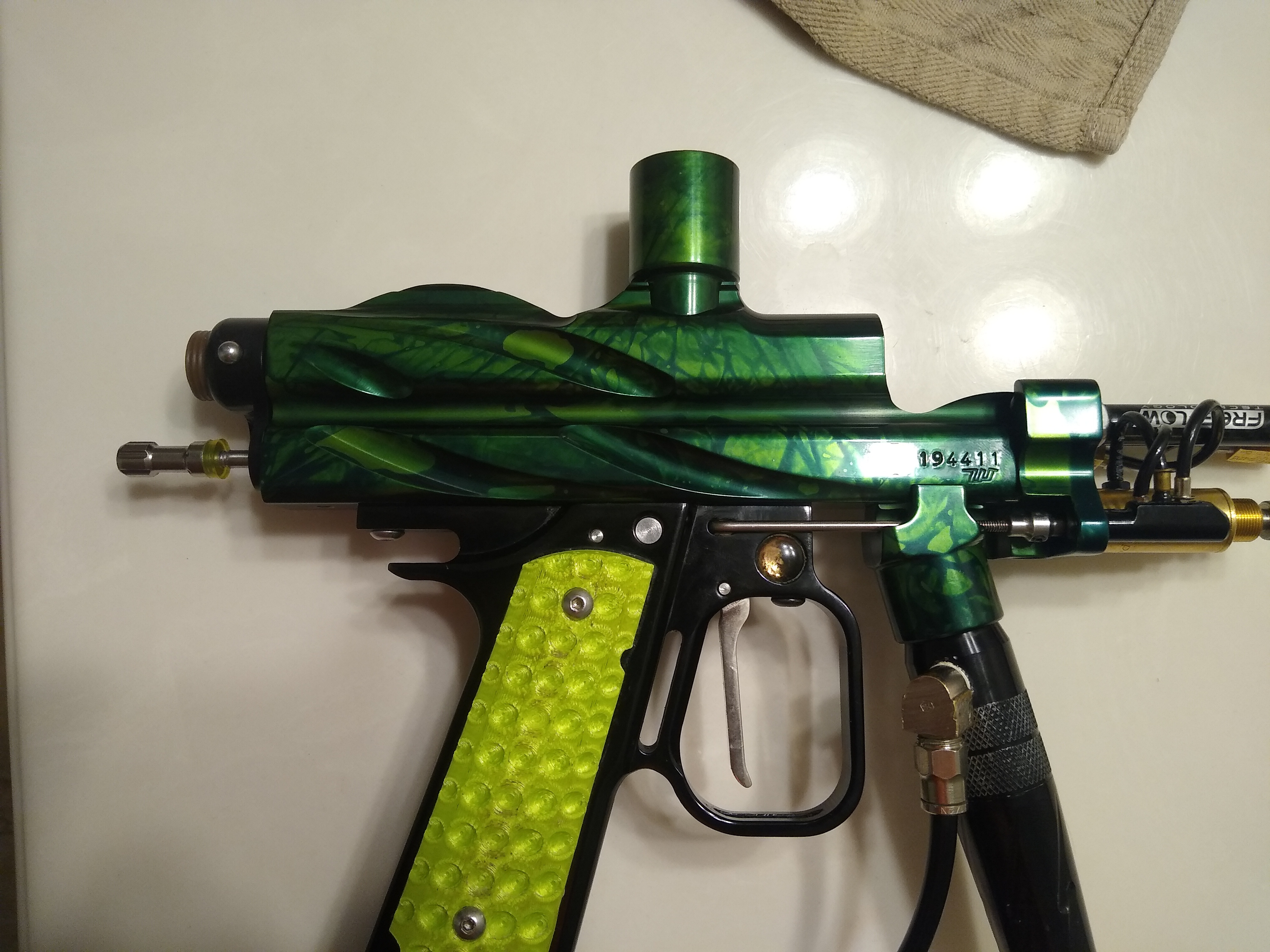

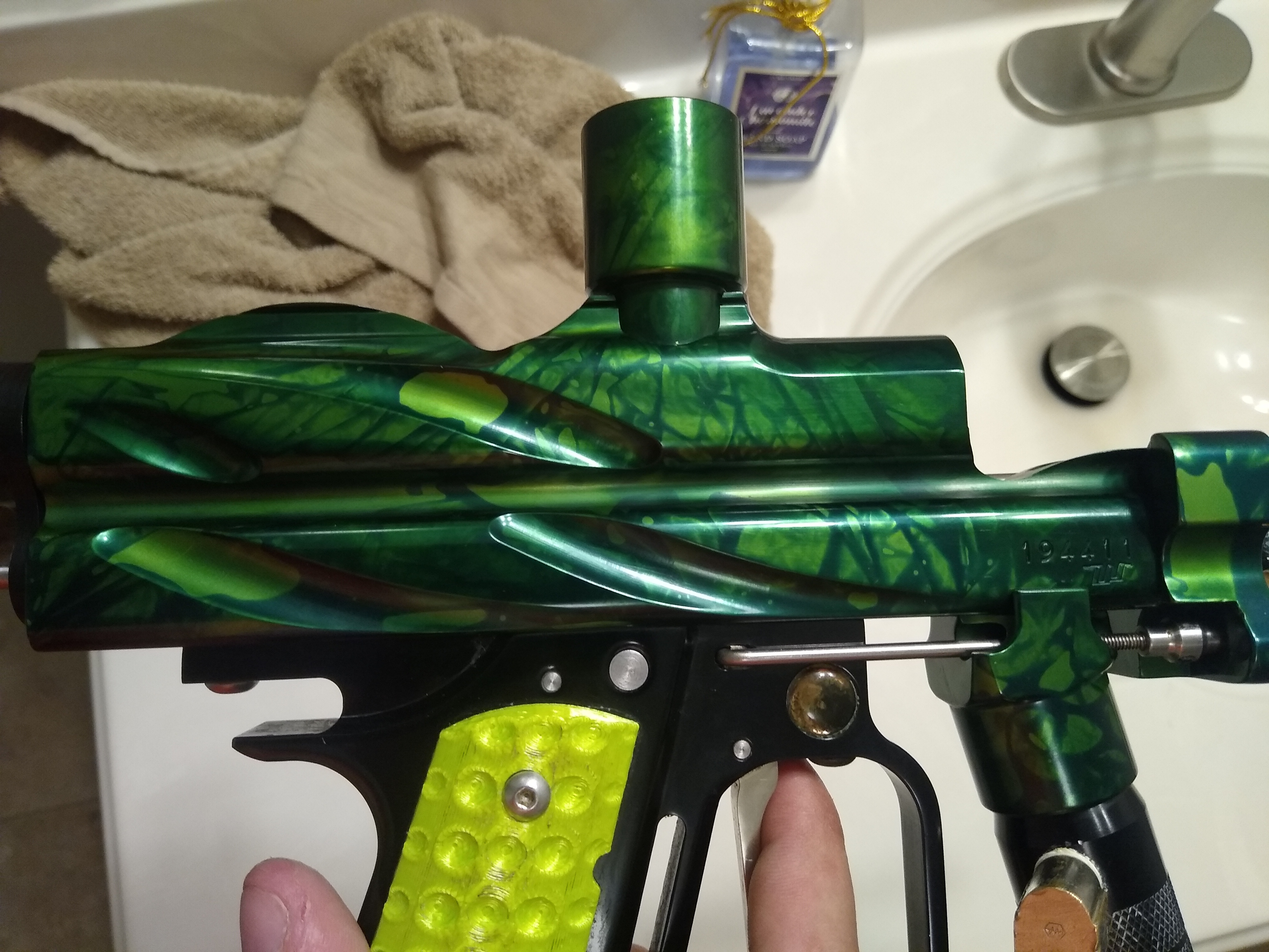

                      Been busy recently and haven't been able to make time to ano lately but today I had the day off school and was able to get this one done.
                      IMG_20231110_220506656.jpg IMG_20231110_220415895.jpg IMG_20231110_220514716.jpg IMG_20231110_220447032.jpg IMG_20231110_220456964.jpg IMG_20231110_220431463.jpg
