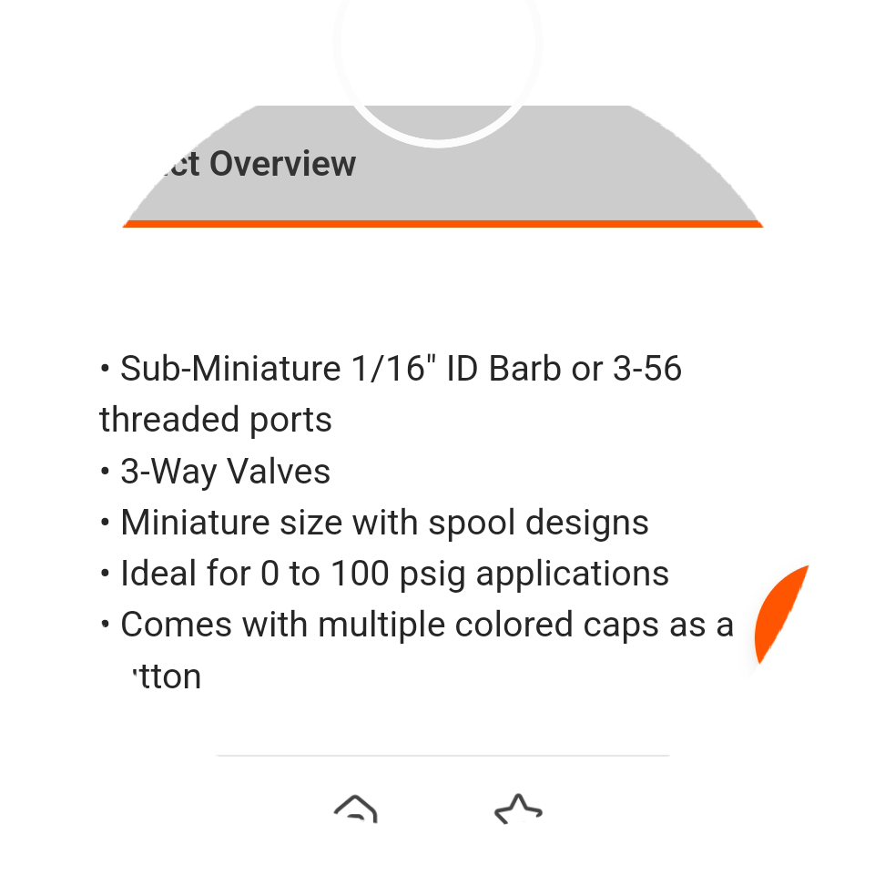

        • 3520
        3-56, same as the OG Shocktech Bombs.
        If you need one, there are only ever two being used on a SMAV so you can always swap the unused one to the port you are using. (If you lost one.)

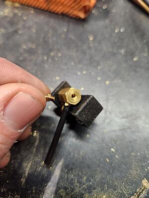

        • JeeperCreeper
          JeeperCreeper commented
          I was hoping to find an elbow or swivel elbow fitting, but I haven't found anything yet.
          Jordan commented
          Metric equivalent is M2.5x 0.45, maybe that will improve the odds?
