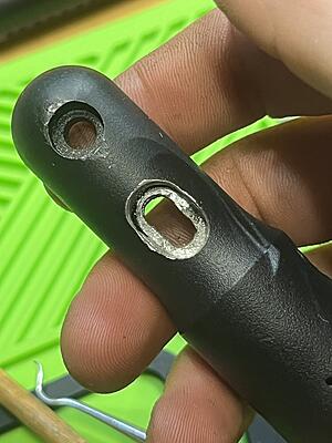

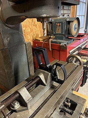

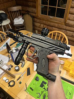

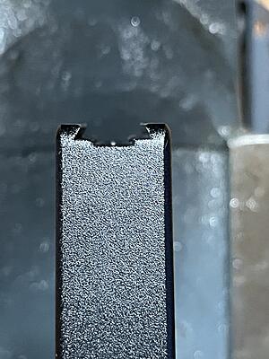

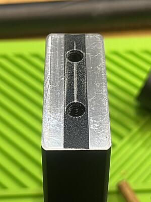

    Had a couple hours tonight and decided to rebuild my Lotus Faucker, when getting ready to put everything together, I remembered the grip frame has a non standard asa mount, kinda like a reverse dove tail, to make it worse, the hole spacing isn't normal asa spacing either. I milled the frame flat and then found an old ion asa thats also flat on the mounting surface compared to other duckbills that are more curved which of course don't fit this frame because of the longer profile on the rear of the grip. Ended up milling a longer slot so I could mount the asa properly. Now this frame is actually fieldable and I'm gonna try using it at ION this weekend.

    Looks similar to the keyed mounting track on the Diablo Wrath, although those had standard 3/4" AGD/WGP mounting holes underneath.
