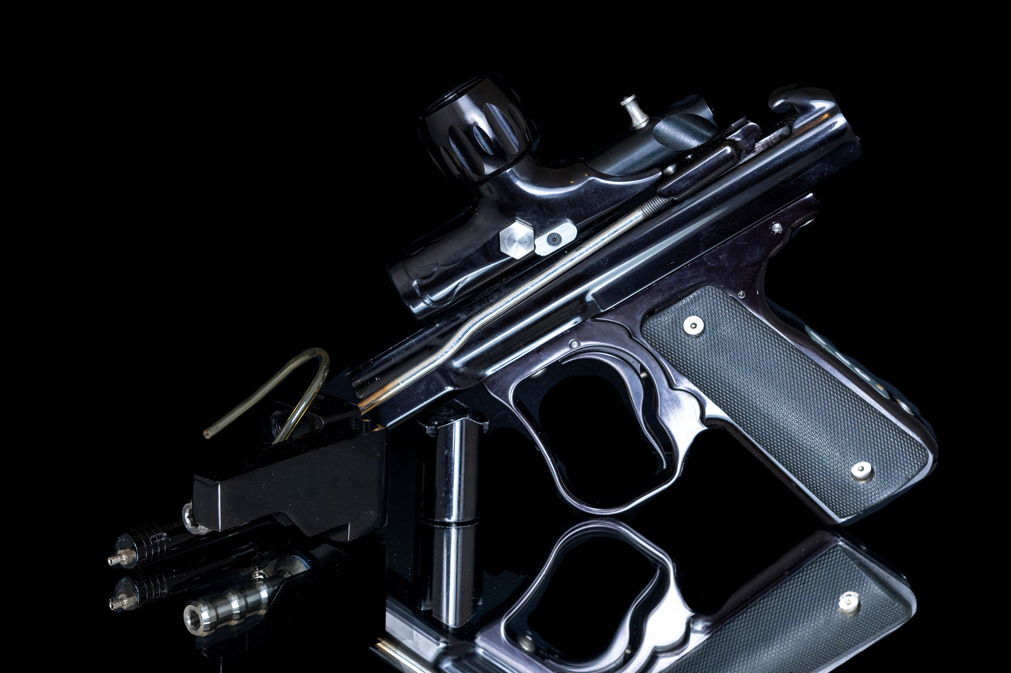

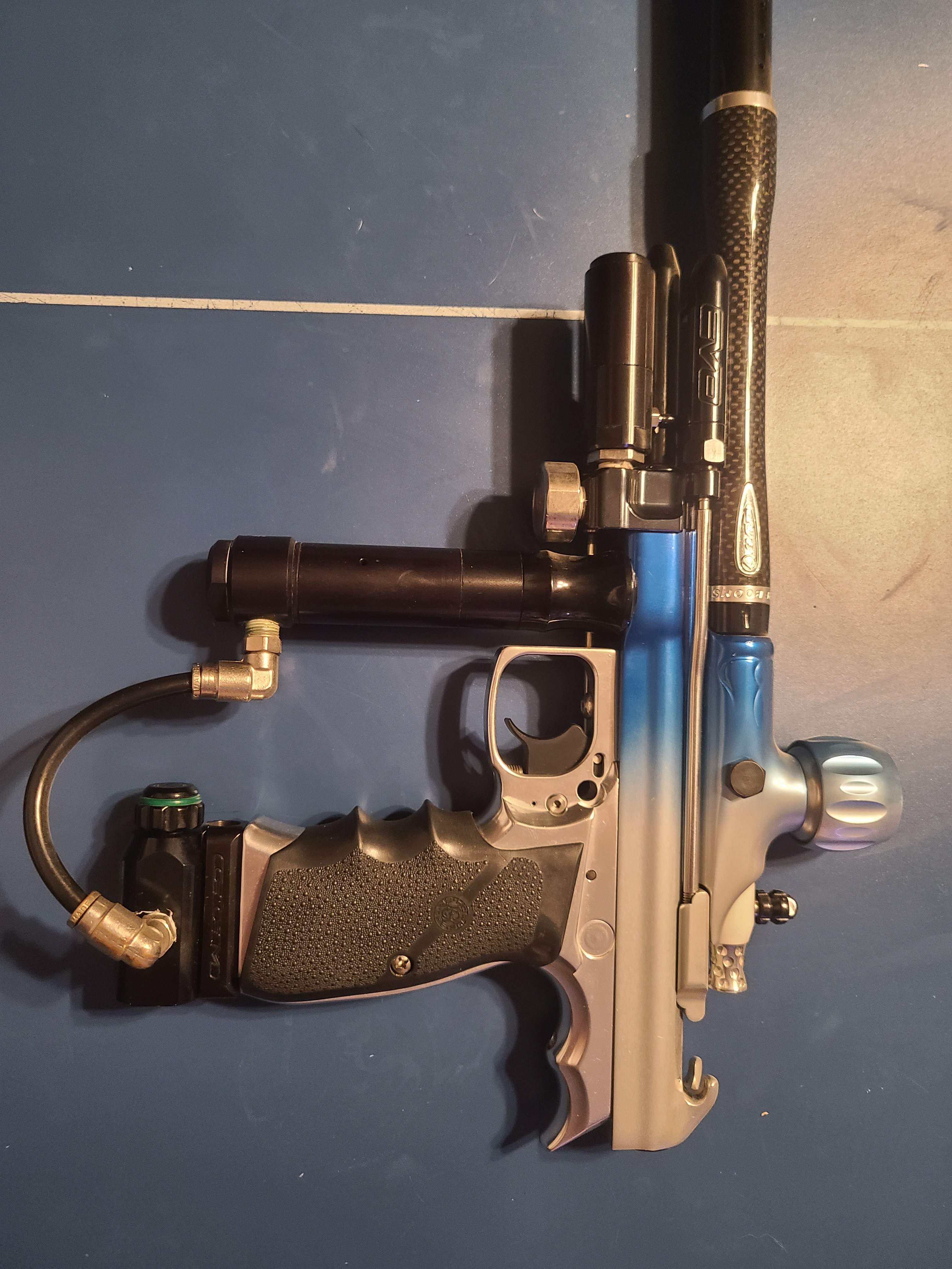

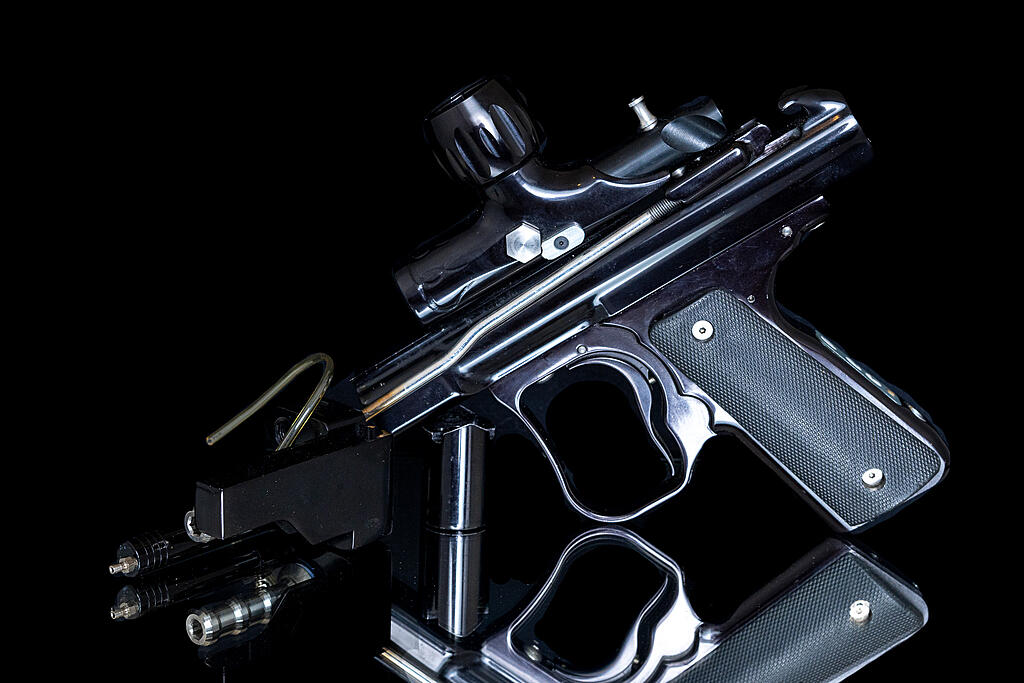

    It's time this thing saw the field again...
    But here is my dilemma. I know crap about Raceframes. I just bought a solenoid, but the battery is probably junk (haven't opened the grip frame yet), nor do I have a charger for it even if it was good, though I'm sure I can procure one.
    Choices are as follows:
    1. Rebuild it with the raceframe and parts I have now. Jump through any raceframe hoops that is needed.
    2. Use my gloss black E-1 frame and solenoid. Will need a new front block. I have a new board somewhere for the E1 and if I can't find it, I do have a Scifi board that was supposed to go into my E-Blazer, but since that project has been on the back burner for longer I don't mind using it for this.
    3. Throw it all out and make it mechanical because batteries... pew pew.. I spit on you.
    Those are the choices....

                  Need one of these bodies

                    This is awesome
