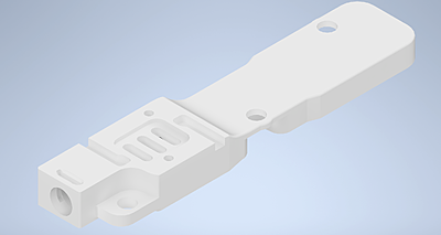

    Hi all! I’m new to the forum but have been working for a couple weeks on a manifold to convert the LV2 Solenoid to the Ego 11. I have gotten it to fit and designed a custom manifold.
    The solenoid airs up and pressurizes the bolt, however once it does air starts venting from the two outer exhaust ports on the solenoid (marked with red arrows in the photo below). The solenoid will cycle the bolt on trigger pull but the shot is a little bit weak.
    here is a video of the problem; you can hear the air venting at the start of the video:
    https://www.reddit.com/r/paintball/s/KbIuMzZU3G
    Note that the gasket which has the inflow and outflow ports to the marker is not leaking and the sound changes as I adjust the slotted screws on the LV2 solenoid. If I adjust them all the way shut the marker depressurizes slowly so I don’t think I can block them off.
    The marker fires perfectly fine at 280fps with an Ego 11 solenoid on there with no leaks so I don’t think the LPR or HPR need adjusting.
    I noticed the solenoid on the Ego 11 originally only had 3 ports and the Lv2 solenoid has 5 so my concern is if the marker is designed not to have vents on the solenoid for back pressures or anything like that.
    If anybody has any ideas on how to solve this or what the cause could be I would love to get some help on this.

      air is bypassing the ram oring.. rebuild the rammer..
      I'm a little confused by the comment that it fires fine with an lv1.6 solenoid, but not the lv2 solenoid, as I thought they were the same....
      The other thought I had was that the manifold is machined improperly... is it possible the gasket is deflecting allowing input pressure to bleed into other ports?
      edit** - Just saw that the manifold is SLS printed.. have you tested it to make sure it is air tight? I'm pretty sure it is not. If you genuinely think that the manifold can't be machined, I would try stabilizing the material.. put the manifold in a small container with uv resin and put into vacuum chamber then transfer to a pressurized chamber for a few hours, then put it under UV light after all that

        Ahh gotcha. Yeah it is possible it’s bypassing slightly. That would explain the reduced fps when it fires. I guess if it were venting from overpressure then it would fire at a normal fps. I’m having the manifold SLA’d and will check back in after that’s done!

      • 4372
      Just to back up things ...
      SLS prints are highly porous not air or liquid tight
      • devilzcall
        devilzcall commented
        This. SLS Nylon is amazing and can match injection molding in strength, but for Airtight parts i'd go with resin. If you don't have access to a printer i'd go with jlc3dp - 6060 resin.
      • LocalAcceleration
        LocalAcceleration commented
        This seems to be a common consensus. I’m going to get a part made with SLA to see if it will hold

      Also I’m sure you could get the manifold machined given a little design creativity… manifold and have a sub plate mounted between the manifold and the solenoid using either seperate screws from the solenoid mount to secure, or longer solenoid screws.. depending how creative you wanted to get.. a little RTV compound between the subplate and manifold would seal up just fine

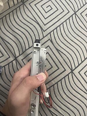

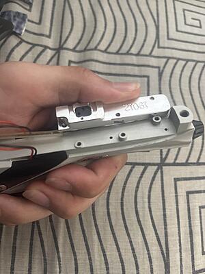

        It seems possible but extremely ill-fitted to do that without a small leak or something. I'd be apprehensive about fitting the solenoid into the lower with it being so far forward. I matched the positioning of the rearward screws to that of the Ego 11 manifold. It also looks like the Lv2 mini-fold does not reach the forward port on the marker.
