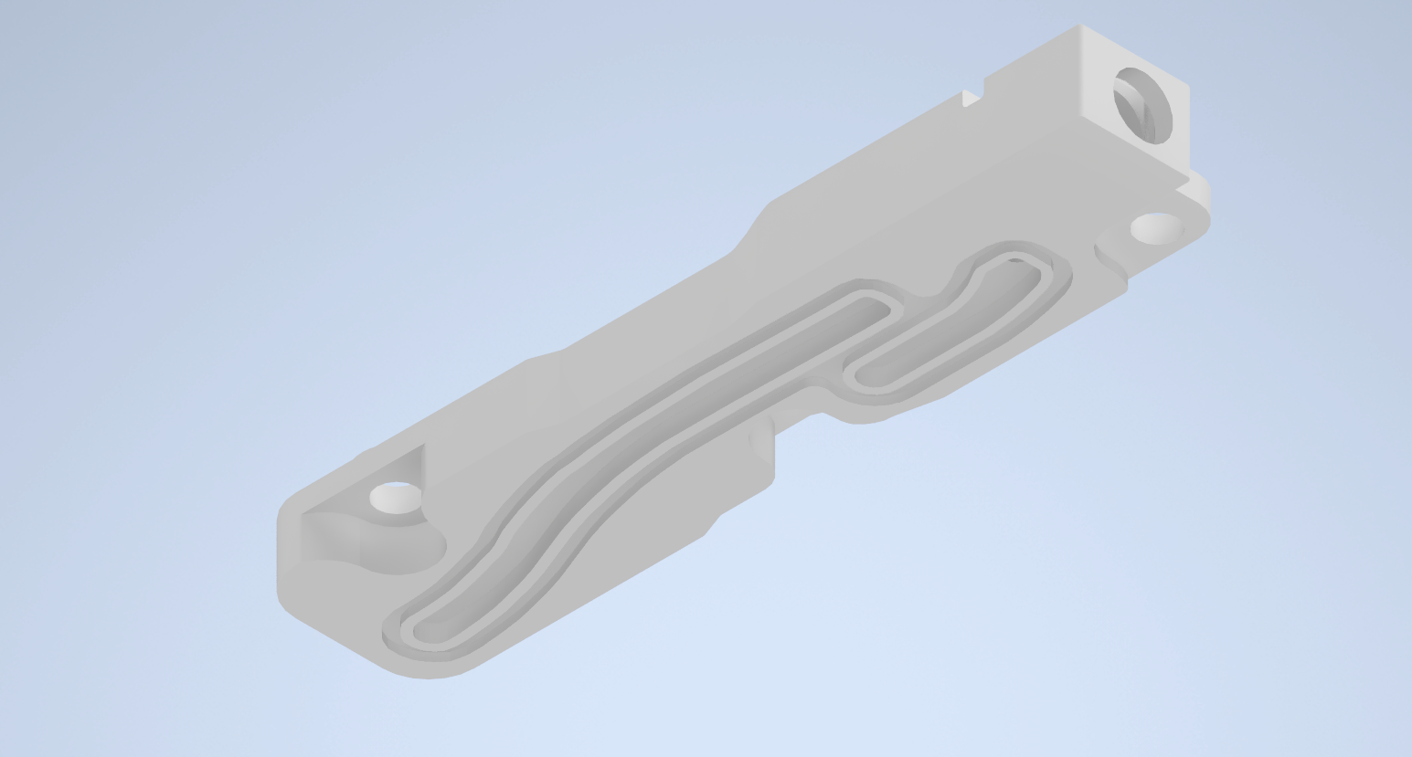

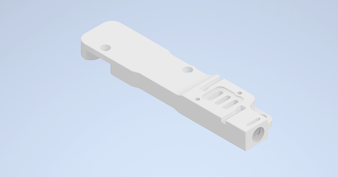

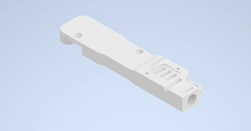

Manifold Design

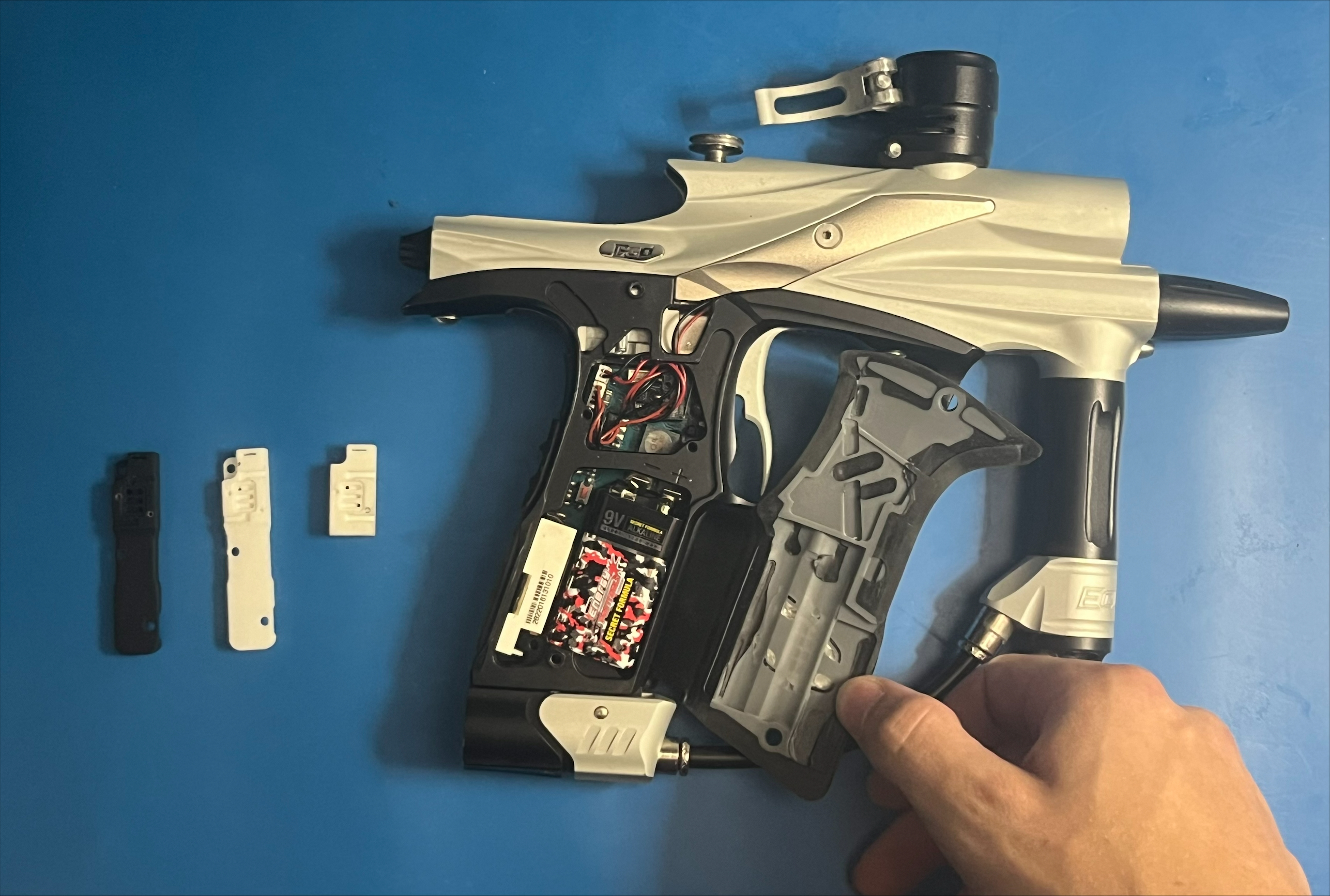

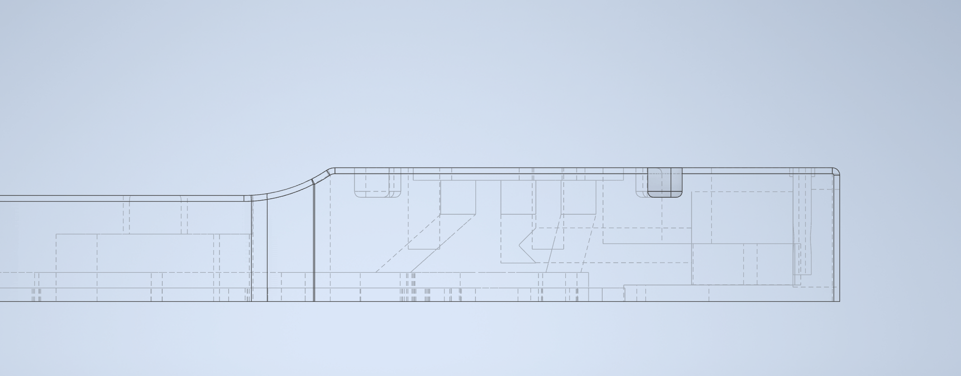

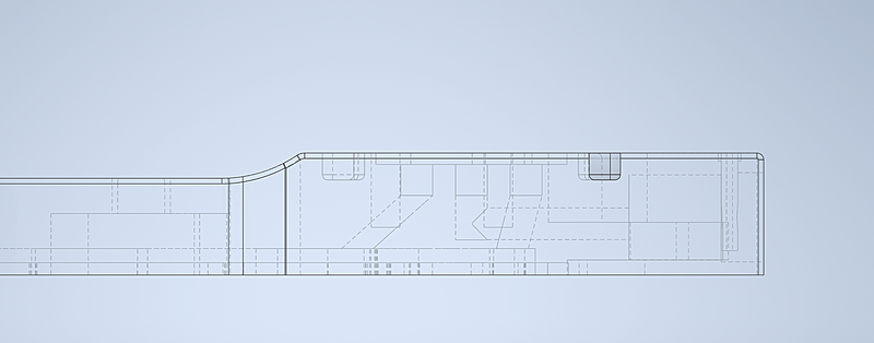

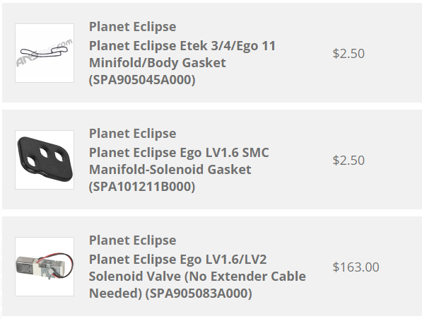

In order to build this I had to create a custom manifold for the Lv1.6 Solenoid to mount to the Ego 11 upper. This manifold will utilize the Lv1.6 Manifold-Solenoid Gasket, the Ego 11 Manifold Gasket, and the Barb, Retaining Hook, and Filter from the existing Ego 11 Manifold. I do plan on offering the manifold by itself for $70 (More on the reason for that pricing in a bit).

1. This conversion is not cheap. I really wished I could bring down the cost of the manifold or the parts but unfortunately that's not really easy to do because it needs to be custom manufactured on a 5-axis CNC. The holes connecting the solenoid ports to the marker-side gasket are not straight through holes due to the tight fitment in the marker making it impossible to align for manufacturing on a 3-axis CNC.

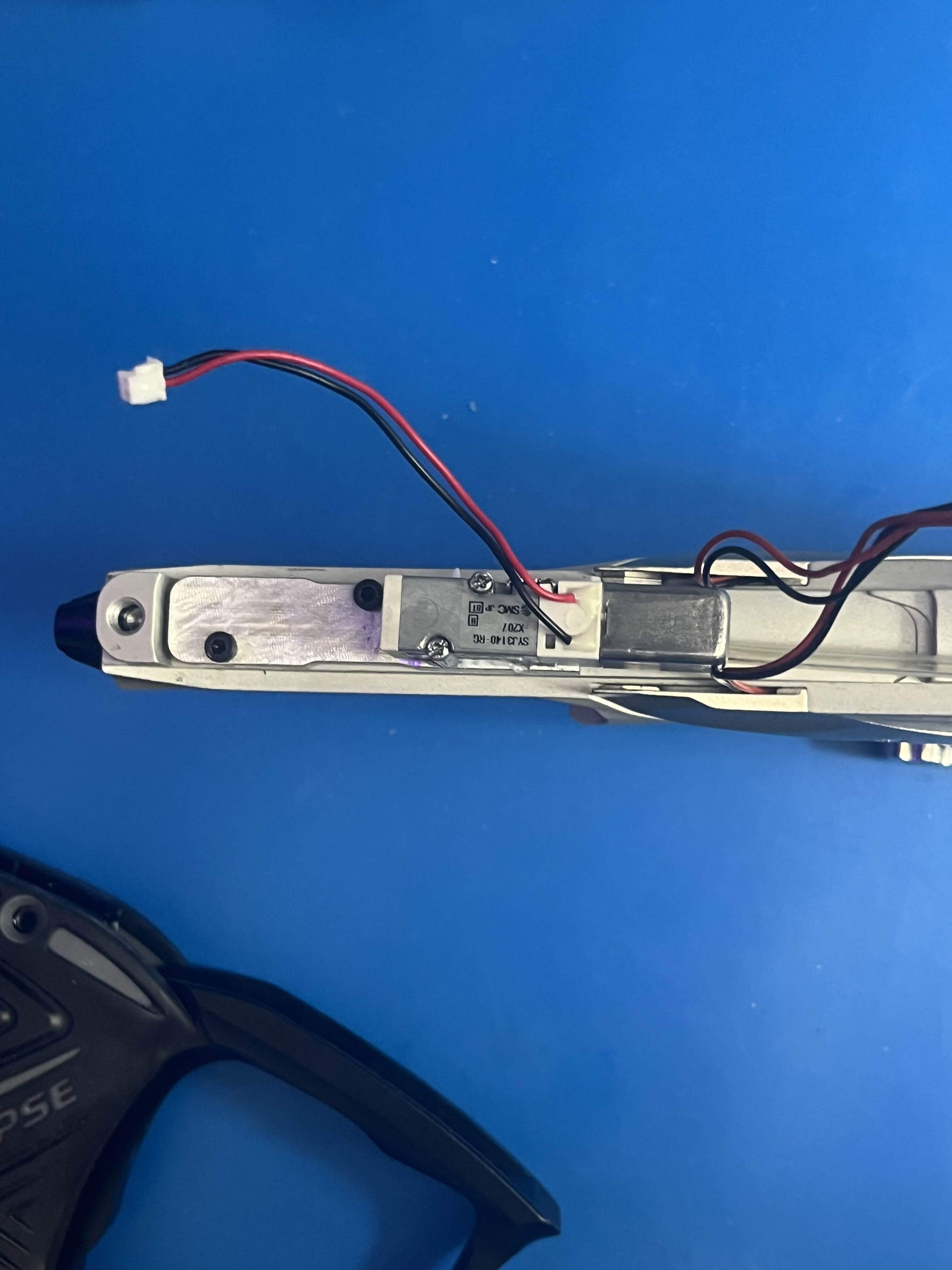

2. When placing the Lv1.6 Manifold-Solenoid Gasket onto the manifold. It is extremely important that you put a thick amount of lube on both the manifold side where the gasket will go and a thick layer on the manifold-side of the gasket itself. You will also need a thick layer on the solenoid-side of the gasket after you set it into place. Then go through and clean out the slots with something thin and small like a screw driver to keep them clean and unblocked. After you have done this you can then screw the solenoid into place. This is extremely important to remember if you ever do maintenance on the solenoid or manifold, otherwise your marker will leak air.

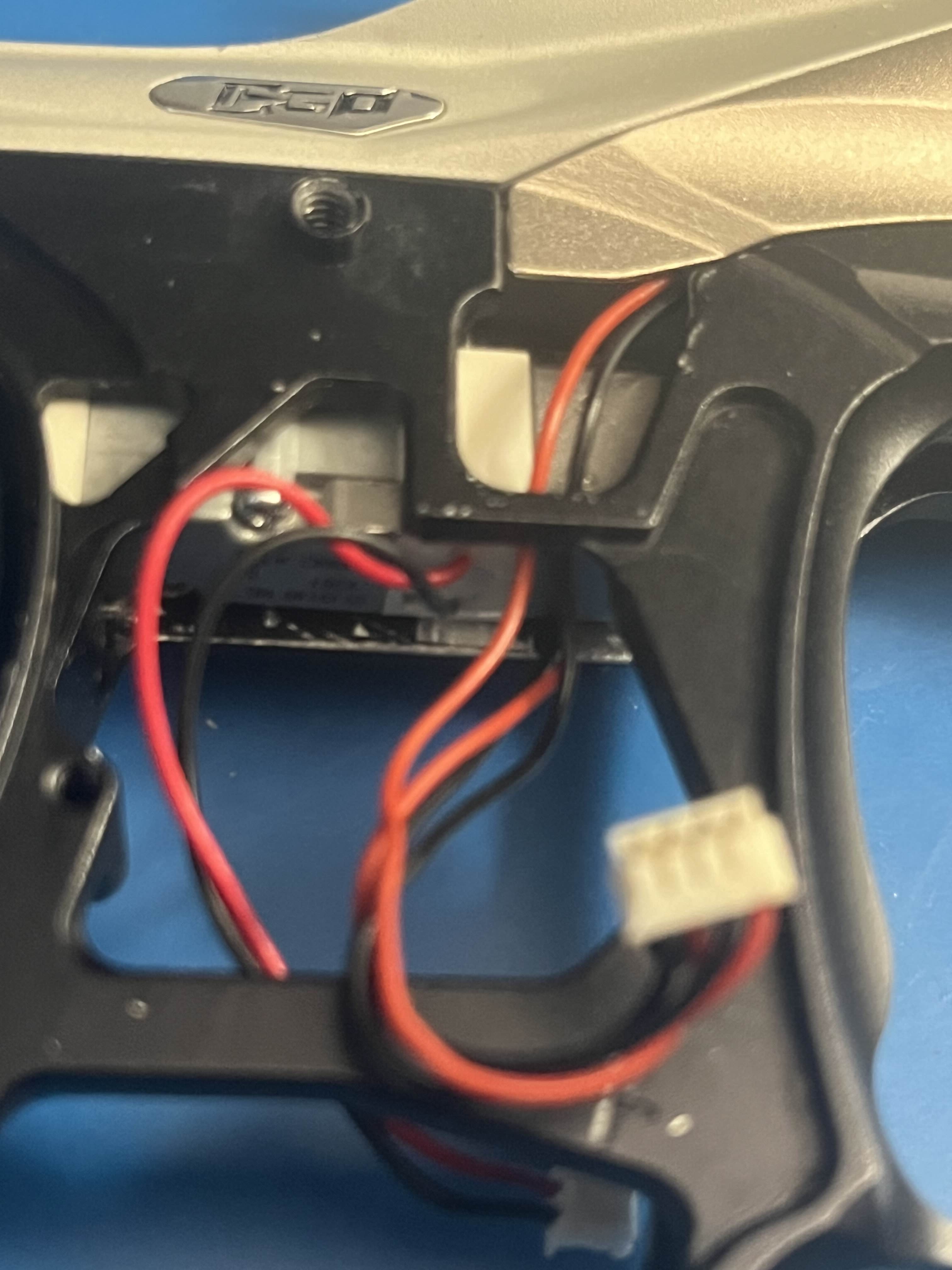

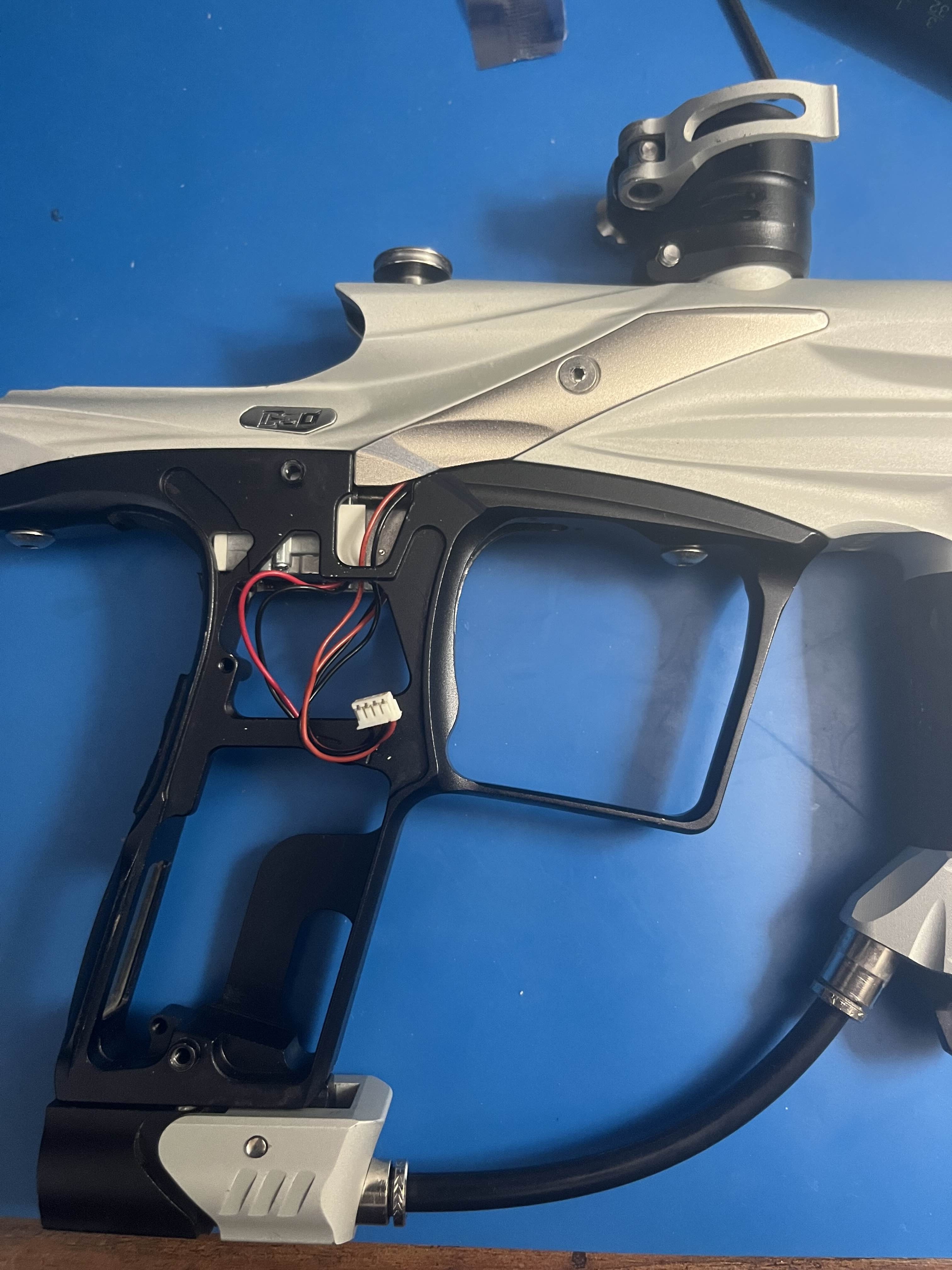

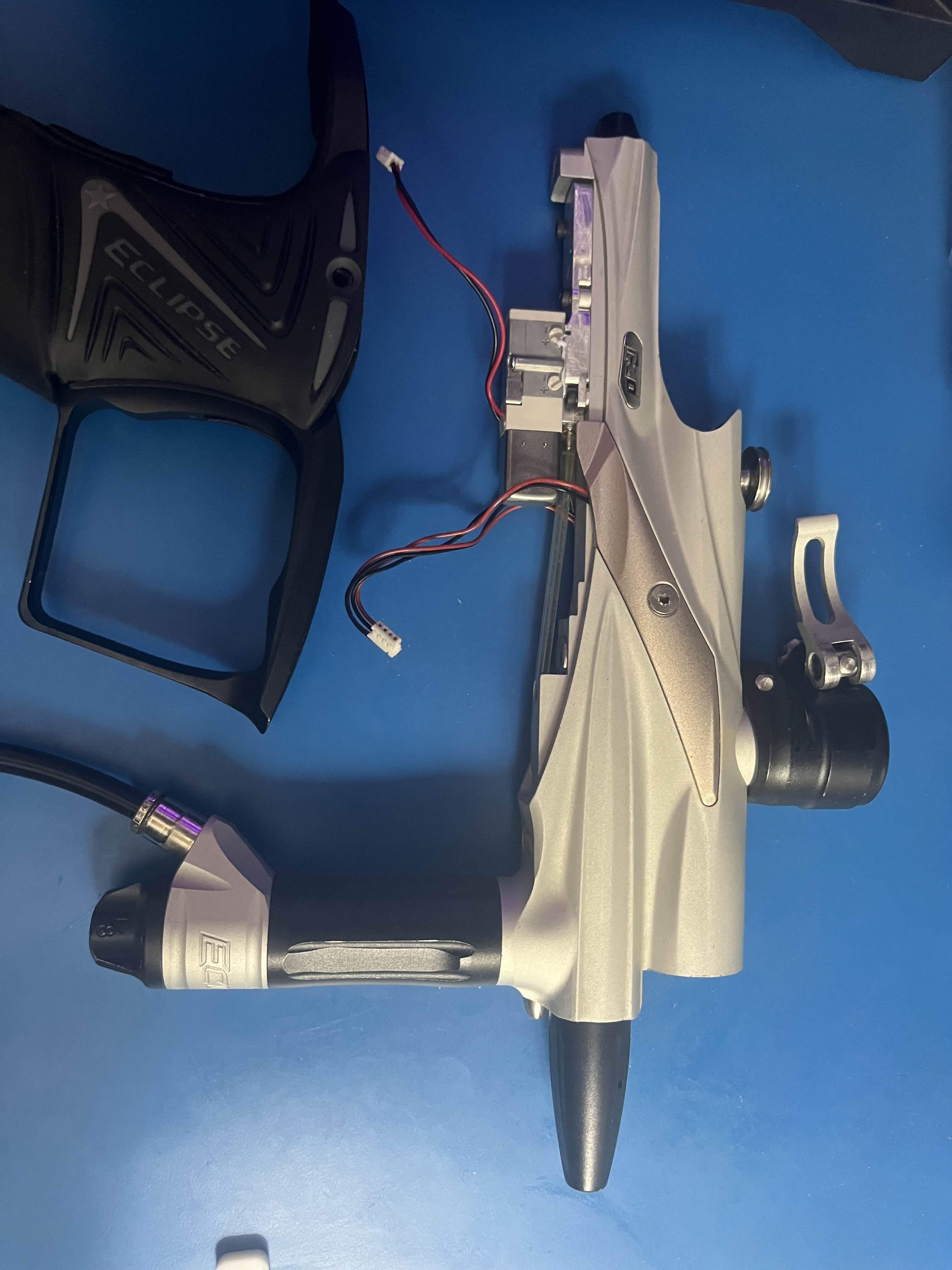

3. The Ego 11 board sends out a 5V signal to the solenoid to operate. the Lv1.6 Solenoid is designed to operate at a range of 2.7-3.3V. To fix this I have soldered up a voltage step down circuit to jumper cables so it can be plugged into the board and then the solenoid can be plugged into the step down.
If You Would Like a Conversion on Your Ego 11

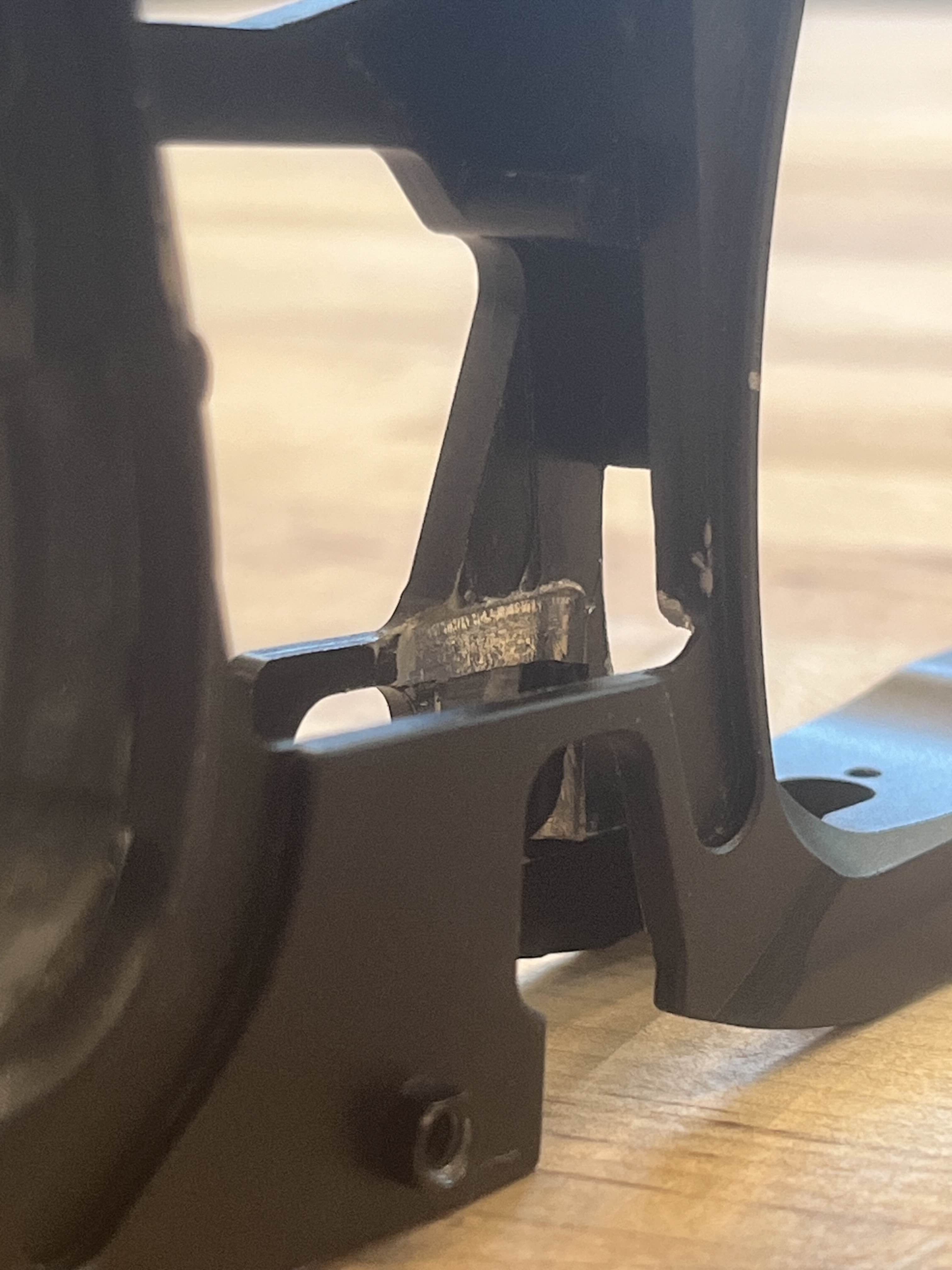

I do plan on offering to do the conversions for people for $300 plus shipping. As mentioned earlier, I do need the following parts in order to make it work along with about $50 to produce the manifold. The total cost to produce a working marker is around $250 for me and everything else goes towards obtaining materials, time, and the milling work that needs to be done on the frame to fit the solenoid which I will include a photo of below. My goal is to help people keep their Ego 11s alive and I'm not really setting out to make a whole lot of money off of this so please be patient. I expect each conversion to take a couple of weeks as I am also employed full-time.
