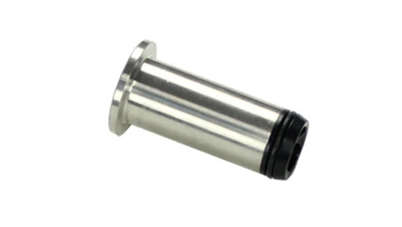

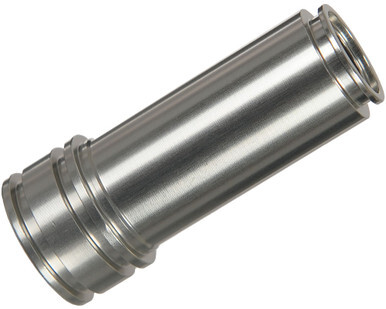

    I have no clue where this is coming from but I think i have seen or heard where the bolt from an invert mini, empire axe or any other of the 900 markers with that bolt will fit on a tipx.
    I think it would need modified a lot and might not be worth it but for some reason I just can not get it out of my head that it works and come to all of you to help remember the lore that was lost.

    It may just be that the TIPX can use the spring from an invert mini and not the bolt if that is the case I think i have my answer.

      Completely different drive systems.. tipx drives off a center piston like a mag , mini drives the bolt forward off the back of the bolt. However they both operate off a pressure controlled piston to initiate the firing sequence

        Make it a pump tipx and operate the bolt manually.
        Then the drive system won't matter as much.
        Removal of the bolt spring, and adding a way to interact with it is all I did. You'll have to mill the breech and side of the clamshell.

              Well I was not really hoping to achieve anything but better efficiency at a cheap price since i have many invert mini bolts. A couple of them being delrin and couple aluminum and if they would work with just the back shaved and help then i would shave them and try it since they will not work I think i will shelve this thought and call the bolt good.
