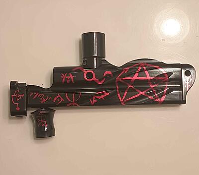

Doom inspired cocker build
  • jetenginekyle
    • Jun 2023
    • 580

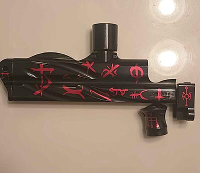

    Finished anodizing it tonight, my phone died so these are the only pics i have at the moment. My goal is for this to be a walkable mech by making use of novas piloted 3 way.
    The rest is
    • nova lower tube
    • clippard lpr
    • empire ram with qevs
    • azodin hpr
    • wgp swing frame
    • shochteck bolt
    Cant find a socket that fits in the lower tube for the nova valve, which one should i buy?

    No socket will work, it has to be a nut driver, and only specific brands of nut driver work.
    Harbor Freight "Pittsburgh" branded ones are what I used.

    Had to grind the lpr a bit to make it fit, hopefully that material isn't structural.
    The mufflers make the qevs too big to fit under the barrel so unfortunately they have to stick out the side
    Gonna either have black grips or dye some clear stickies red as well as a delrin bolt pin that will be red
