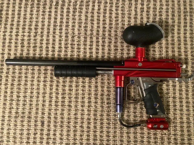

    Hello!

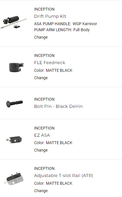

    I'm just wondering if i was to grab this marker and put some money into it if these are the correct parts i should start to upgrade.
    would love some input from you guys!

    you will have to have the feedneck milled to accept the FLE feedneck.

      Hell I'd play with that as is.
      That feed neck is non removable. So unless you send it to get milled into an empire stub, there arent really swap in options.

        You don’t really need to buy any of that.

          You'll want a full body 2k+ pump kit instead of the Karnivore one. You'll also need to get the body milled to use a new feedneck and there isn't really any performance increase to be had in getting that delrin bolt pin. The price on the gun itself is a little high. It's worth more like $200.
          If you do end up getting this I have a good condition Inception bolt and probably some other parts if you're interested. I'm pretty sure you're local to me.

          I'd get a proper return spring for inside the pump handle. A single trigger frame. A CP one/off ASA. Rebuild the reg if needed.

            I’d look at a Slice kit, Autocockerparts.com has them. I did not like the drift pump kit handle at all. They do have a genesis pump kit which is a cheaper option that has a different pump handle.
            You’ll need a barrel kit as well. Cockers/Snipers are closed bolt, so if the barrel bore is too large the ball is just going to roll out of your barrel.
            Set a budget and look at what the cost is to do these upgrades verses buying a more expensive pump marker. Each ID part is about $100, so you’re looking at adding several hundred to that marker. For that additional price you may be able to get a nicer built pump.

              I would get the body modified to take the inception feedneck, and a single trigger frame and barrel kit and call it done. No need to get too crazy into upgrade parts on your first pump.
