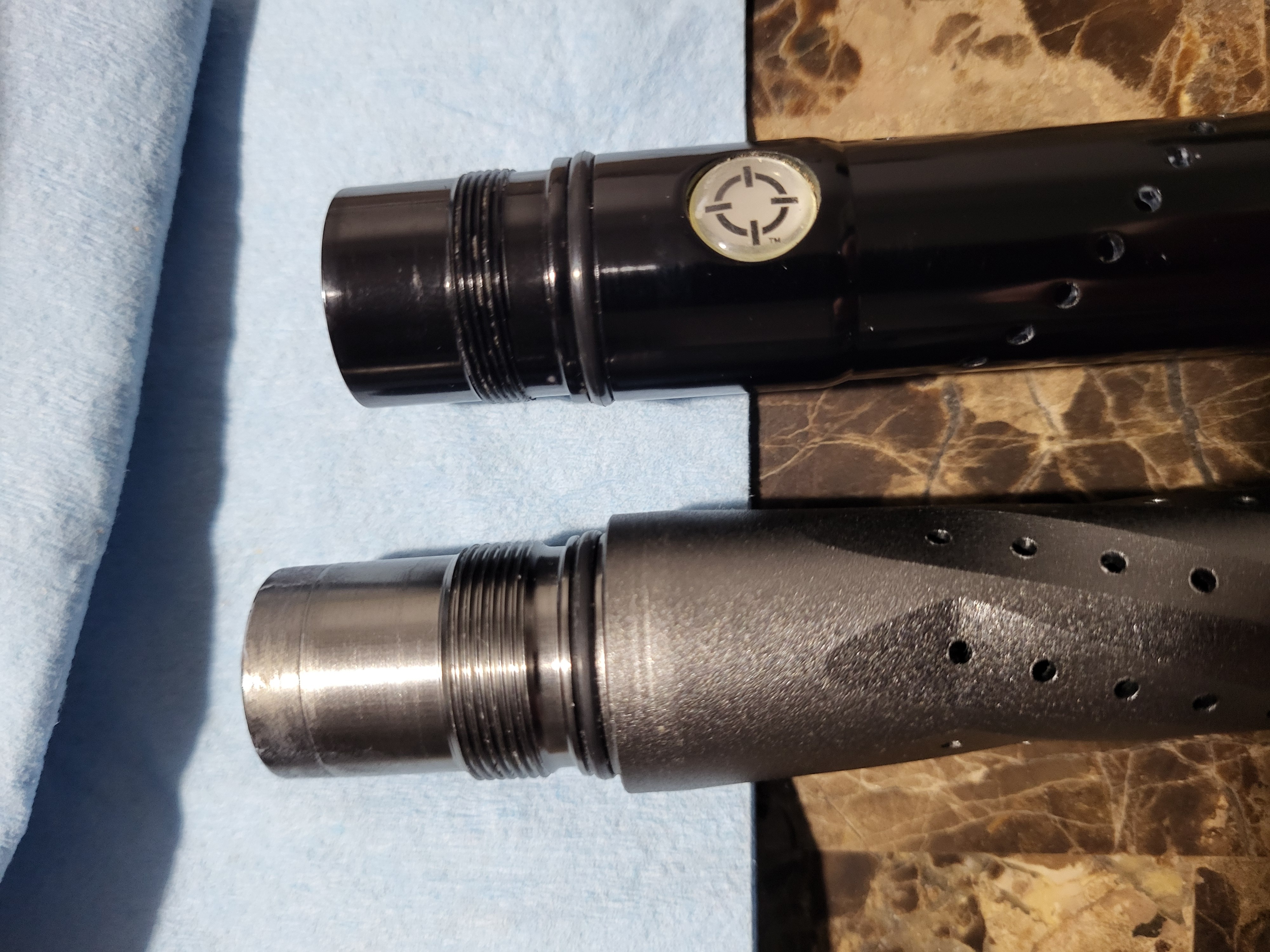

    Can someone please point me in the direction of someone that can take a Spyder Electra barrel front and rethread it for the Freak?

    If it's possible, BMC. https://www.bmcfabricationservice.com/
      • 4185
      BMC is the place for this. He has done many different barrels to Freak tips.

        BMC does not currently have the tooling to cut the leads.

          Try asking DocsMachine.

            The machining and threading is easy, the question is whether the Spyder has enough 'meat' to cut the new threads into. Quick look at the specs says no, there isn't, without some sections getting dangerously thin. I might be able to 'sleeve' it, but no guarantees.
