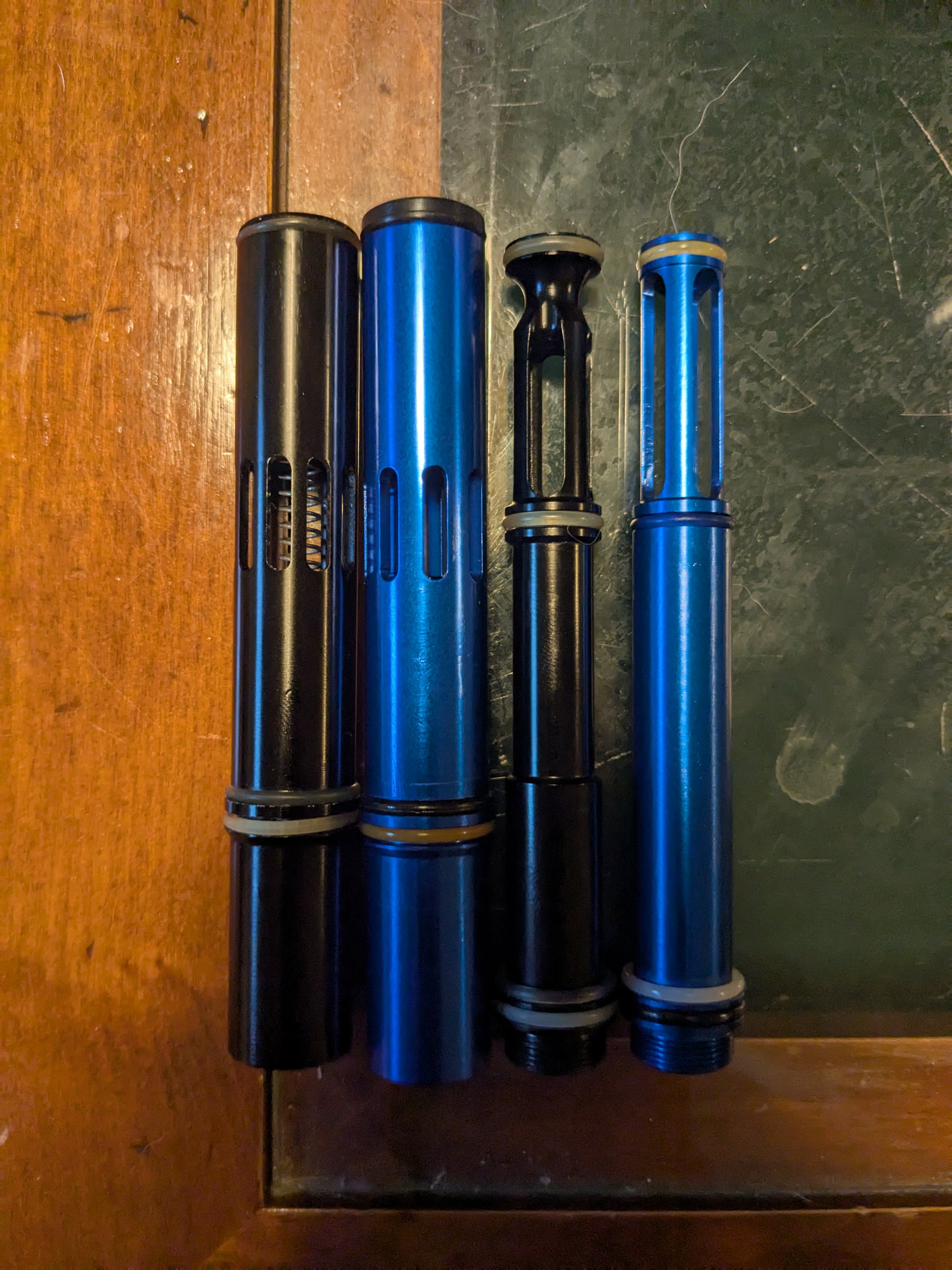

    side-by-side comparison before modification (Luxe 2.0 parts are black, Vanquish GT parts are blue):​

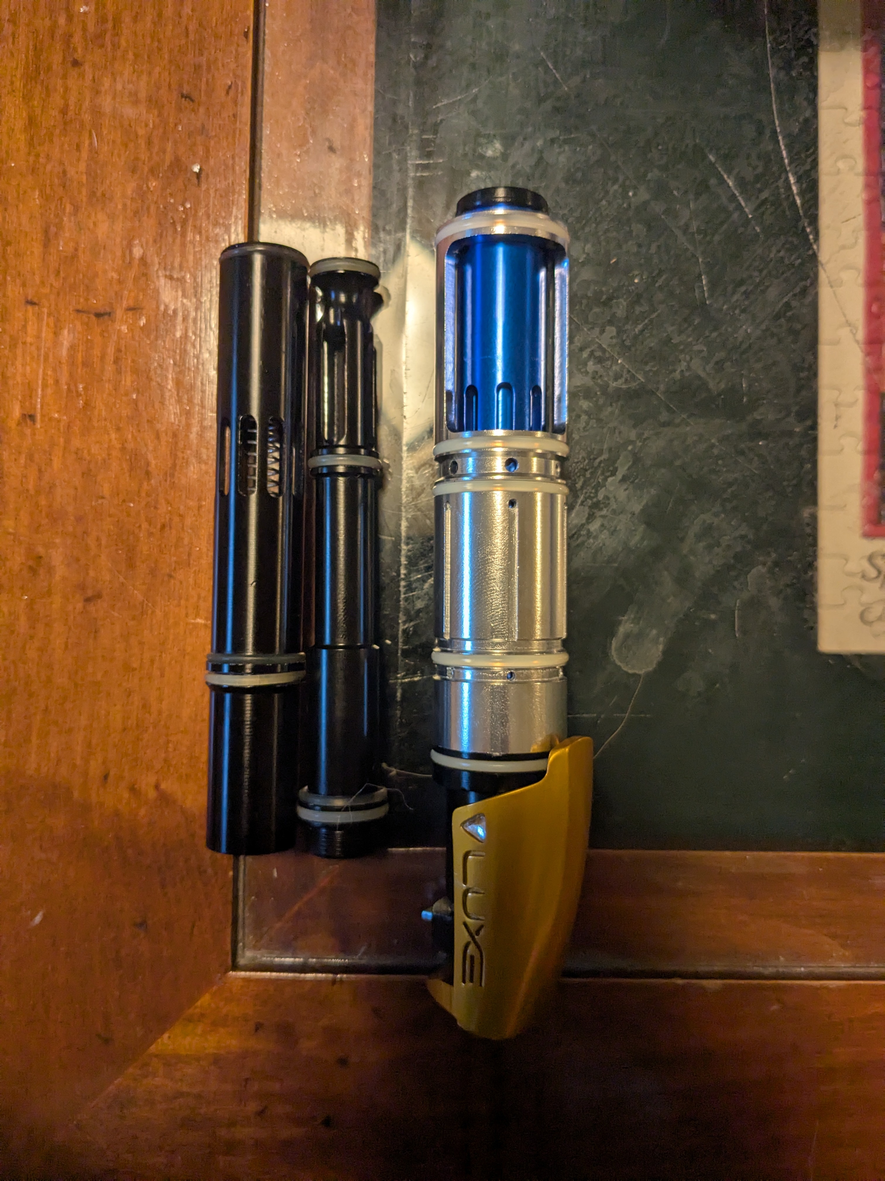

    un-modified Vanquish bolt and powertube in the Luxe engine (the Vanquish bolt is slightly longer)

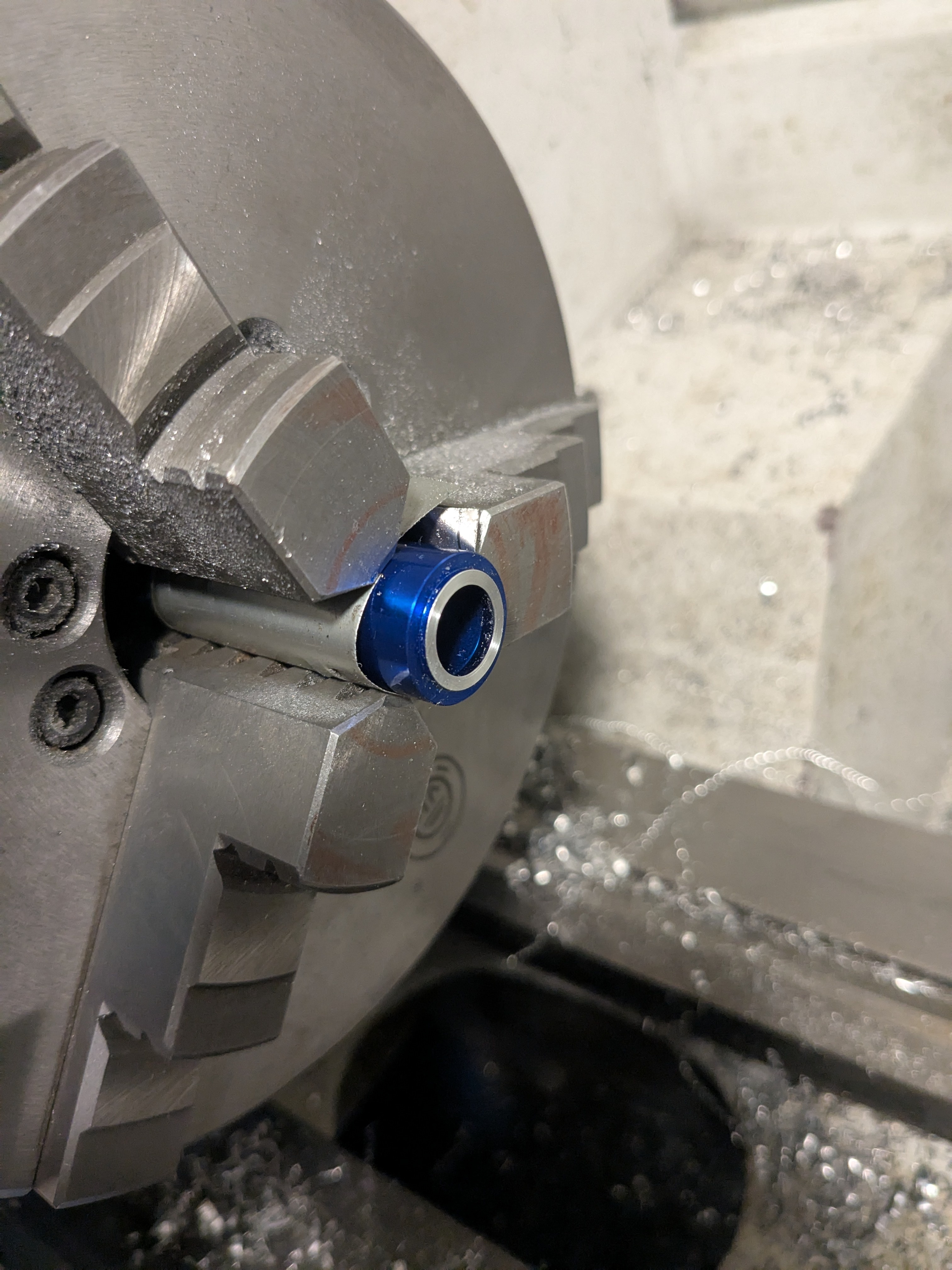

    trimming down the Vanquish bolt​

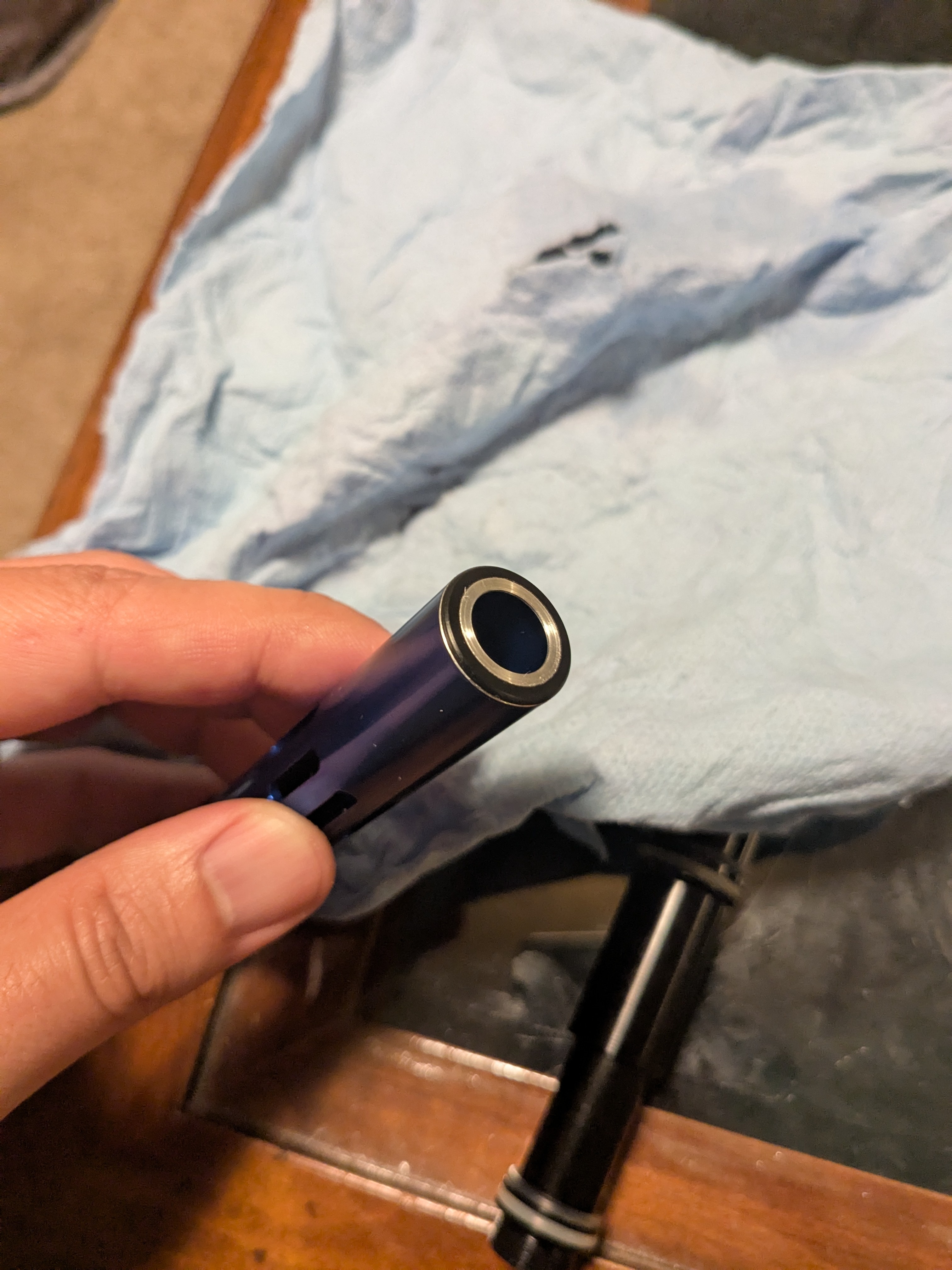

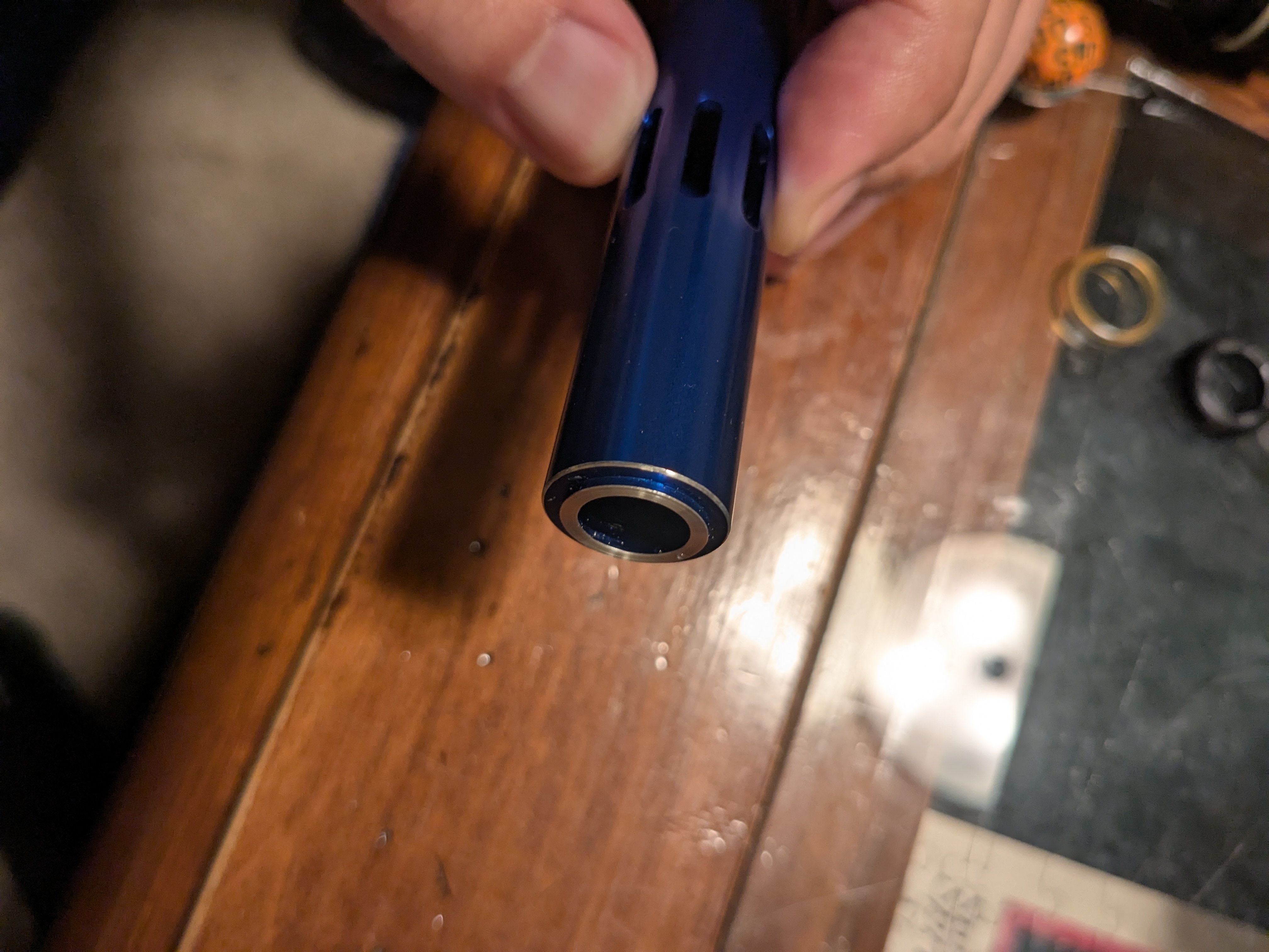

    Vanquish bolt after trimming
    adding a Delrin spacer to fill in the partial oring groove void left behind

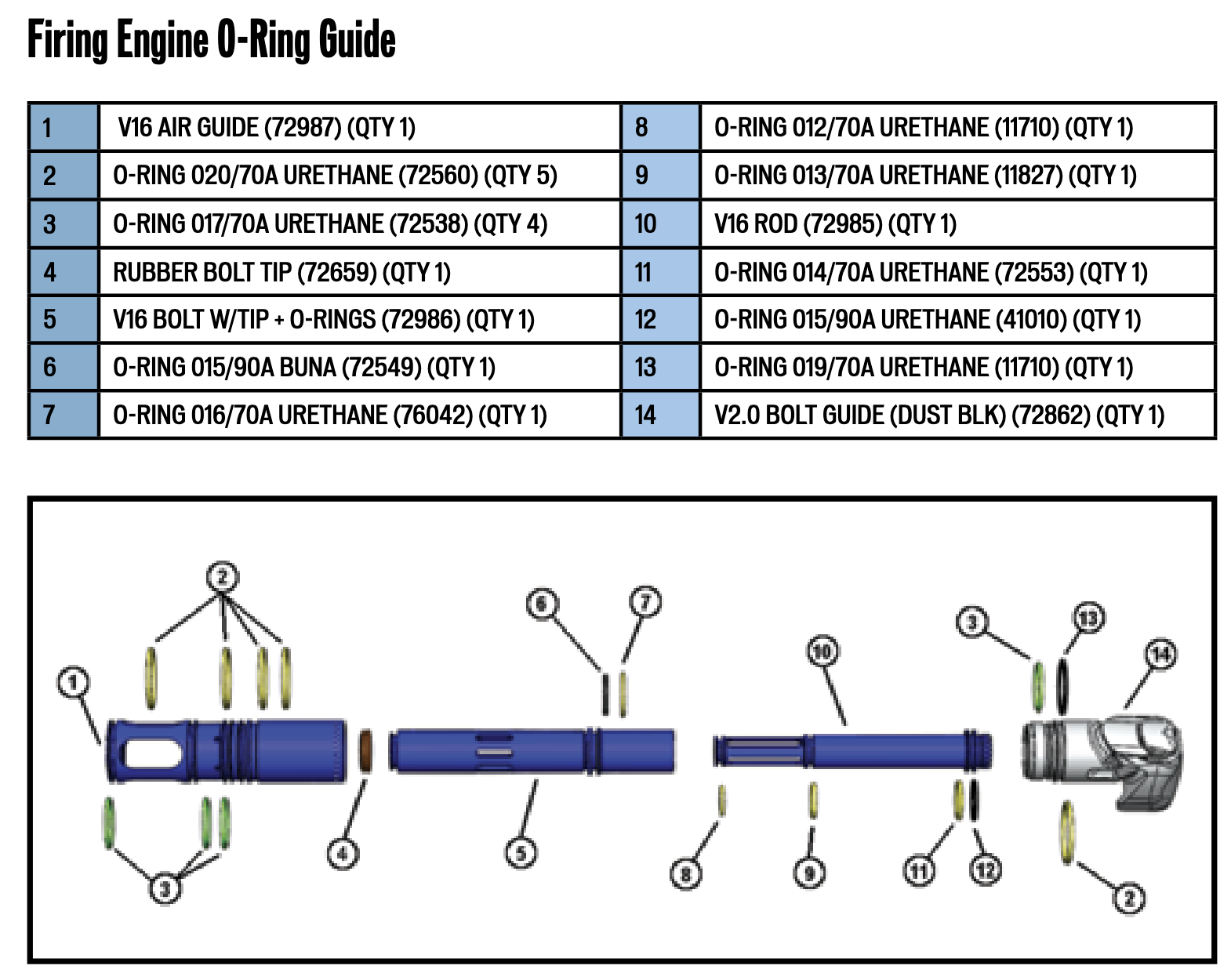

    for reference, this is an oring diagram of the Vanquish GT bolt engine (also sold as the "V16" upgrade) showing the different sizes of orings on the powertube that results in a forward air bias
