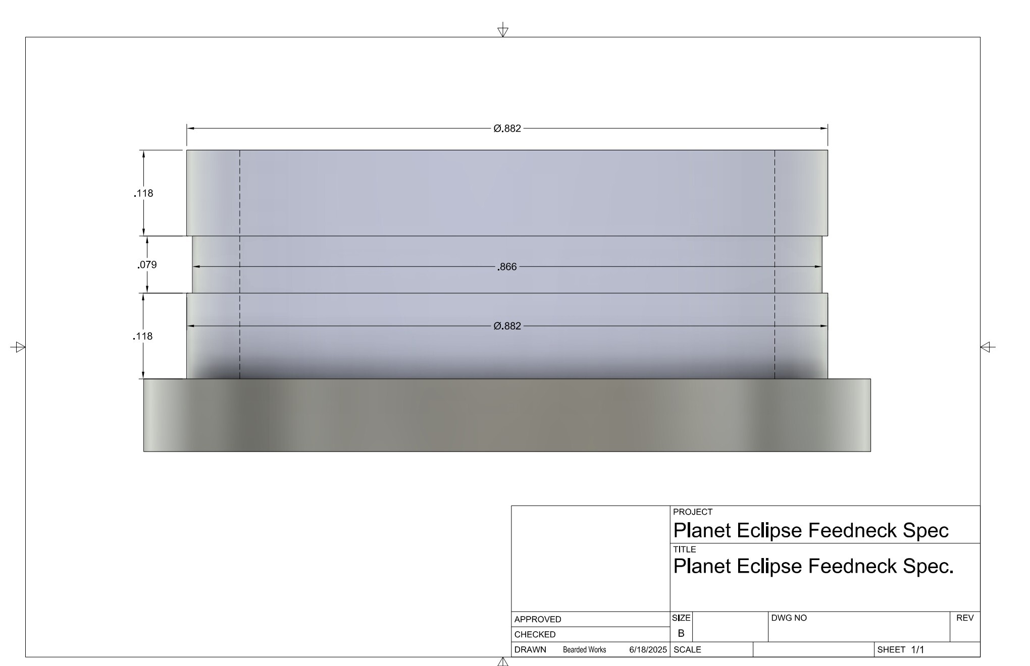

    Anyone have a PE feedneck boss they can measure for me? This is what i am getting off of the feedneck itself, but some verification would be nice since it is hard to measure the internal locking groove.
    0.885" OD
    0.875" Groove OD
    0.125" up
    0.050" groove height

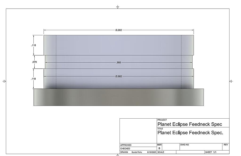

          I will report back, but Frmrspec was kind enough to shoot me over a file. Thank you sir. I will get this cut in the next day or so to confirm this fits properly. Metric dimensions make this look alot cleaner than it is.....But freedom units and stuff.

          • superman
            • 3385
            • Mount Pleasant, SC
            These dimensions work. I need to double check that .079 dimension though. As it had a bit more vertical movement than i would prefer.
