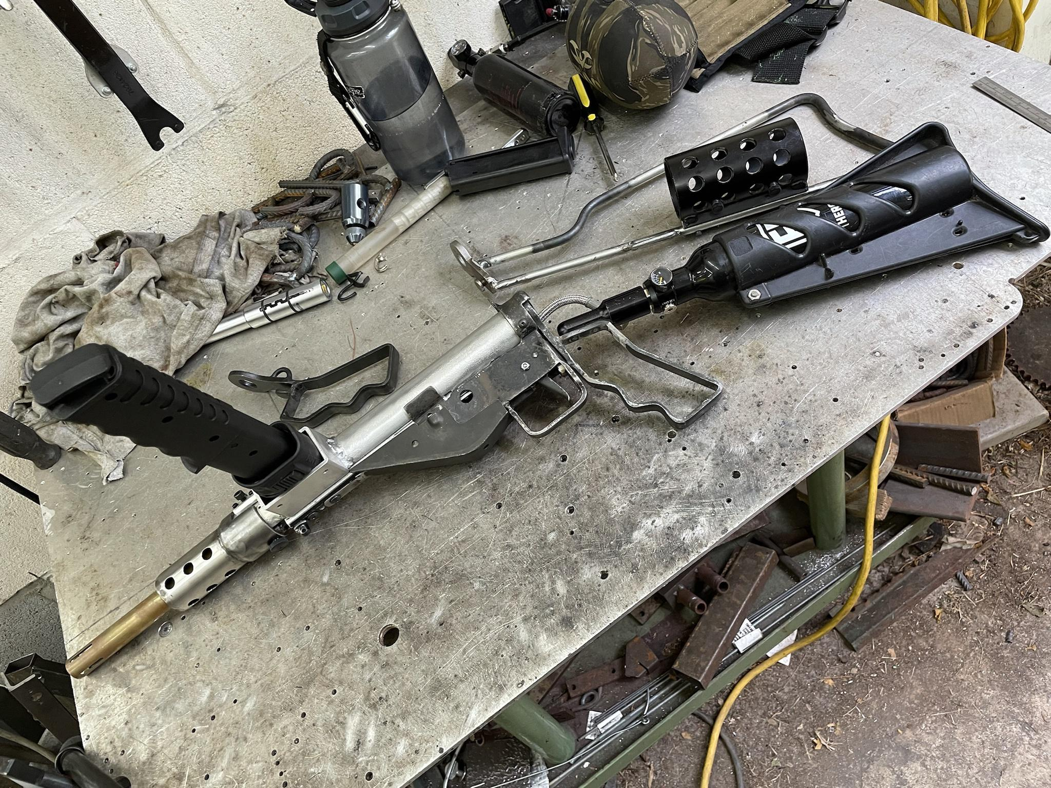

            I did a STEN similarly with an automag inside. Just go out and start putting stuff together.

              This is almost 100% exactly what I had in mind!!! Do you have any plans or information on how you cut the tube to fit the valve in and hooked it up to the trigger / “receiver” bits?
            • netsurferdude2
              netsurferdude2 commented
              There is an auto mag inside the main body tube. I bought the demilled STEN parts from a site. Welded them back together then put some time in with a torch and hammer to round them around the receiver. The front barrel shroud was fabricated out of spare tubing welded and drilled. The aluminum magazine well is aluminum soldered to the main body. Its about 90% complete. The gun shoots round ball great but keeps chopping first strikes. If you don't have metal working experience, this might not be the first build you try.

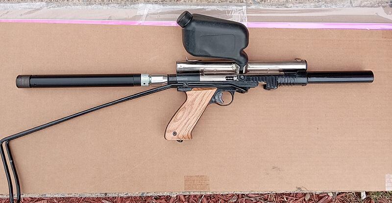

                    Just a suggestion if you are running off of a single 12g CO2, but want to get more shots. How about a 2 - 12g CO2 setup?
                    I use this CO2 setup on my Nelspot and get around 50 shots (just happens to be a 50 round hopper)
                    Airsource Dual 12 gram Changer (originally designed for Airguns)
                    JT CO2 to Paintball Adapter (adapt Airgun CO2 to Paintball)

                    • Drcemento
                      Drcemento commented
                      Holy S*#T - just when you think you've seen it all in homebrew concoctions! nice work!
                    • ThinRizzie
                      ThinRizzie commented
                      oh HELL yeah!! That thing is awesome!
                      I had this crazy idea to do a low-rent version of an AGD 6 pack so this is exactly the kind of thing I'm looking for lol
