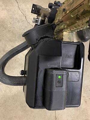

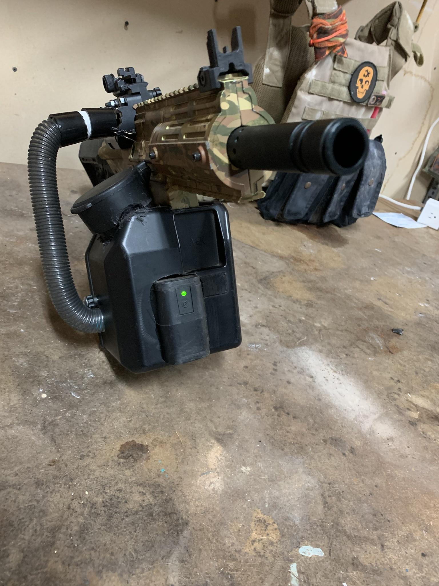

    This is my first box mag project. I’ve had a lot of great inspiration over the years from the old site.
    It shoots great even with a long hose, still need to cut that down. I’m out of air but will update the thread later with a vid.

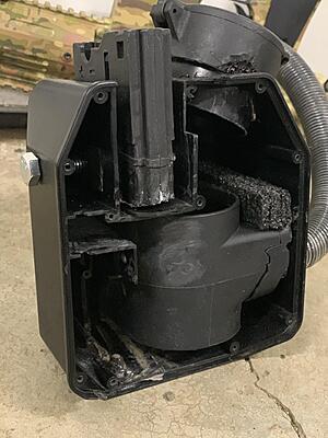

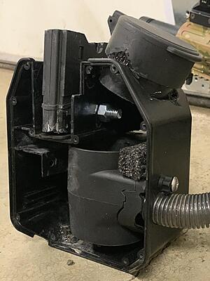

    Holds about 80 paintballs... Tac Cap loader is heat stapled into the box, super rigid. Stock Faux mag was filled with bondo, held in large bolt. All the hardware is original BT brand garbage, like it stepped out of a time machine. Rip-clip is secured with stock screw, fully enclosed once the back plate is put back on.

      Great build! What kind of hose is that? I've been working on a thing but I can't seem to find the right kind at the hardware stores.

        Thanks man, yeh the hose, I’m not a 100% sure but I think I bought it off AGDs website awhile back. It’s really good stuff.

          It looks like Qloader or warp feed hose, I'm guessing Warp feed since you got it from AGD's website.

              Does a rip clip do a good enough job of holding ball stack in place , and not letting paintballs fall back down?

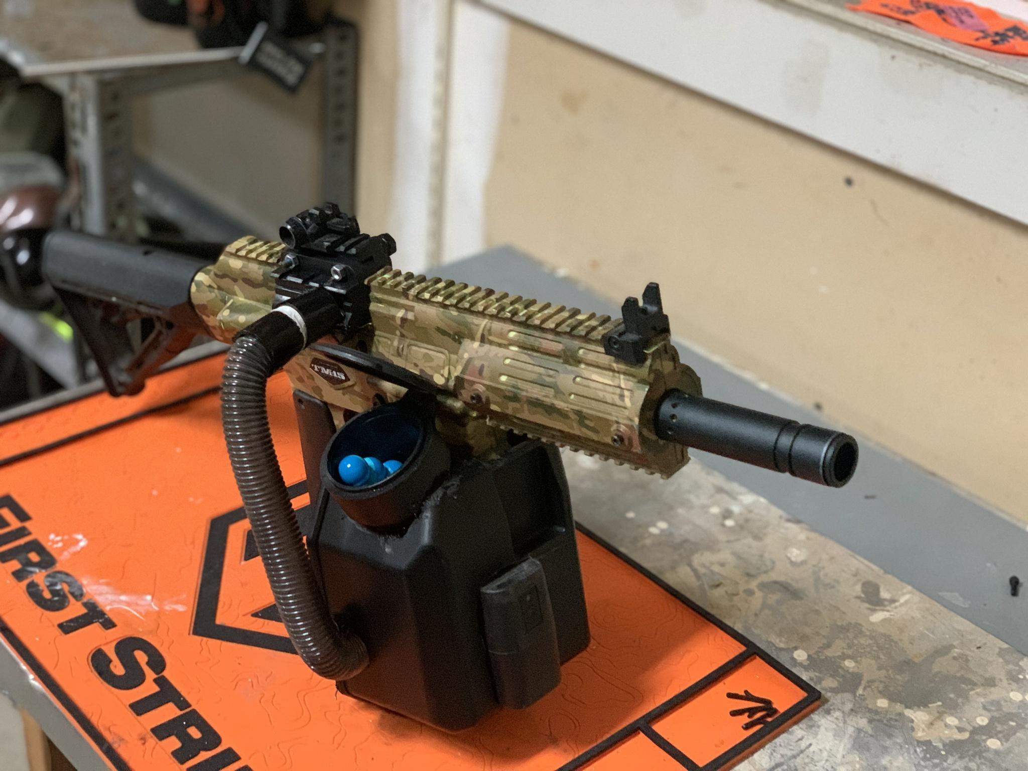

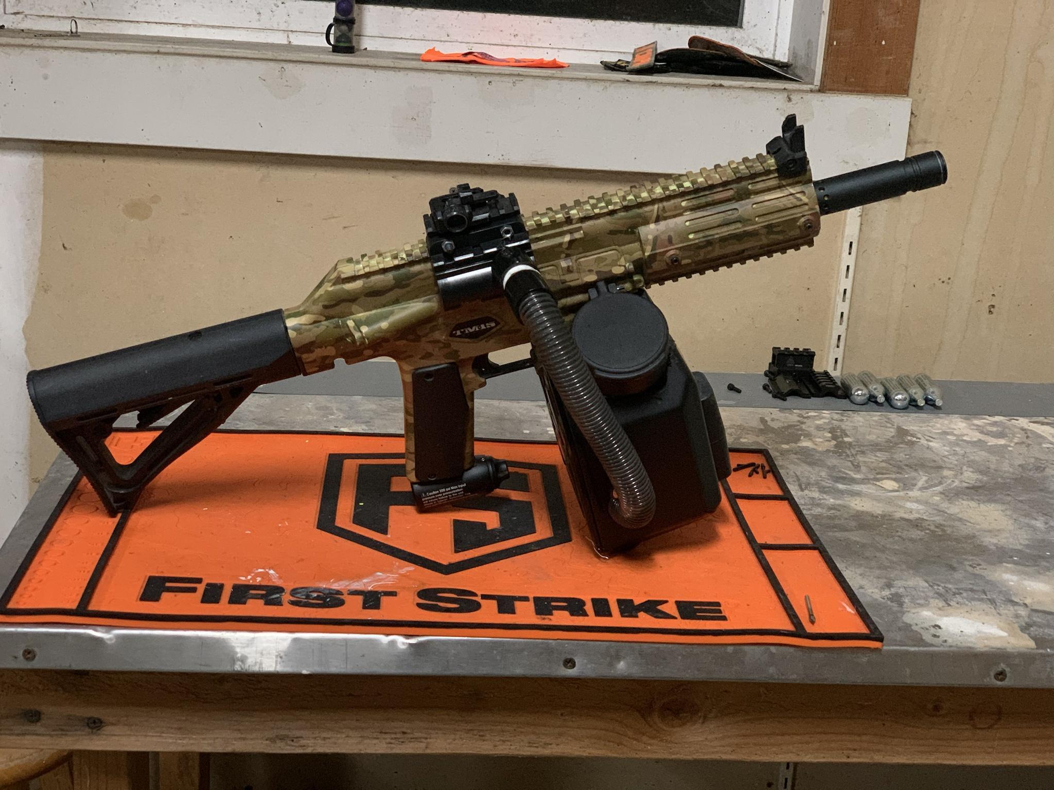

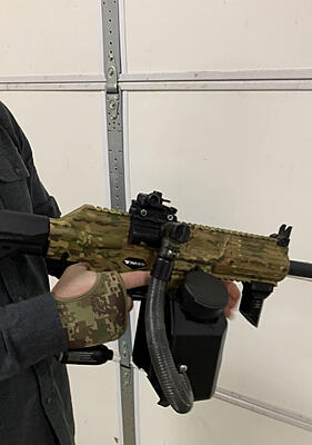

                Been awhile, thanks for the question here Meleager7 . I did have to cut the hose down and do some more tweaking to get this to work. Now it feeds flawlessly. It does struggle with the last 20-25 rds but if I turn it sideways or slightly canted it finishes off the stack real nice.
                Not sure if I mentioned this but I freak xl bored the stock barrel too. Shoots darts.
                Updated pics
