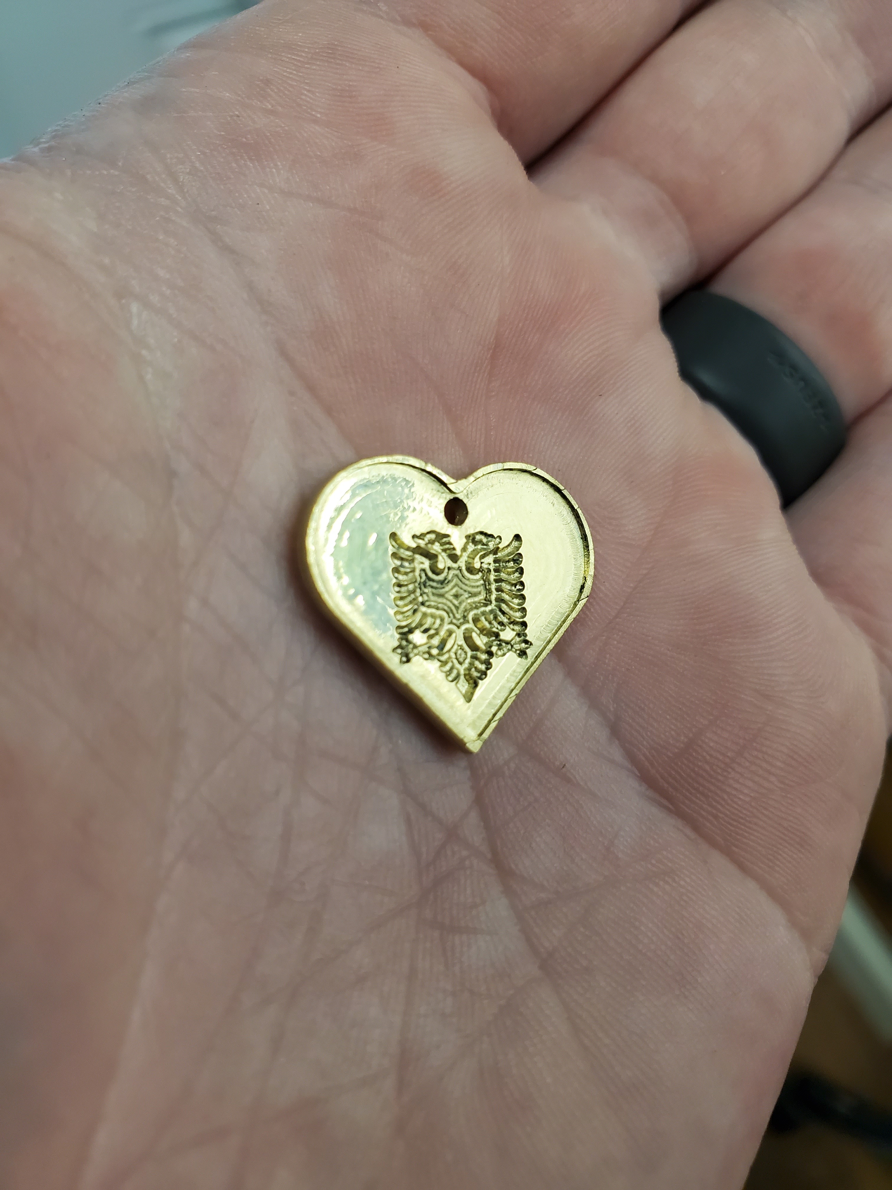

      I know this because I've been running a Nomad 3 this year (150 watts, 24krpm). It's very capable if you understand the limitations. The Nomad is less expensive, very rebuildable, has excellent support, and runs GRBL (limitations but the most common interface), so it's a low risk alternative. But tool changes eat up a lot of time if you're not sitting there waiting for them. I've done everything from prototype cuts and threadmilling valves (1/4-36 anyone?) to jewelry for my daughter.

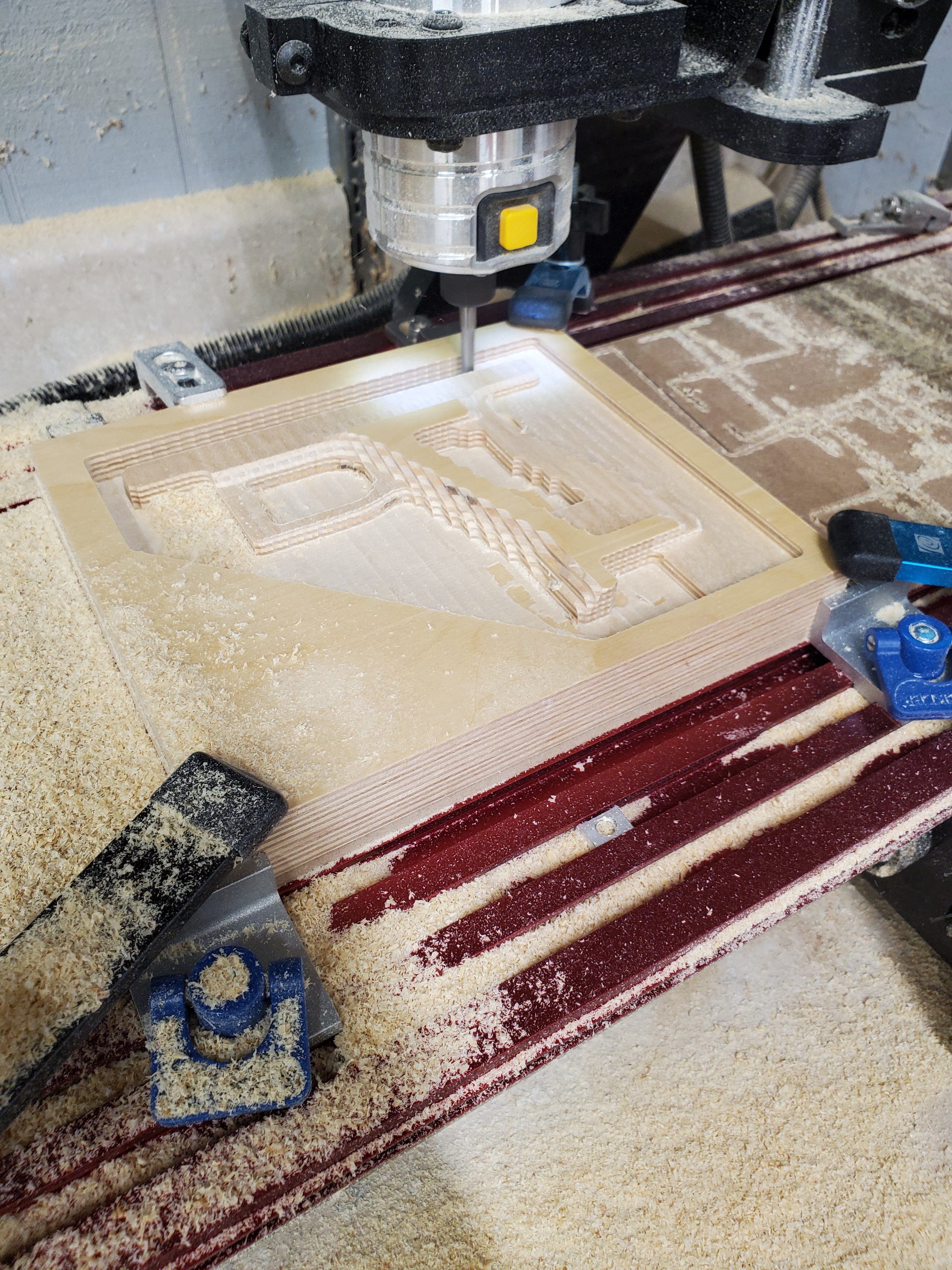

      I also have a Shark SD120 (garage sale find!) that is infinitely more useful for wood and plastics just because I can cut 10x as fast with a Dewalt 611 router on it. Good for testing fit/ form. (Pix attached)
