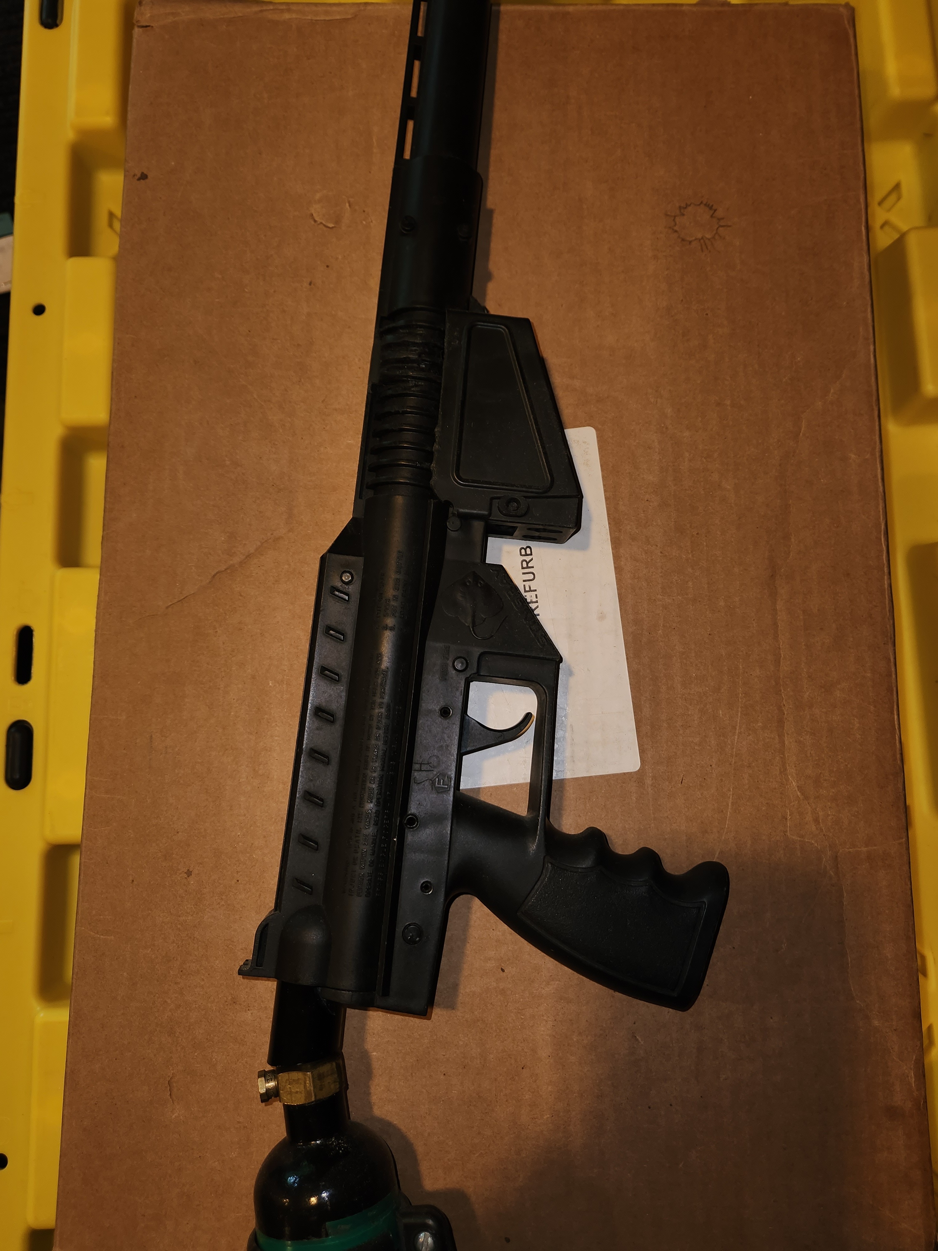

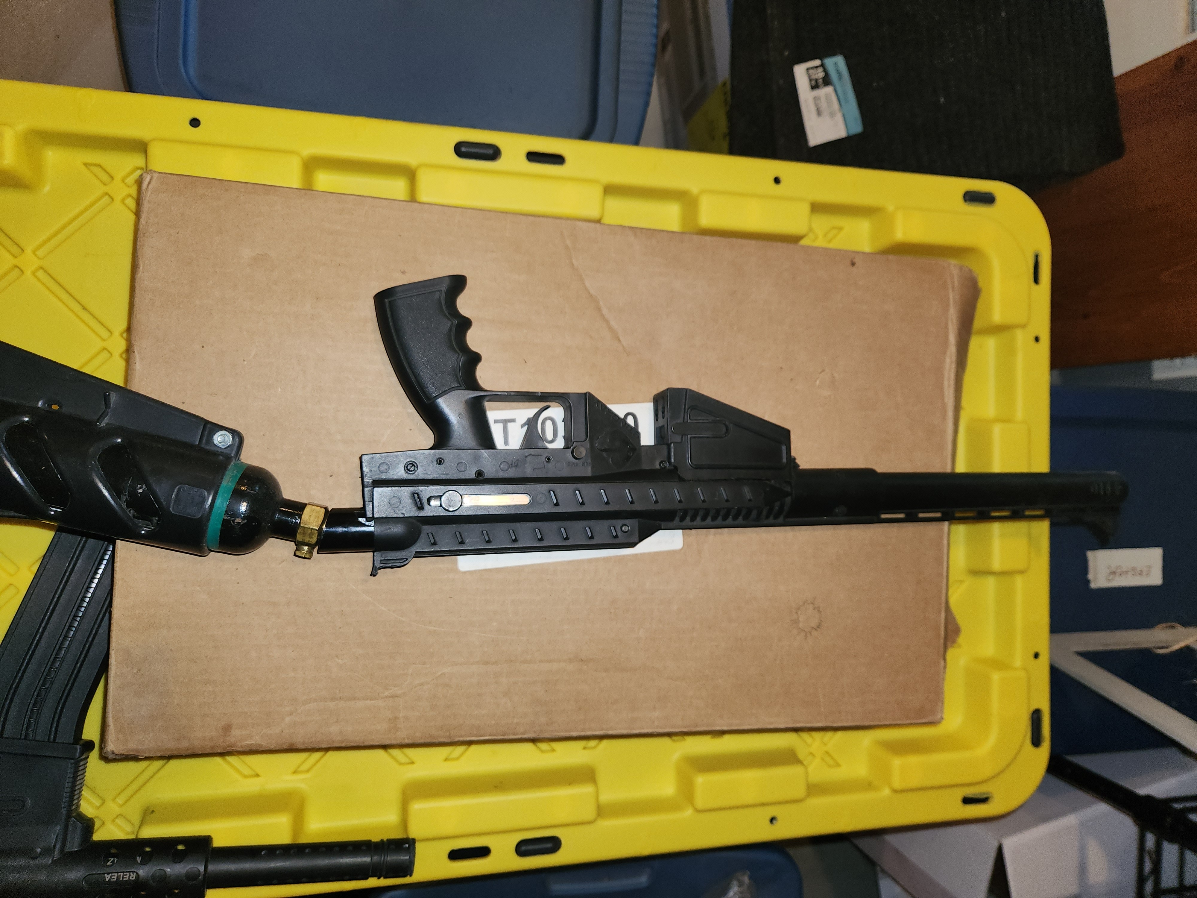

      Not sure if velocity and range change drastically with the longer barrel using HPA. Longer barrels are most effective with siphon tank CO2 systems. The liquid has a longer time to expand, increasing the gas pressure pushing the ball. As for mag fed, there are several people here who have created mag fed Stingrays. Check previous posts in the BE section or the Custom Build section. To get you started, here is mine. Gen 1 Stingray 1410. RAP 4 T68 Gen 1 round collar mag well and 20 round, round collar, magazines

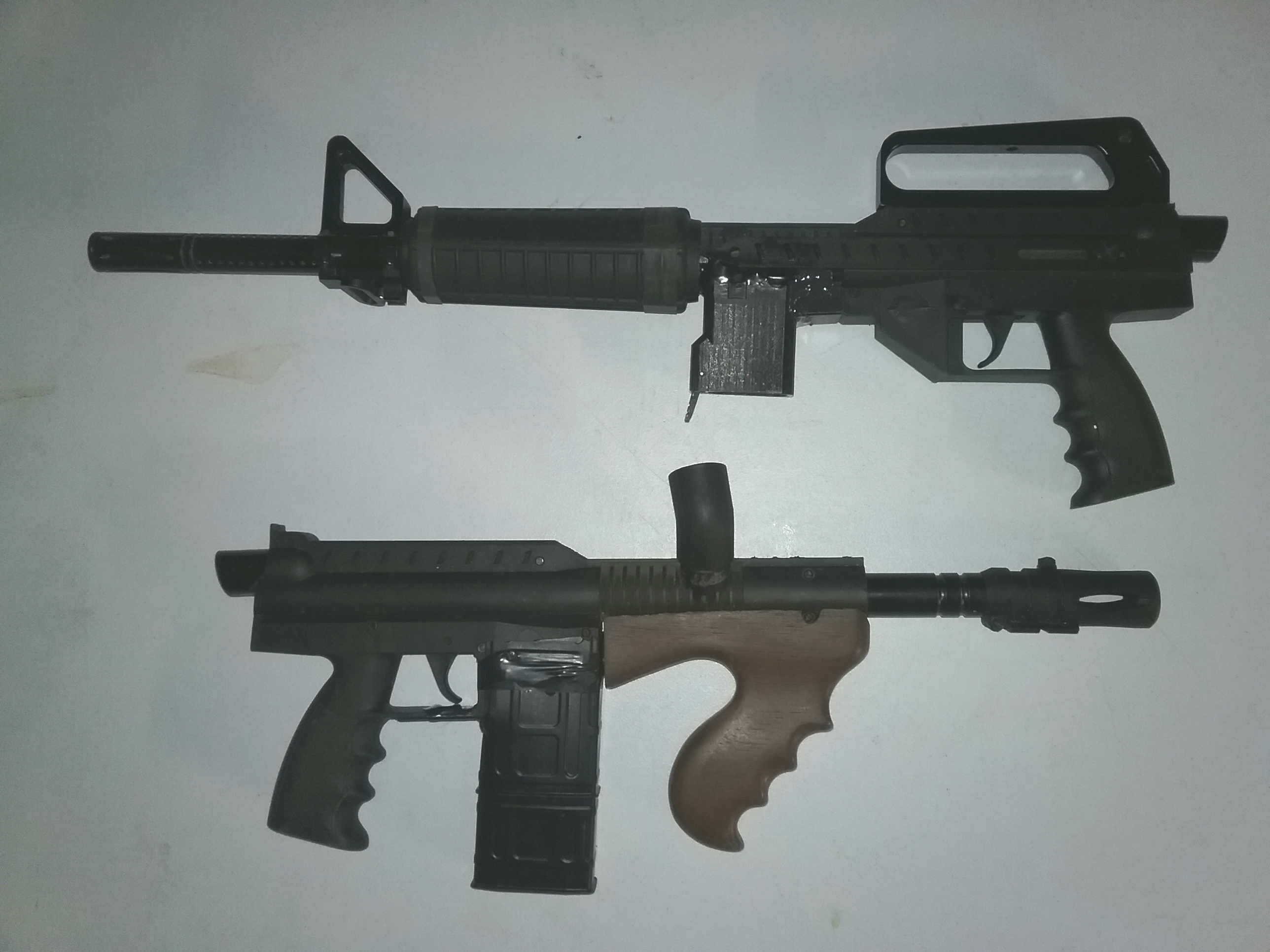

      Here are 2 of mine. The top one is modified for Tippmann magazines and it has a long barrel.
      The bottom one is my Tommy gun. It shoots great and I love using it. It gets people out! The foregrip is from a Thompson and it is not Magfed. It just didn't look right so I just taped a Dmag shell on for fun.
      These two work very well on 800 psi boosted tanks and lots of oil.
