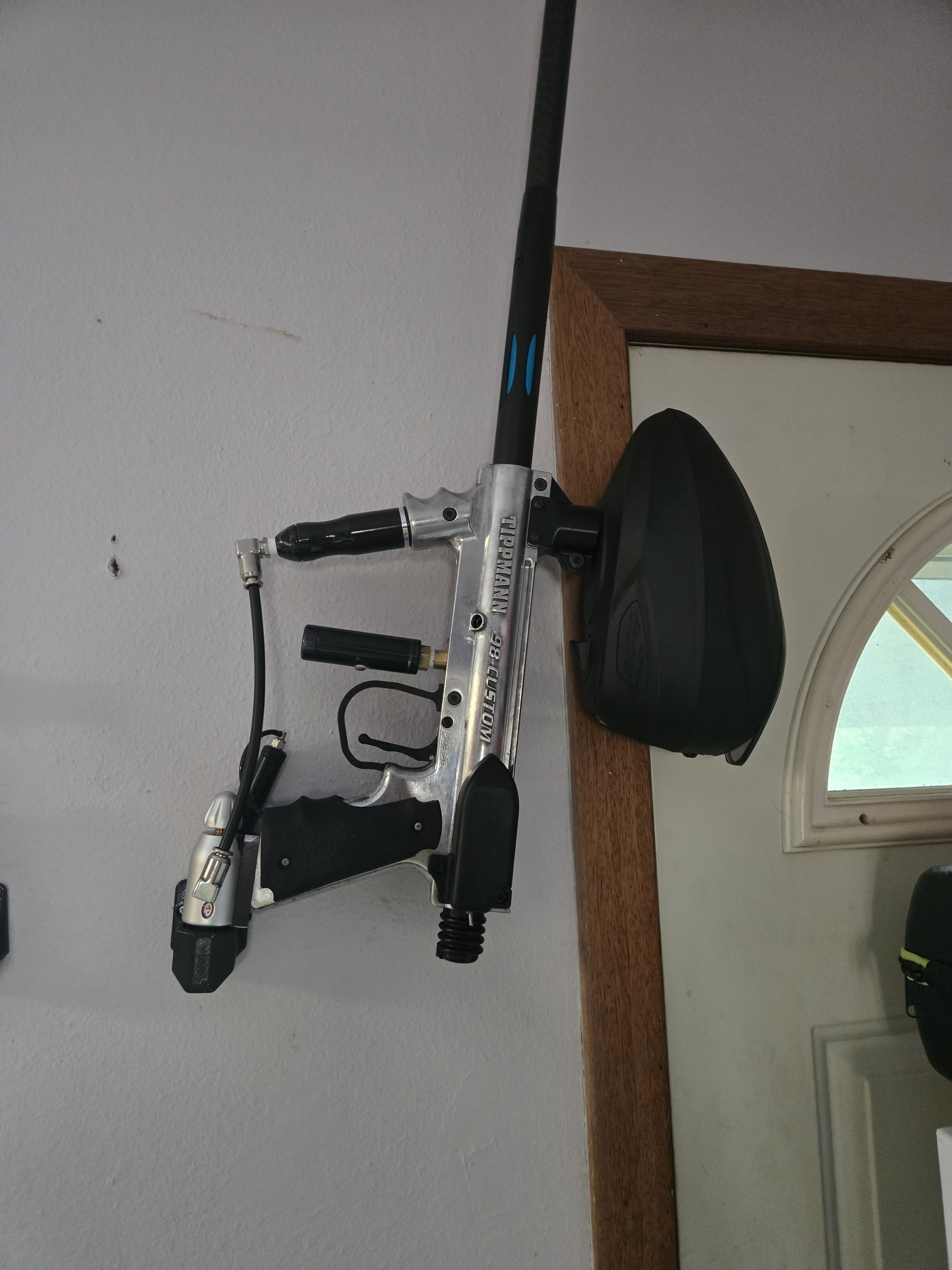

      Ok, more work, when I removed all the masking I found that the masking tape took a few bits of the color with it. It's not much and it's not like I have an option to do it again but I suspect this wouldn't happen if I had more time when painting.
      Other than that the clear coat went well
      Time for more polishing! Is it metal? Yes, does it move? Yes? Then it gets polished! Linkage arm, sear, all the area the trigger and springs are in, hammer. Front site? Sure why not. Aluminum bolt? Hell yes.
      That all out of the way and the overspray taken care of I went about installing. Decided to go RT on this build and also use a gas through for grip. Tippmann however, apparently doesn't know the dimensions of their own markers because this gas through assembly just world not fit. This is actually the second one IN A ROW I've had to deal with that wouldn't just drop in. I had to take the flex shaft and do some "clearance mining" inside the body to make room where it needed to be
      So, right now it's all together and shooting but ..... Shooting at 210 maxed out.
