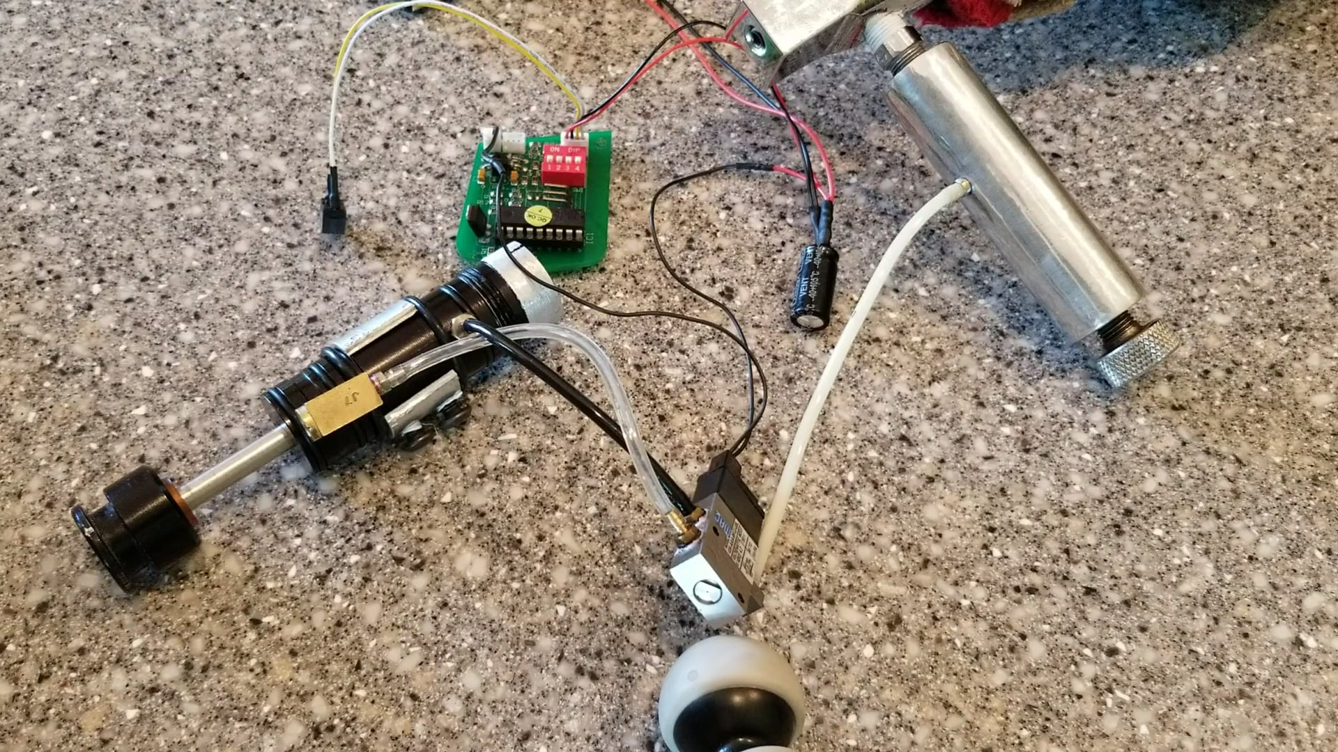

    I removed a bunch of material from the inside of both receiver halves to I could fit my board and solenoid and QEVs/barbs. I had several 2 way solenoids laying around and considered using an intimidator noid, but the cyclic rate of a humphrey noid is about 23 bps and the physical dimensions of the noid make it a tight fit. Used a mac 43 noid instead. The mac noid is the 4.7 watt variant and draws a massive amount of current. Most boards will simply shut off when they try to fire it. Only boards I know of that will run it are 07 ego boards and 05/06 ego tadao boards and some others. I used a 16v 2200uF capacitor to store energy for the solenoid. I have a good supply of dm4/5/c boards kicking around and was going to use that to drive the solenoid. I used a scenario dreams DMT chip. Here's the first testing of the board, solenoid, capacitor driving the ram. I used a QEV on the forward stroke of the ram to help move air from in front of the ram faster so it would have more energy going forward, thus striking the valve with more force and allowing a lower operating pressure than if using a barb. Using an old palmers rock LPR to feed the noid.
    https://vimeo.com/347908617
