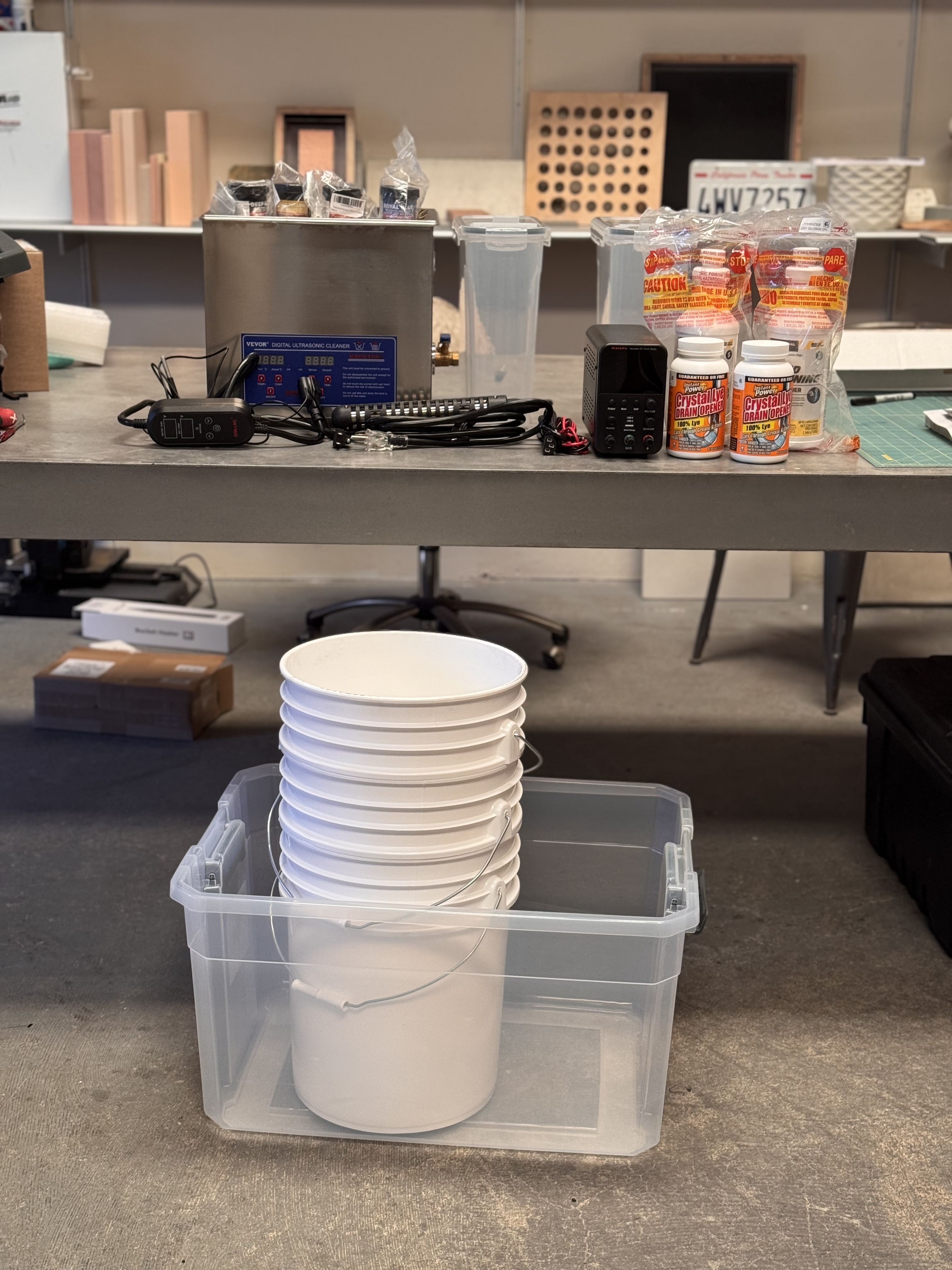

                    getting closer. waiting on de-smutter and nickel acetate from caswell..... and some more buckets..................and some nail polish.............and and and and I think I can start doing some tests!

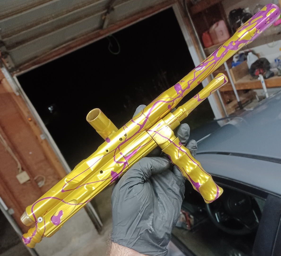

                    Been messing about. Ruined a handful of cheap guns. Always getting closer tho. Heres the best one ive done yet
                    My question is about stripping the anno from silver guns. How do you know when the anno is gone? The biggest problem ive run into is eating away the metal by leaving it in acid too long. With colored guns, you can see the color leaving... but silver anno???
                      Looks great! Once you find a time to strip a colored part in your certain lye concentration (30 mins for example.) Use that same amount of time for your silver / clear part. Another option its to check resistance with a multi meter. Once it becomes conductive, the oxide layer is gone. You can also tell by the color of the metal but that takes a trained eye that comes with time.
