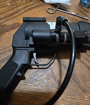

    Metadyne Havoc Regulator Delete
    Anyone ever done so?
    Have a Havoc gen 2 with an extremely temperamental regulator.
    The simplest route would be JBwelding the adjustment hole, bottom relief hole, and rear relief hole, and adding a Palmers or similar 1/8 to 1/8 Regulator.
    The expensive route is send the body to a machinist and have them plug/weld the bottom relief, tap the back relief and plug it, and make a holeless front plug that threads in.
    Suggestions or tips?

      Didn't get any photos of the process. I went the quick and dirty route. JB weld in the reg chamber and outside to seal the pressure relief holes, and some in the adjustment cap and rear relief hole. Then it was as simple as plumbing in an ASA and reg. Can run like this as a stand alone. Or I have an female ASA to male ASA regulator I can put in between the tank and reg and cut out the Messiah reg.
