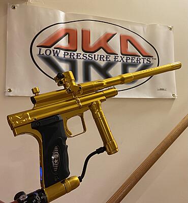

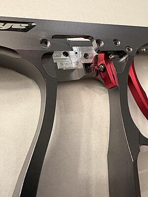

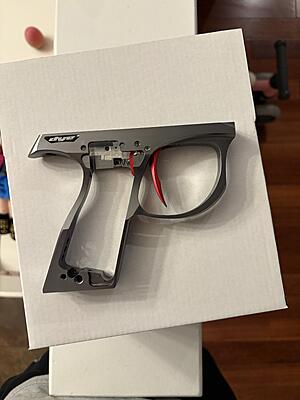

      I've owned 4 ehms and built two of them. They aren't that hard to finish off. Jared at AKA still sells 04 Viking ram cartridges and bolts if you reach out to him directly, he has the solenoids and lprs listed on the aka site. I've had a Macdev clone vx frame and a Proto PMR Ultralite frame milled to work on the ehm but both required a tray to give a bit more clearance from the solenoid. I actually have said UL frame available for sale since I found a stupid rare frame to finish off my last ehm.

        Yes, I had the macdev tray made while my body was milled. It would be easy enough to make out of 1/4” flat stock and a drill press

        No. The one I owned but didn’t built used an FEP quest frame with no tray and my current build used an Elia frame with no tray. The UL frame can be done without a tray but you have to cut through the back of the frame so the noid can protrude. PBN has a couple good threads about it and I believe its titled “stacked tube viking”

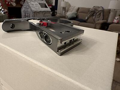

                I guess I’ll post my milled UL frame in here there seem to be a few of you looking to build an ehm.

                A couple of years ago I had a coworker machine a batch of Ehm bodies and single trigger frames that allowed for no tray. I do take them out to the field to get some play time, they’re smooth shooters.
                This old thread may be of some help https://www.mcarterbrown.com/forum/c...4-aka-evil-ehm

                Machined by BMC but would still need a tray and probably a morlock or sci fi universal board because the noid wont clear the dye board.
                The front mounting hole also needs drilled.
