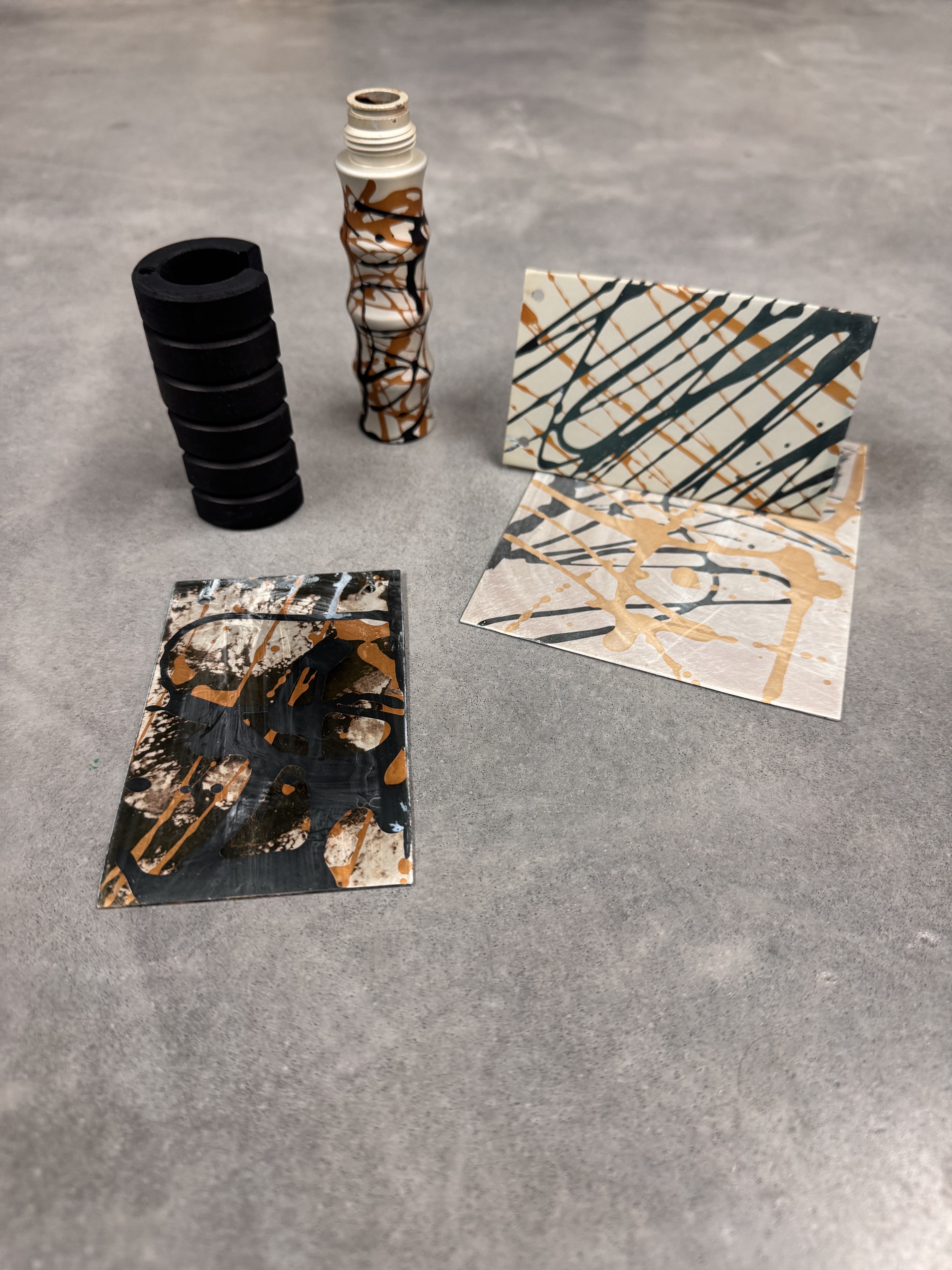

        As Ice T once said "today was a good day" it all came together and each cycle got better. lots was learned and a few odds and ends ordered. so frickin' fun.

          KMDPB commented
          Very nice!
        • sonixr7
          sonixr7 commented
          Wow! Great to see potentially new alternatives adding to the paintball community.
